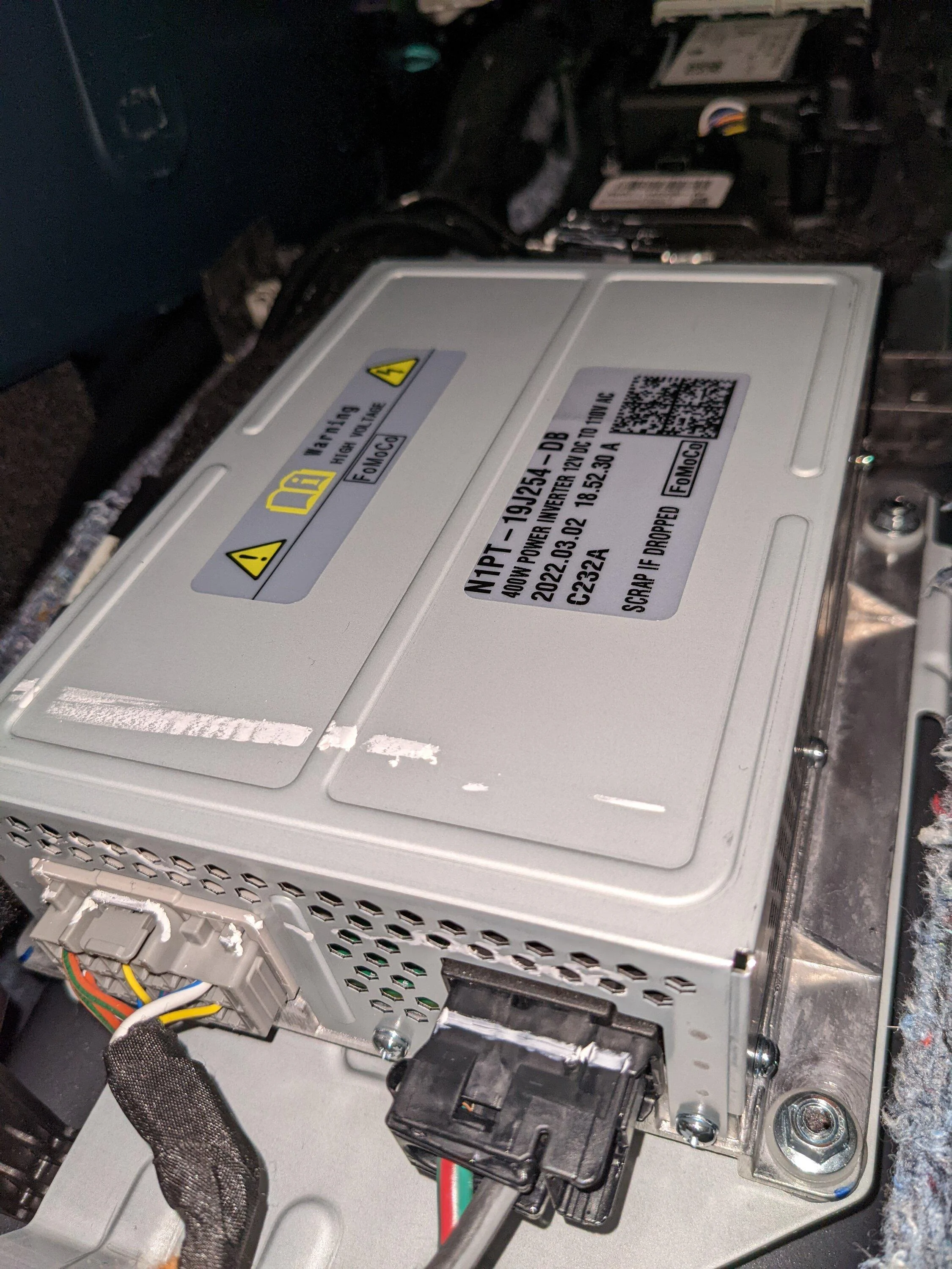

Yes we do. Here is a picture of it under the armrest middle console in my hybrid xlt.
Label that says ""SCRAP IF DROPPED" Instills confidence in ordering one online with USPS, FEDEX, UPS, AMAZON OR ANY OTHER CARRIER! delivery!😂
