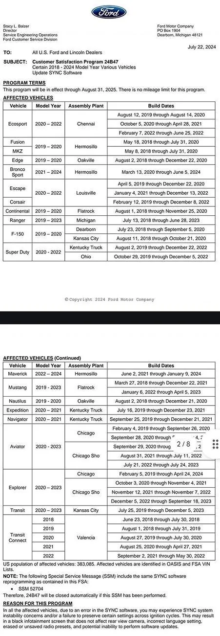

I received a call from the dealership to schedule this fix for tomorrow in my driveway. Didn't even know about it until then. Weirdly, I found most of the below on a lot of sister sites to MTC.
Customer Satisfaction Program (CSP) 24B47 announced 7/22/2024 to update the APIM at no cost to the owner. Also known as SSM 52704.
This is NOT an Over The Air update.
The CSP lists all of the impacted vehicles including ALL Lariat Mavericks built before January 2024. The US population of all of the affected vehicles is 383,085.
Ford is aware of the issues owners are having with Sync:
Have you have experienced any issues with your center display? If so this CSP may solve the issues. Issues include:
1. Display intermittently blacks out.
Description: In all the affected vehicles, due to an error in the SYNC software, you may experience SYNC system instability concerns and/or a failure to preserve certain settings across ignition cycles. This may result in a black infotainment screen that does not affect rear view camera, incorrect language setting, erased or unsaved radio presets, and potential inability to perform software updates.
This update takes roughly 30 minutes, but expect a couple hours as this is a software update. I think it’s a configuration change to the APIM (software only update).
Ford Maverick Customer Satisfaction Program (CSP) 24B47 IMG_6601
