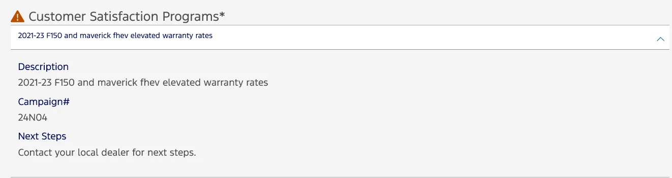

Just happened to check the recall by VIN page for my Maverick and saw this new program listed. Strange, all it says is to contact a dealership with no info.
Ford Maverick New Customer Satisfaction Program (24N04) For Mavericks and F-150s? Screenshot 2024-05-28 at 18-28-46 Ford Recalls Ford Owner Support

"N" programs are extended warranty programs on a specific part (often for a specific failure). That looks to be one that hasn't actually been released yet. I work @ a dealership....I searched all FSAs and nothing came up under that number.
So it may have been activated in some parts of Ford's system, but hasn't been announced to dealers yet.

And I did search for both 24N01 in the title, and 24N04 in the screenshot you uploaded. I can't find info on their of those in Ford's system (at least the part that dealerships have access to).

Sorry that was an error, the correct number was the one in the screen shot. Thanks for the information in your posts. 😀

This program is for Canada only. I got the letter not long after posting this.
From Ford Canada recall page:
Customer Satisfaction Programs*
Description
Replacement of exhaust gas heat recovery system if failed
Campaign#
24N04
Next Steps
Contact your local dealer for next steps.

If for Canada only, why would it show up under my Cust Sat program page?

Maybe Ford is just starting to add it to US VINs, but hasn't sent letters yet?
I'm going to ask about it when I go to the dealer on Monday.
