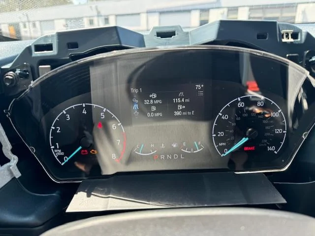

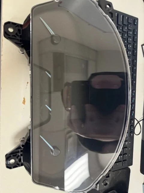

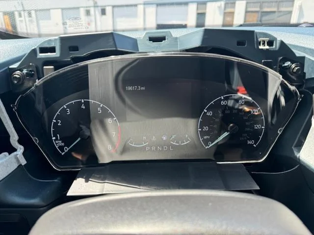

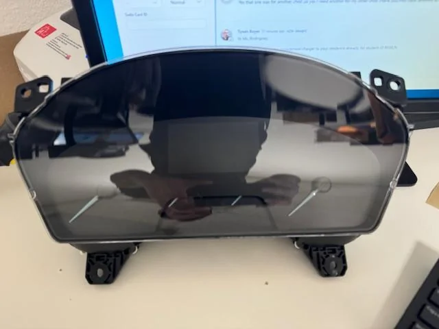

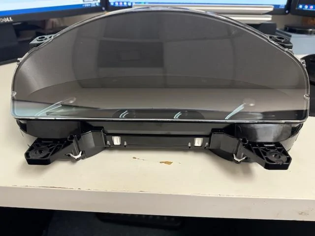

Hey everyone..
Spent a lil bit of time on this today with Meguiar's PlastX. A few notes to know about if you'd like to try this -
1. Use SMALL... and I mean small... like the size of a pea - dabs of this in small sections of the cluster as you move along it.
2. Use brand new, clean microfibers. It does not matter what kind they are as long as they are relatively soft and you will not get the fine scratches out anyways - in fact, you'll probably cause more than you had before.
3. Work in circular motions, then go back over it with straight up and down. As mentioned before, the goal here on my end was to get rid of the etching, not necessarily reducing scratches, etc. Someone more versed in detailing will need to chime in on that method here
4. You want the product to basically end up "almost" clear before wiping it off. The more "white" you see, the more haze will be left over
I am not perfect at this, but I think I got this to an acceptable level of cleanup before @Ford Motor Company responds with a good reason that the new cluster lenses are only available for purchase on Lariat models. I think I speak for all of us - we'd like to be able to get these regardless... They are very, VERY soft plastic and replacements are relatively simple... if they were available.
Before picture(s) are in the original post, here are some afters.
Ford Maverick 2024 XLT - Cluster Lens Etched IMG_0587
Ford Maverick 2024 XLT - Cluster Lens Etched IMG_0588
Ford Maverick 2024 XLT - Cluster Lens Etched IMG_0589
Ford Maverick 2024 XLT - Cluster Lens Etched IMG_0590
Ford Maverick 2024 XLT - Cluster Lens Etched IMG_0591
