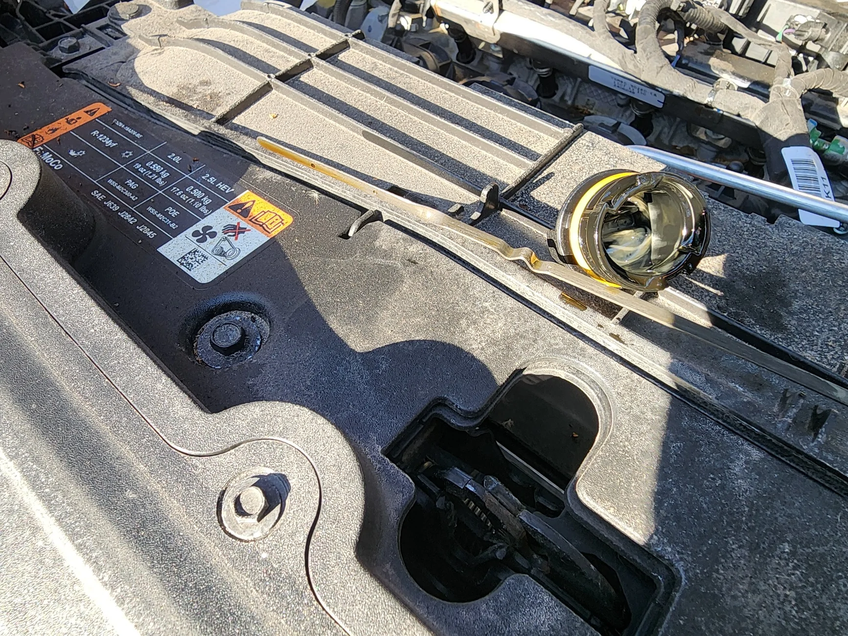

Okay. I checked my cap and there's a little bit of white emulsion on it. Checked the oil (changed in November) and it looks great. Coolant looks great. So I'm going to keep my eye on it as I've done a lot of short trips this winter. Sorry it took so long , I was in the middle of working on my motorcycle and one of my canoes.

There is no ‘service’ for a blown head gasket.
It will get worse fast now. Continued use will put extreme wear on all the internal engine components.
No.
Stop the false information.
You don't even have one.
Normal and Harmless for this engine.
Shows up in cold / cooler climates with short trips.

I need to start popping the oil fill cap off during fillups when I check the oil dipstick.
Or in this case, even at the 20k inspection that occurred about 300 miles before the oil/filter change.
At which time I had to refill the engine coolant tank from mid-level. Which was mid-level again by the oil/filter change. Hmmm.
Never had anything show up on the dipstick.
Nothing in the old oil showed a thing.
Went thru last years winter and the oil change didn't have this in Apr.
But service writer said - nah, normal condensation, he's seen it on his F250.
Really?
Guess I'll have to wait until coolant drops more, and this shows up again - to get their attention.
I've never had this in a vehicle, and many oil/filter changes ended up being the same time of year for the same potential.
It's normal and harmless for this engine.
Pretty much everyone's (hybrid) does this in colder times with short trips.
Just 99% of people never look.
No worries.

3,741
7,016
Common issue. Water will condense at the coldest point, which would be the oil cap. If you see the same on the dipstick or during an oil drain/change, THEN you have problems.
At 14,200 miles my oil cap does NOT have any signs of water or antifreeze. Also has never shown any signs of condensation.
I look because I’m an oil sniffer, always looking for signs of leaks.
Never in my life has there been any reason for the milkshake in any car I ever owned other than a blown head gasket.
