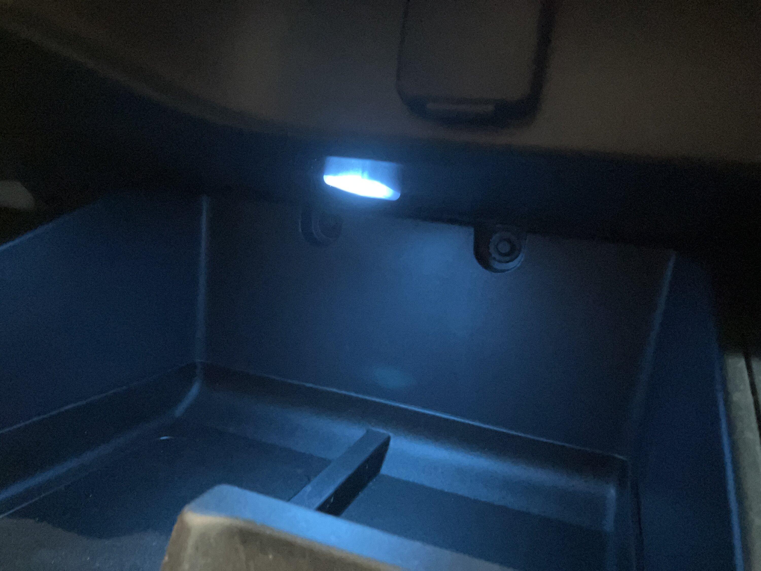

Can anyone with the light take a picture of your layout? I'd like to try and get the part numbers from both the bulb and the console.
When you get a chance can you pull out the console and snap a picture? It doesn't require any tools, pulls straight out.
I have a 22 xlt hybrid and I have ambient lighting.

@Executech how did you get the panel to come down? I tried just sliding it forward like the OP suggested but had no luck. Are there some clips or screws holding it in place?

I haven't seen this posted, but compared to the 2022, my 2023 does not have the bulb for the center console or the icon in the screen for ambientCan anyone with the light take a picture of your layout? I'd like to try and get the part numbers from both the bulb and the console.
The best way I can explain it is I pulled at an angle between down and toward myself. The brackets appear to be angled.

Ok this is bugging me, how do you all get that plastic tray loose? I have tried and it seem really stuck in place. Are the two bolts under it important. Do you yank straight down or something?
Thanks! I'll try again using your suggestion and see if I can get it to loosen up.

Looks like part number is the same, they just updated the "d" to an "e." Also, my part is 3 months newer. I will have to wait until Monday to see what the parts department says.
Did you happen to notice a part number on the light itself?
Also, since there isn't a setting in the infotainment, I wonder if there is an option to enable it in Forscan...hmm.
Right thumb in the cigarette lighter, left thumb along the usb port, pretend you're going to strangle it and pull towards the shift dial. There are 4 clips that hold it in. No screws.
Nope, even imagined my older sister in middle school mode of evil to get enough rage to strangle it hard! No deal.
😂 Use a plastic pry tool then. Start with one side (driver or passenger) and go from there.
