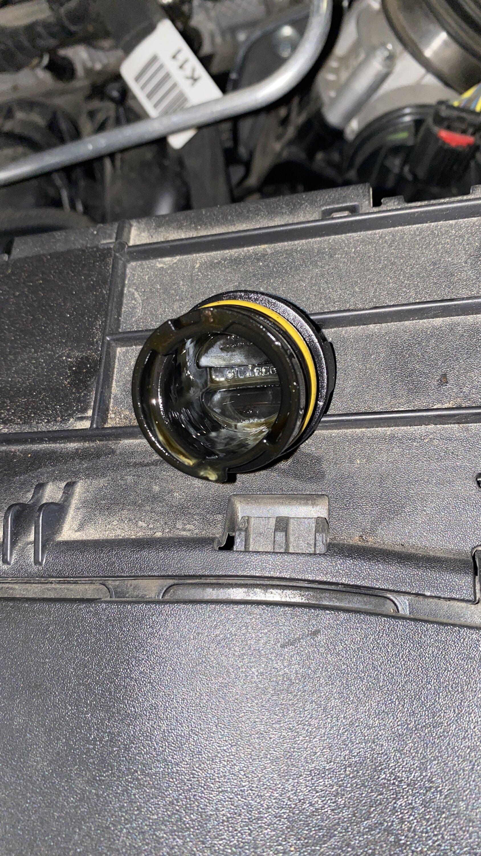

Ford Maverick 2023 Hybrid Oil Change Pudding Surprise! IMG_8947

I have a 35 - 45 min drive each direction. San Francisco Bay area. Mild. Cool. But mild. 40's to 80's usually.
My hybrid in the city won't get past 155°F in summer. Sometimes not past 140°F in winter.
I just checked my cap. Not full, but there is a trace amount. Less than 2000 miles since oil change.
Yeah. That seems like it wouldn't be hot enough. Need to check my actual temps. I have about 8 minutes in a stretch on the interstate.

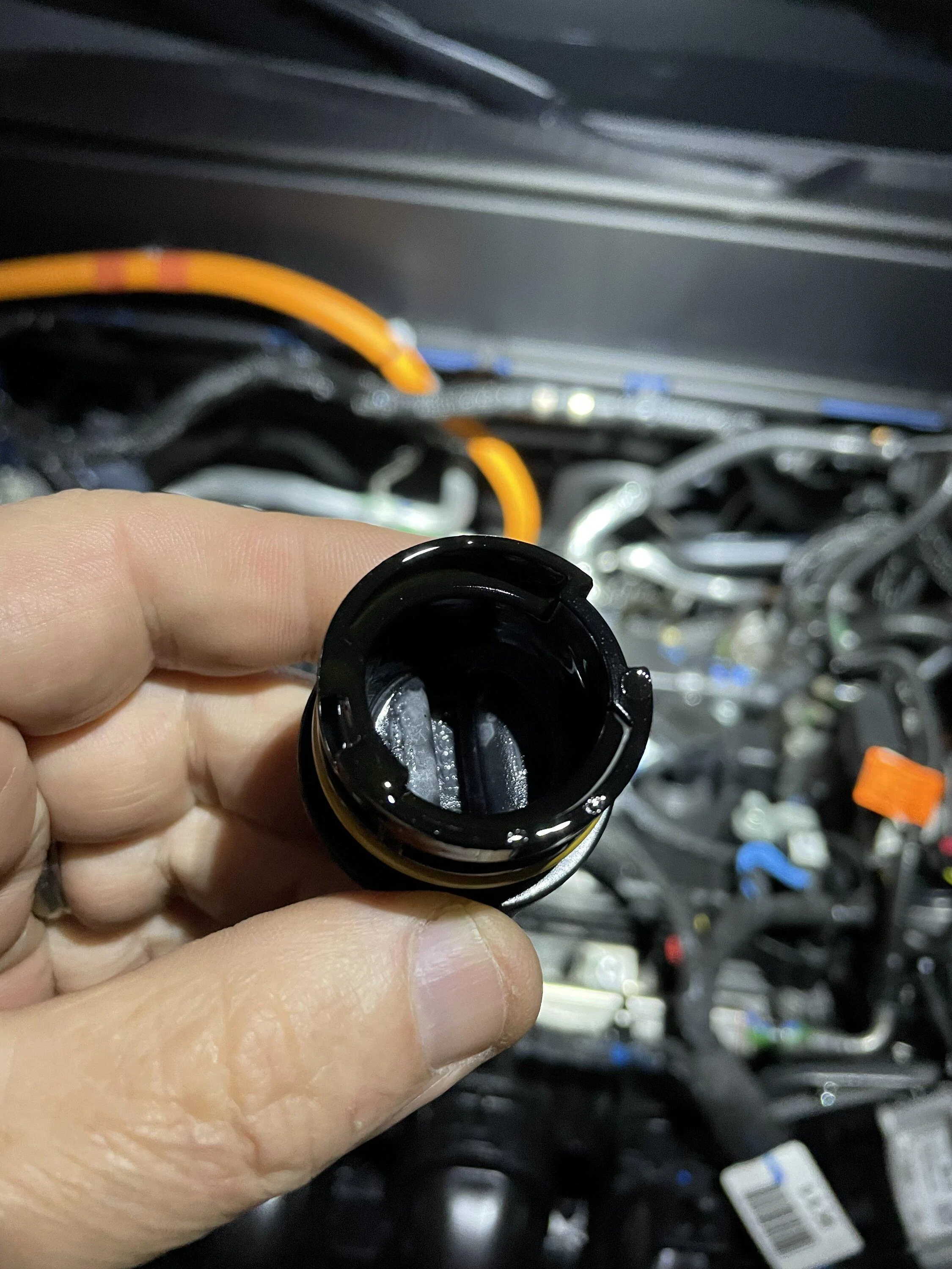

Ford Maverick 2023 Hybrid Oil Change Pudding Surprise! IMG_5457
With only 200 miles I can see condensation beginning inside my cap . Wiped it off and check it again sometime

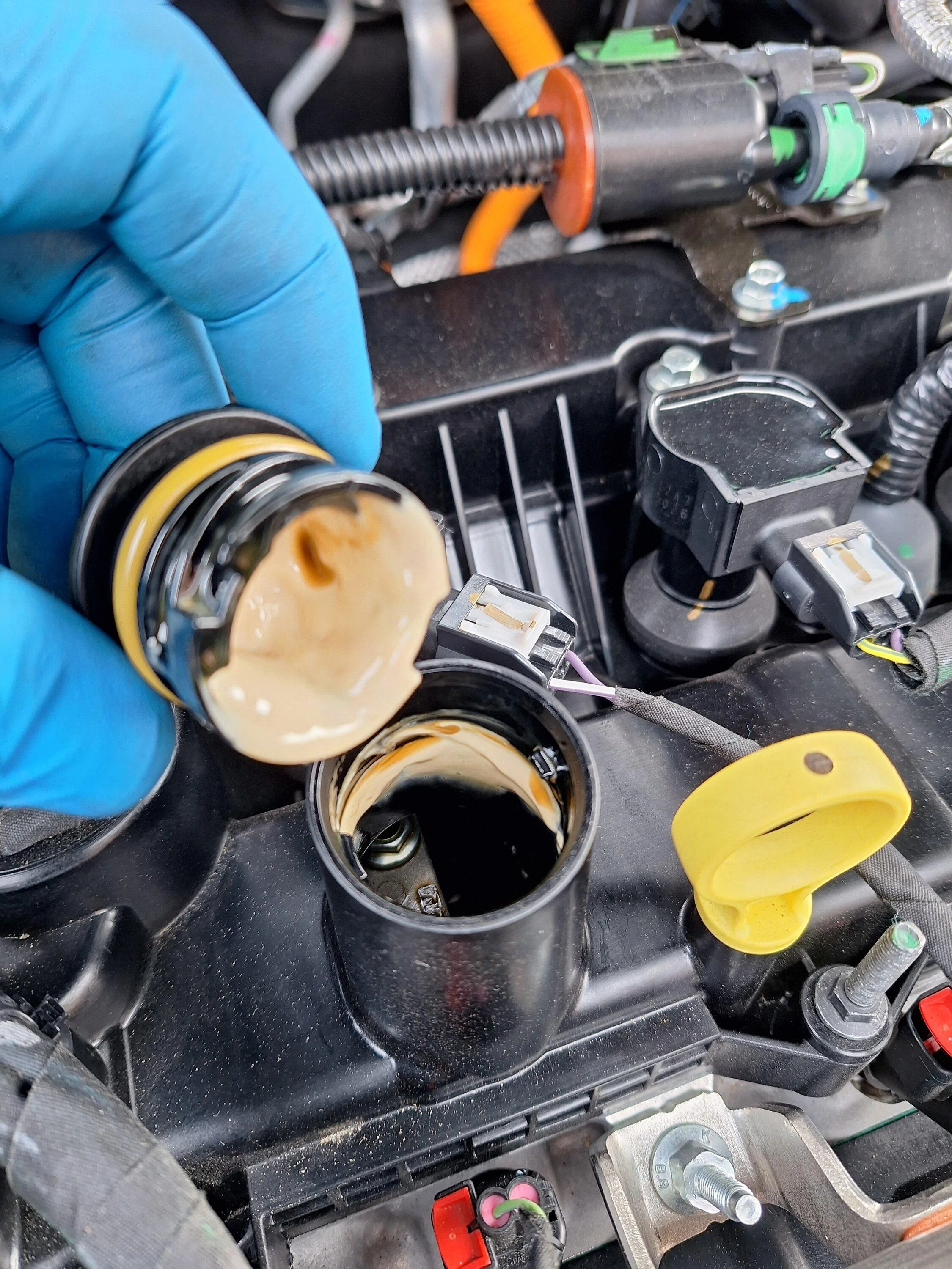

Changed my oil at just under 3k on Saturday for the first time, and also had some mayonnaise or pudding looking deposits under the cap, as well as some in the up-tube. It's been cool here, and I rarely have more than 2 bars on the temp gauge.
Looks like a change before super cold weather, and one early spring will be in my routine, and/or I need to take a weekly drive long enough to heat up the engine sufficiently enough to burn it off.
