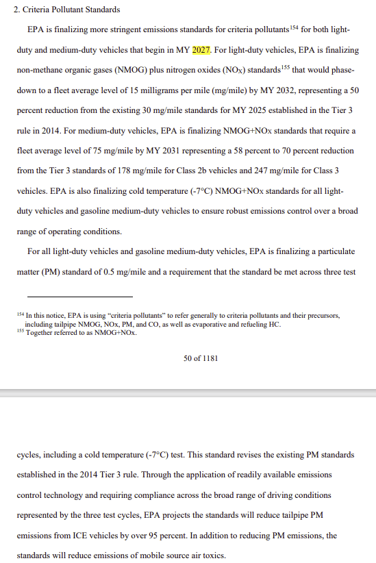

The new EPA 0.5 mg/mile PM rule is for the 2027 and beyond period. Whatever GPF they put on the '25 Mav EB doesn't need to meet that standard. Maybe it does, maybe it doesn't I don't know.
Only a couple of possibilities in my thinking:
1. The '25 Mav GPF actually does meet the new 2027 EPA standard. I'm very skeptical, but hey who knows?
2. The 'new' 2.0 EB engine everyone seems convinced will be a combo MPFI/GDI for some reason doesn't even meet the current 2014 EPA Tier 3 standards (for NMOG+NOX and/or PM). I'd bet serious $ that's not the case ('25 Mav PM and NMOG+NOX should be improved over '24 Mav EB if they added MPFI to the '25). Tier 3 Motor Vehicle Emission and Fuel Standards (Final Rule) (theicct.org)
3. '25 Mav EB owners will effectively be USA GPF beta testers for Ford. Dunno, doubt this but...
4. All MY2025 Ford ICE engines will have GPF because........? Seriously doubt this too.

I too did a little looking into this. Generally agree that Euro/Aussie vehicles comparing pre/post GPF didn't lose fuel economy or much HP. Current Euro 6 emissions spec (and upcoming Euro 7) look to have the same PM (particulate mass) and PN (particulate number) requirements - except - the big change in Euro 7 is requiring PN covering particles less than 10 nm (nanometers) vs 23 nm in Euro 6 (smaller ultrafines do more lung damage).
The Euro specs and EPA specs regarding PM are an apples-to-oranges comparison, can't directly correlate them. Euro 6/7 use PM and PN. Current (now) EPA Tier 3 regs (from 2014) call for PM 3 mg/miles (for the FTP dyno test) and 10 mg/mile (for the US06 dyno test). The new EPA regs (2027 onward) call for PM 0.5 mg/mile or less - but - no specified PN requirement. The Euro requirement (4.5 mg/km) is 7.24 mg/mile. But the EPA (and generally the auto folks) acknowledge that dropping from 3 or 10 mg/mile to 0.5 mg/mile is so severe that it will effectively 'capture' knocking down PN to the Euro standard or better.
All the blurbs I've seen about GPF cost from EPA or Reuters or whoever is pretty much complete BS. The EPA used one of their fancy cost models (Omega?), and came up with a range of numbers (depends on engine size and GPF location of course) that from memory were all less than $200. This was just the cost of the ceramic/whatever thingy, not the pressure sensor system, OBD requirements, etc (it wasn't a 'GPF systems cost'). The automakers, in their comments to EPA before it became a "final' rule, rarely gave specific GPF costs (Hyundai an exception), but the points they did uniformly stress were:
*with the new EPA 0.5 mg/mile requirement, it likely won't be plug-and-play (i.e. taking a GPF from a current Euro model and slapping it onto an equivalent US model likely won't fly). I have no idea if the GPF system on the 2025 Maverick EB is to be lifted from a euro system and slapped onto the new 2.0, or if it's an entirely new GPF system. The new EPA rule isn't officially effective until 2027 so the 2025 Mav may not even meet the 0.5 mg/mile stand. I don't know and currently no one other than Ford might know. The 0.5 mg/mile standard is a whole new ballgame.
* all auto folks took issue with being able to measure 0.5 mg/mile standard accurately and with repeatability. They said they currently couldn't do it, EPA said yeah we've looked at data and think you're overstating your issues.
*the OBD requirements in the final rule is causing issues for the automakers.
*some (luckily only a few) manufacturers noted that their US models might need entire exhaust system changes. That's certainly not trivial wrt cost.
*Hyundai: "HMG emphasizes hardware changes will be necessary for the proposed 0.5mg/mi PM standard, and there will be packaging modification of after-treatment hardware to allow the addition of GPF and pressure sensors. Engine calibration will be required to account for increased backpressure. In fact, HMG estimates that just the additional hardware (cc-GPF, catalyst, sensors, valves, etc.) needed to comply with Tier 4 requirements will range from $500- $800 USD per vehicle. This estimated increase solely accounts for material costs, and does not include the additional costs involved with investments in technology development of the new hardware."
