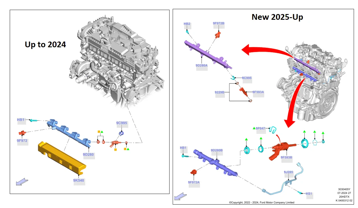

Who can spot the difference in the new 2.0L found in the 2025?
yeah, we see the port fuel injection rail and injector(s) in the upper left.
It's a completely new engine. Different block, different heads, different cams, different fuel system, different valve cover, different intake, different flywheel, different water pump, different thermostate housing, different crankcase ventilation system, etc...

in this pic I'm probably most curious about the very different head gasket. what the heck are those huge ports on the intake and especially exhaust sides of the gasket? surely not just coolant jackets (why so many and so large)?
if you are Ford tech or have a buddy who is, please find the exploded diagram of the ecoboost catalytic converter and gas particulate filter.
What about that 6G061 part number on the 2025 and not on the 2024. The part that has the red arrow coming out of the cylinders
Theres also a void on the block that matches the ports on the gasket on that you mentioned.
sure. and it can really only be 4 things:
air (weird, but not impossible)
oil galley (seems way too big?)
coolant seems most likely to me.
coolant or oil for some accessory? surely that would just be a separate hard line.
it's a little weird to me but honestly only using the old 22-24 block as a comparison.

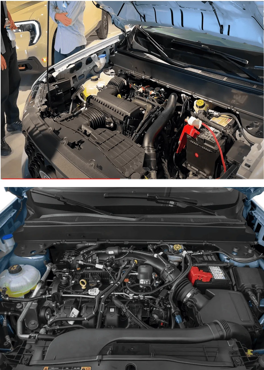

Still trying to figure out the airbox on that new engine.
