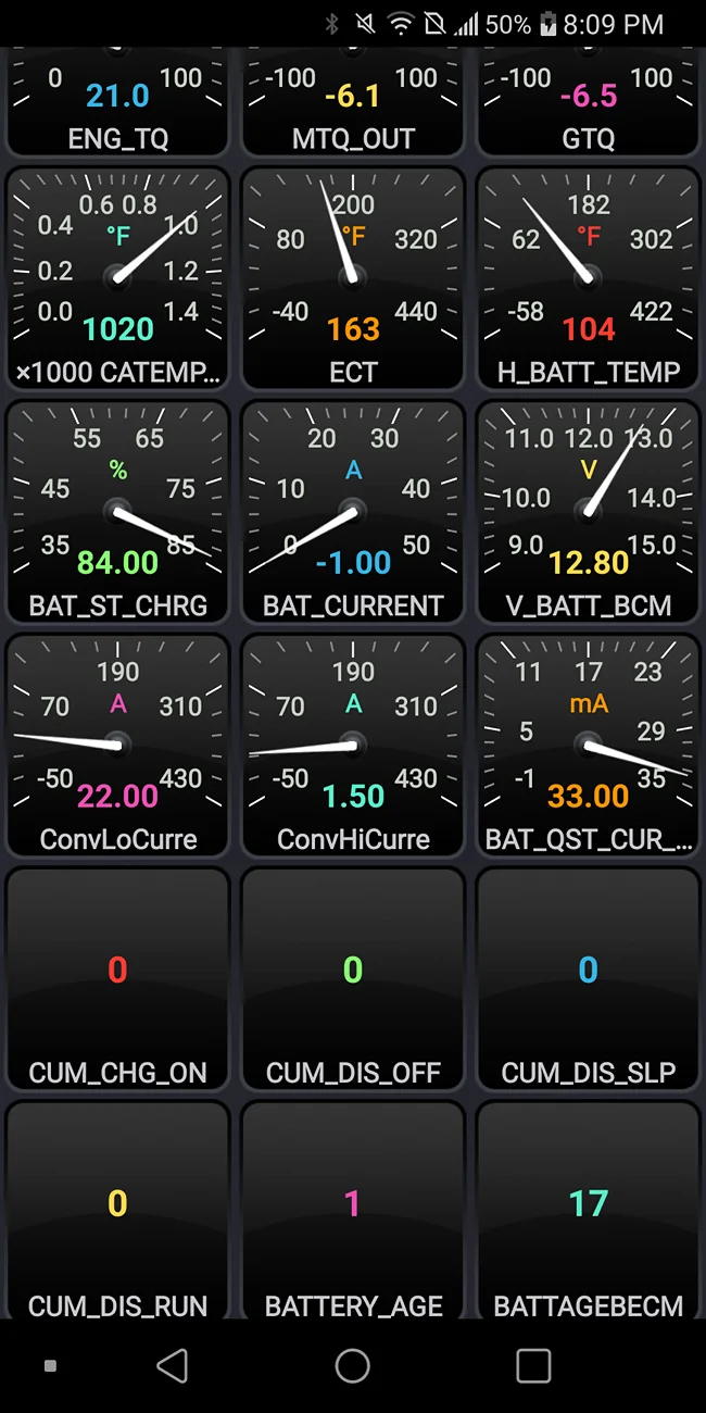

Here's similar view of it happening, sadly only the 1 day old battery ever saw this!
84% had just been at 85% a second before this - 1 A coming from battery, 12.8V. It indeed measured 12.7_ V on this FLA battery about 1.5 hr after I got home.

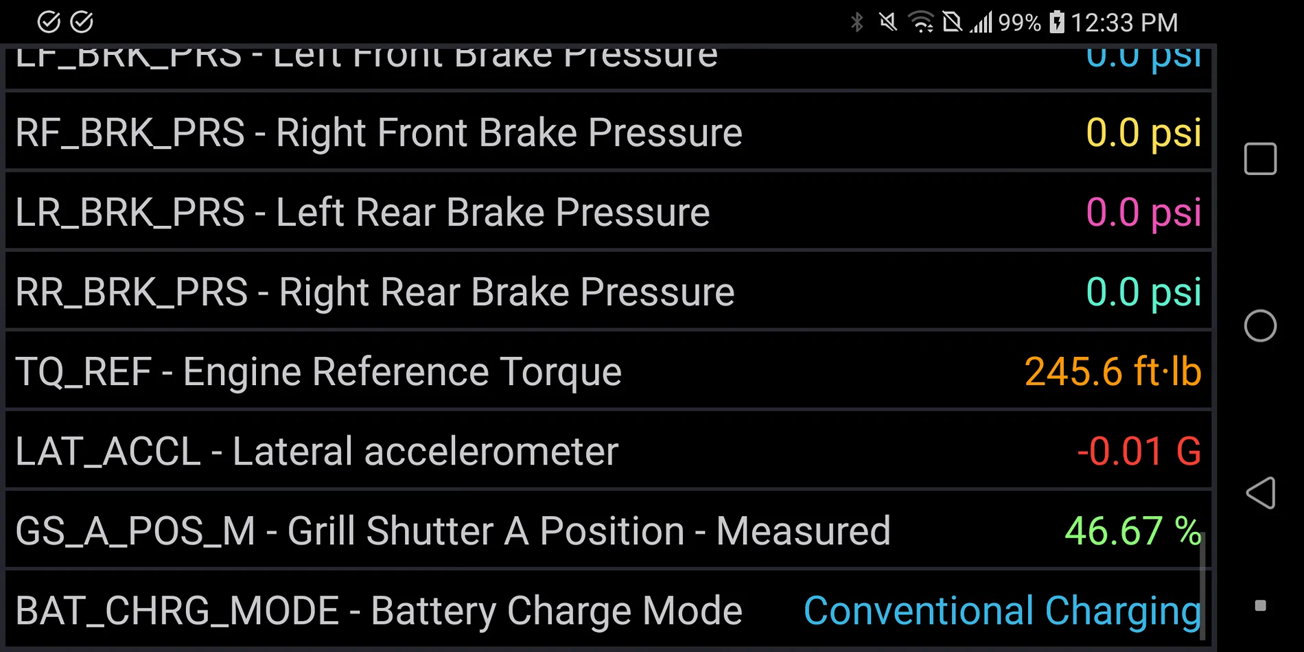

And since you have Forscan - perhaps a better setting you might take a look at, that might be used by the hybrid. I don't know, because you can find all sorts of EB specific PIDS on the hybrid willing to show a volue that is obviously meaningless. Or maybe even prior models.
Still under BdyCM - Battery Charge Mode. There were some options about faster available.
Mine is obviously the loser setting.

I installed one of these monitors, easy install and then able to monitor it 24H to see when there is a draw.
Ford Maverick 1st Battery Saver Mode since AGM Install 1767101487576-x3
Ford Maverick 1st Battery Saver Mode since AGM Install 1767101607187-qo
