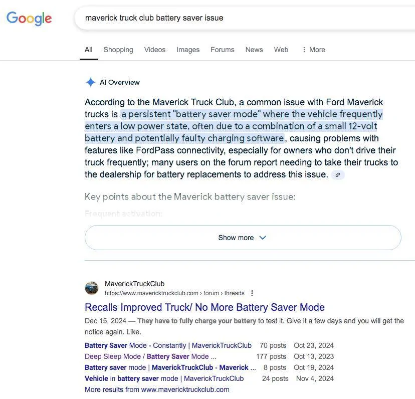

This is how you do it!
Ford Maverick 2024 Maverick Battery Saver Mode 1739918648225-8

Tons of threads/posts on this common issue. Search the MTC thread titles for Battery Saver . Search is in the upper-right corner of the screen.
