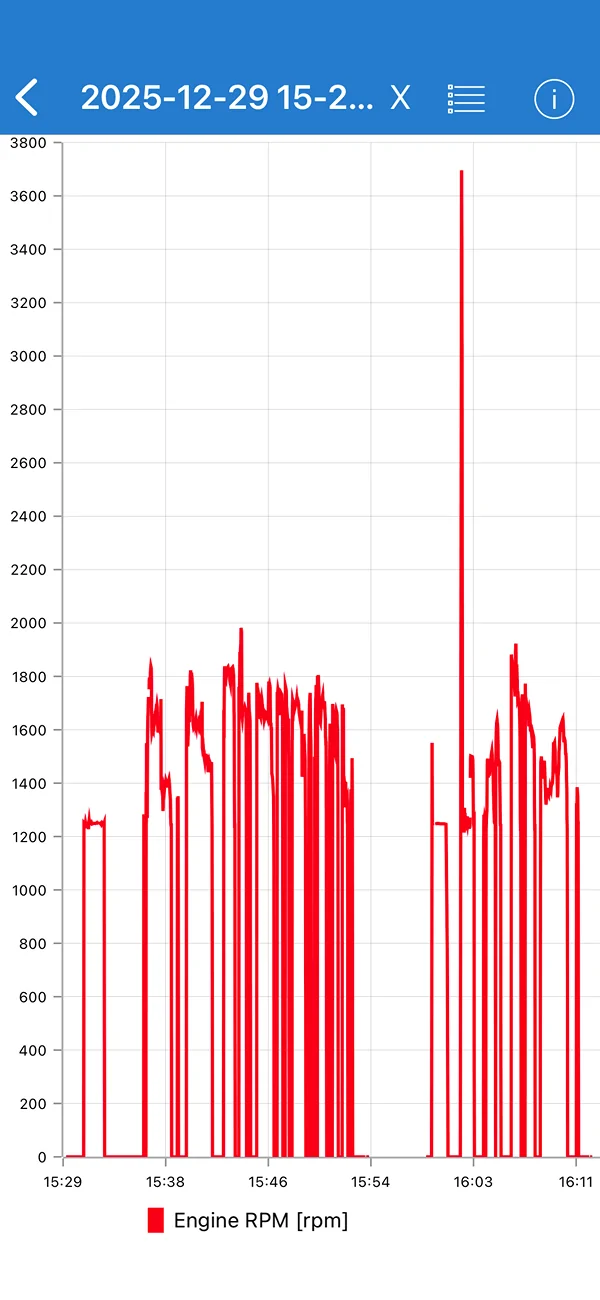

Had a O sh*t moment last night, I was just getting to leaving menards, and my screen froze, shut off the truck, waited a minute, and turn the key back on, and everything was fine.
Drove 100ft, and all of a sudden the engine raced for a second.
You can see it revved to over 3600 rpms for a second.
This is the first time this has happened.
Going to see if it shows a fault today.

So here are the answers to your questions.
After 5 hours in "ready mode" voltage came down a bit to 14.8 and current was .5 amps.
I did not do a BMS reset, but a BMS relearn, since after it stopped charging and drawing out of the battery, I would not have a good indication of fully charged battery.
The next day after sitting with the doors locked over night, my SOC was 89%.
Drove to work, 15 minute drive, the SOC was up to 90%.
I will use this as a new benchmark to see where it stabilizes at.
What are odds the battery relearn woke up the computer and it decided to relearn all the sensors and how they all work together. (= It's a new truck!)
