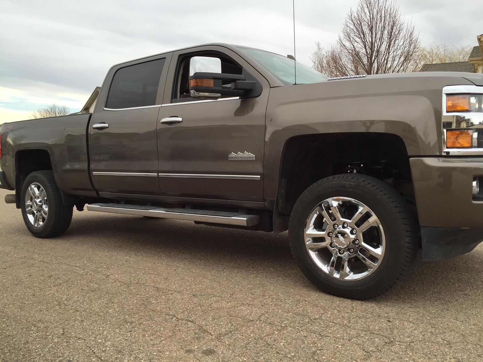

I leveled my 2500hd with a 2” lift on the front only. The on
Y way to avoid the issues you discussed above is to change the upper control arms(longer) so the correct many angles remain. Also it requires a longer shock or you will notice a terrible ride when the reach max length through normal or off-roading. The company equipment I used was CST. I’m pretty happy with the setup, but the knuckles need to stay clean or they need replaced every four years.
