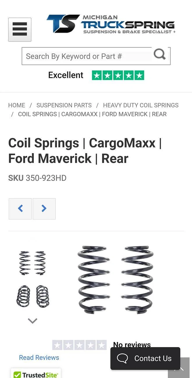

I found these load springs while searching online that claim to give the rear about an inch lift. I'm still debating if I want to give this a try as I want to keep my stock springs on and not having to worry about taking the stock springs off and putting away more junk (car parts) in the garage. I hate having items both in my garage and inside my house that I will possibly never use (that's why I got rid of the wife). It stirs up my OCD.
You're looking for something simple, and honestly I don't know what would be simpler than an air spring kit, but the load springs should work as well and give you a higher spring rate, making them a better choice than spacers. The air spring kit won't stir up your OCD with extra parts lying around, and the main benefit with them over springs would be that they're pressure adjustable with varying load.
If you don't want air bags for some reason that's fine, It's just a suggestion I thought I'd throw because they will do exactly what you're trying to accomplish simply and cheaply.
