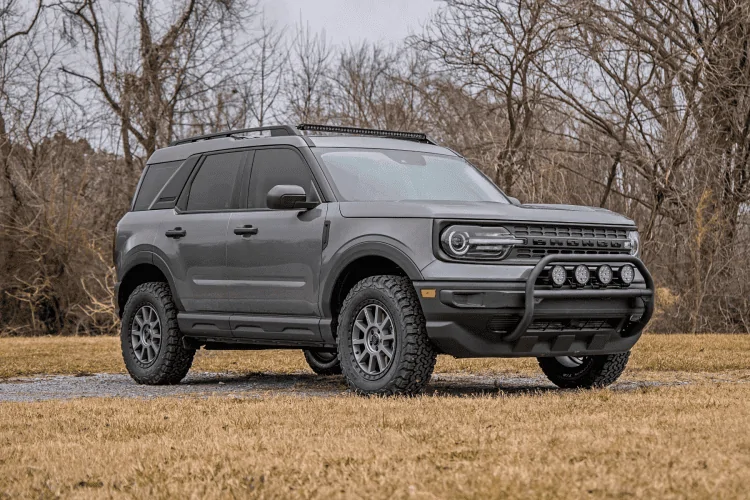

I really hope the aftermarket embraces this as an off-road/softroad platform. I’d be coming from a 1 1/2” lifted Subaru Outback on 29” tires. I personally don’t think I’d lift the Maverick unless it was a true SUSPENSION lift, not a spacer lift, that Rough Country (which is terrible btw just check the Bronco Sport forums) and the like sell. Those can lead to harsh ride, and bad cv axle angles if not done right. If someone offers an extended spring/dampener combo and a subframe drop to correct the driveline angles then I’d bite.
