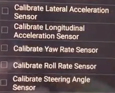

Hopefully after alignment (that's rather serious to have moved the subframe to accomplish) they did the centerpoint calibration for the steering wheel & system.
So the system knows what straight is and applies same amount of resistance to movement either direction.
That could effect the lane centering too.
But you need to make sure you are clearly separating issues.
With all auto-driving assists off - does it track straight now on level road with no wind?
That's one thing.
Then, with your lane centering enabled on roads with good clear lane markings - does it do the same bouncing back & forth?
That's another thing.

Featurs off still same problem flat road no wind I belive they are related as features make it worse undrivable its like the computer doesnt see zero input
Just to confirm you saw my comment on what they needed to do after alignment.
Your work order should state all that was done. Read it carefully looking for that.
These may be the terms they use, or similar.
