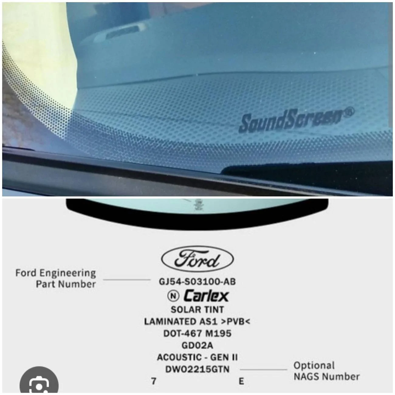

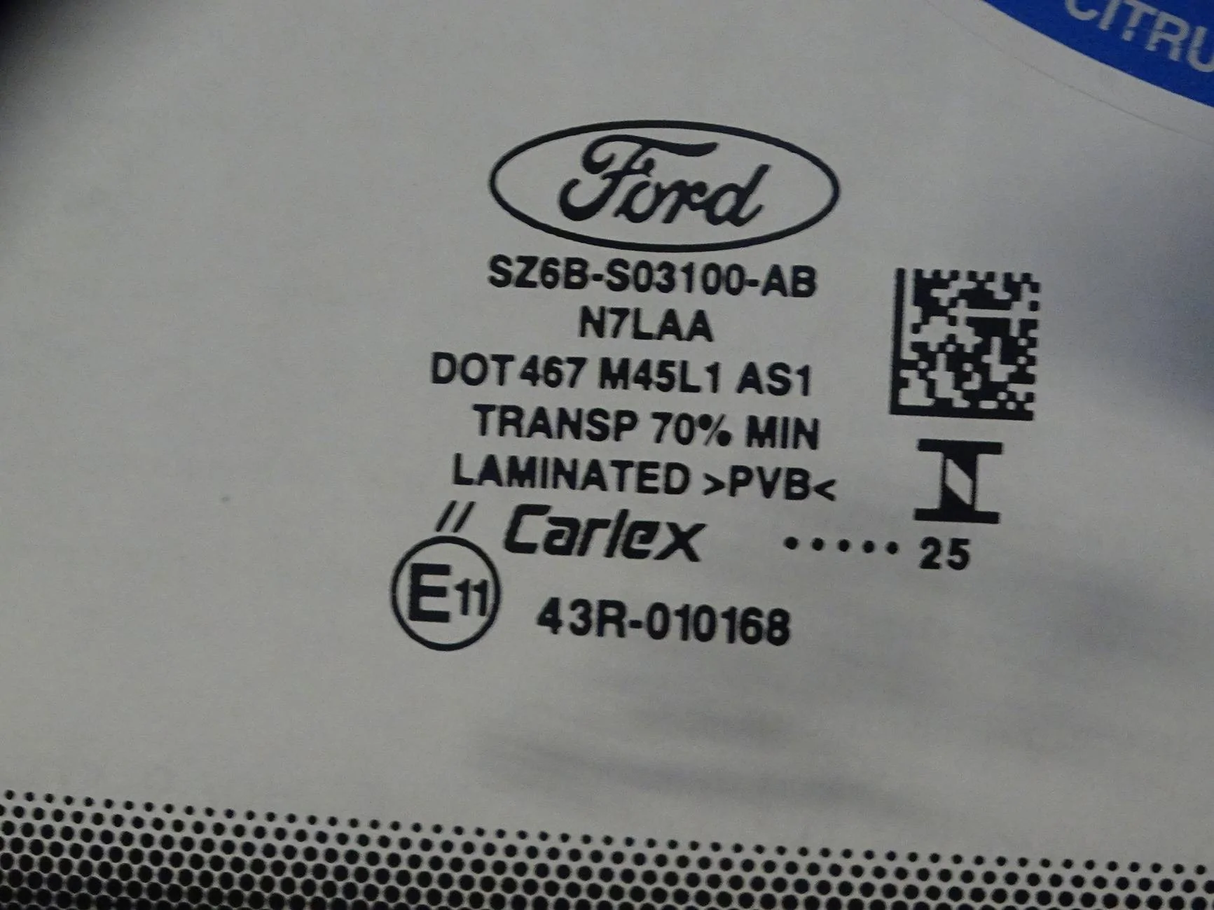

The only concern I would have is make sure there have not been any changes to the camera(s) and sensors behind the rearview mirror (I don't think there have been any changes through the model years).
The cameras did change on the '25MY, and it looks like the cutout in the frit (the black enamel bonded to the glass) has a wider angle opening.
