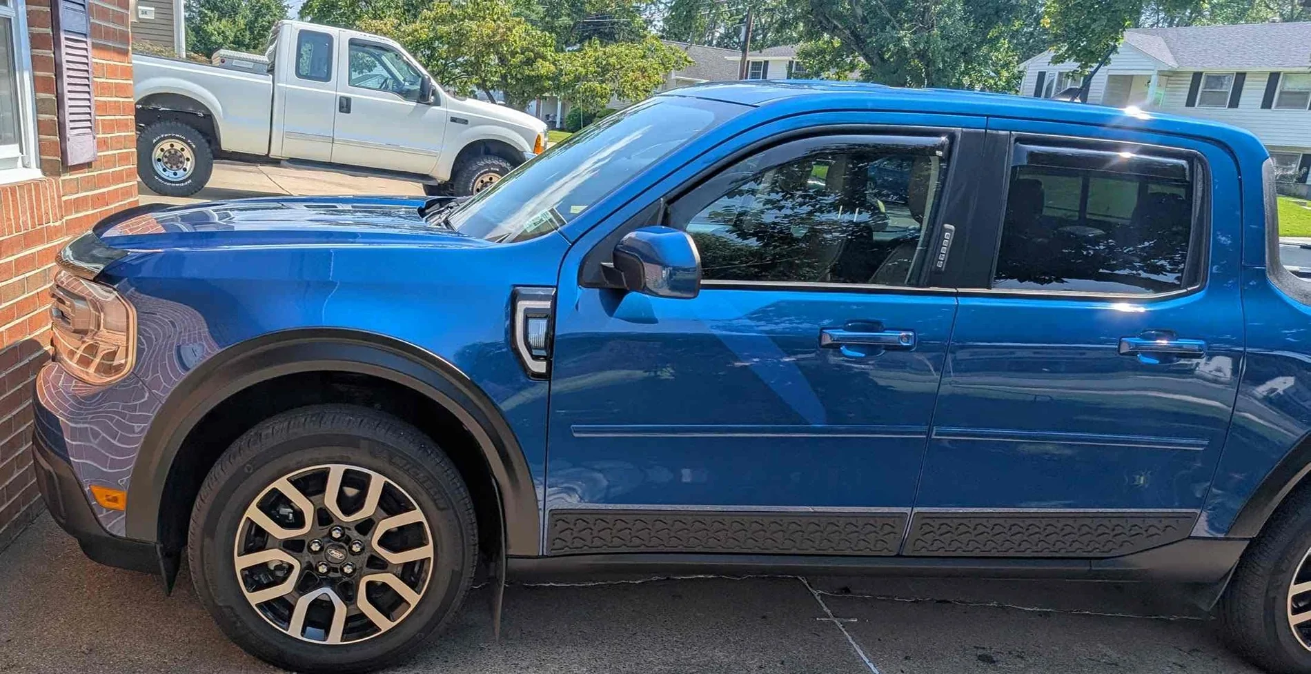

Barely visible, if at all:
Ford Maverick Wind noise while driving Current Side View of Maverick
They install on the indented gap, and it's the side profile which mates, and presses agasinst the inside edge of the front door. This a photo taken on Sunday, after I finished cleaning her up, but before applying the tire dressing. They've been installed for a couple months now.
Link to that weatherstripping is: Here
You'd never know it was there. Very nice. 👍
Thank You for the picture and link.
