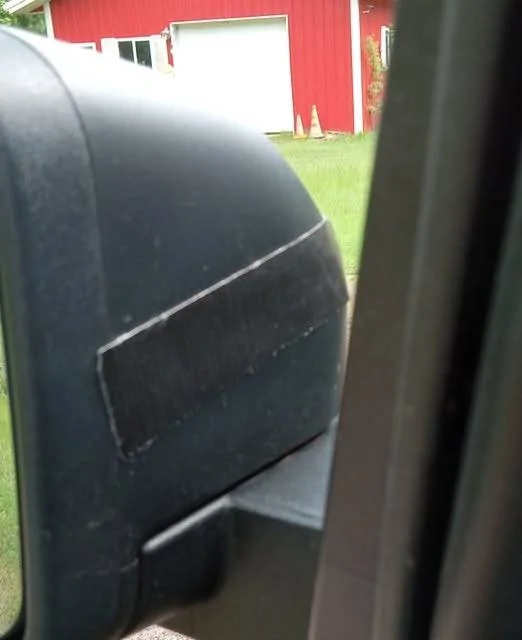

Here's a quick fix for some of the wind noise on your Maverick. On the inside of the Mirrors there is a little v shaped channel that dead ends against the mirror cap. This dead end is flat and with the v channel it has a figuration like a whistle and does give off a low wind like pitch sound. I just put a piece of black duct tape over it on both mirrors and most of my wind noise is gone. Simple fix.
But that noise is to scare wildlife off the road.😉

i had a Honda Accord that needed the ol' tape whistle-fix on the mirror.
