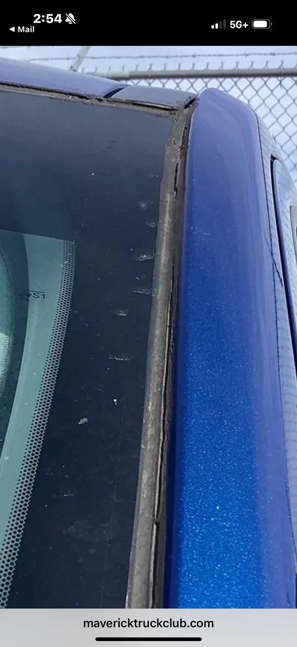

Wow - That seal looks to be in bad shape.
Most windshield shops can remove and replace the seal for less than a Benjamin.
I wonder if Ford changed the design... I get no wind whistle on brief forays over 80 in my 25 XL.

I picked up my mav from Long McAthur Ford and drove it back to Dallas. I heard the wind noise right away but in a cross wind only. After my ‘fix’ I have been in many cross winds and I have not heard the wind noise again.
What you are seeing is the silicon that I applied.

I see what Maverick dragon is saying is that picture after you put the silicone on?….Because if so, why does it look like shit?
