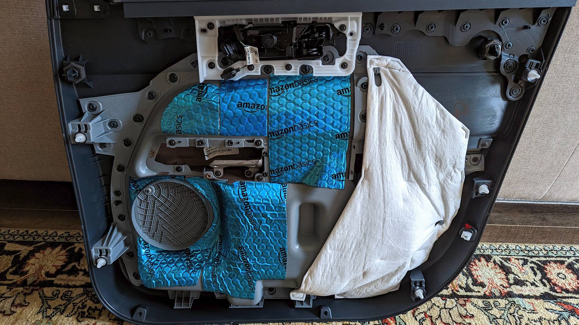

the Lariat windshield is quieter. I also read, but do not know it to be true, there is sound deadening in the Lariats that is not in the Xl and XLT.
consider this the truth, then. :)
this is a lariat door panel. the white cloth is factory sound deadening. I have no idea how effective it is against wind noise as I've only briefly driven non-Lariats. (edit) 22-24 XL and XLT do not have this, but I am not certain about 25+. I would expect '25 lobo and tremor to have it.
the blue thingies are amazon sound deadening. I should have put some behind the cloth!
