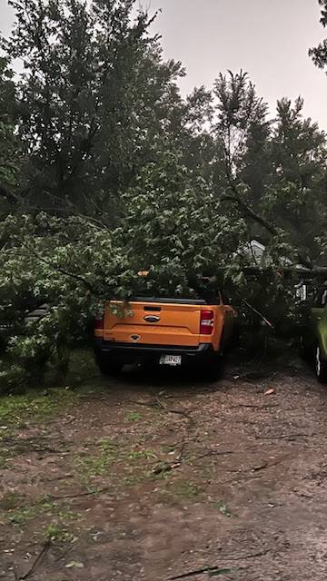

My old one developed some heavy wind noise for some reason. The new one, not so much!
Ford Maverick Wind noise while driving Maveroak
