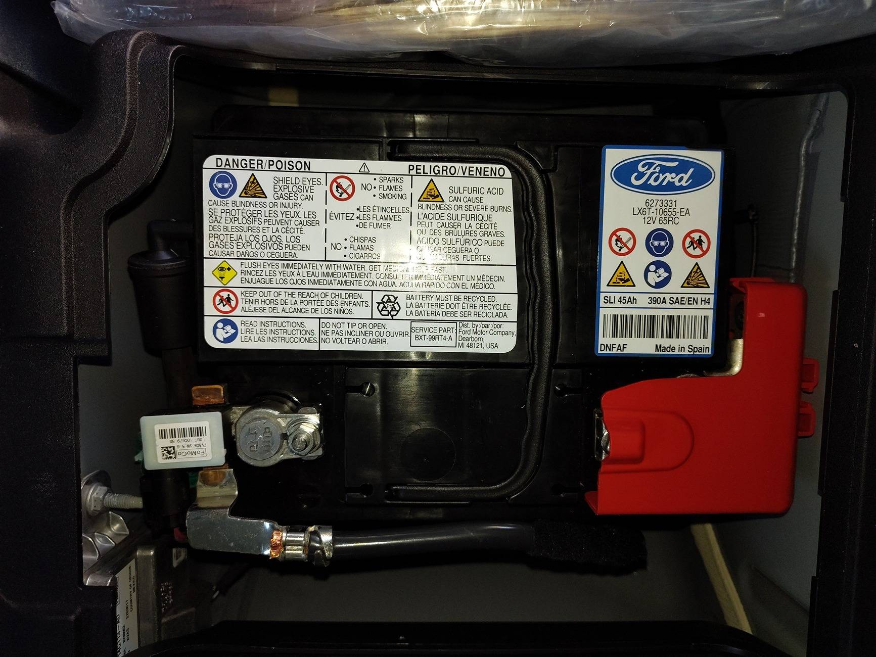

Makes me wonder if they used some decent batteries for a bit, or perhaps it had to do with trim line.
Did you get all the recalls that had to do with the Body Control Module BCM - like taillight issue, ect?
Is this your battery?
Sounds like there was a slightly upgraded version of this with tad more CA/CCA (perhaps opposite), but still made in Spain, and still problematic.
One label says H4 size (which dimensions agree with), other label says it's their OEM size 99R / T4 (which it's not per height).
