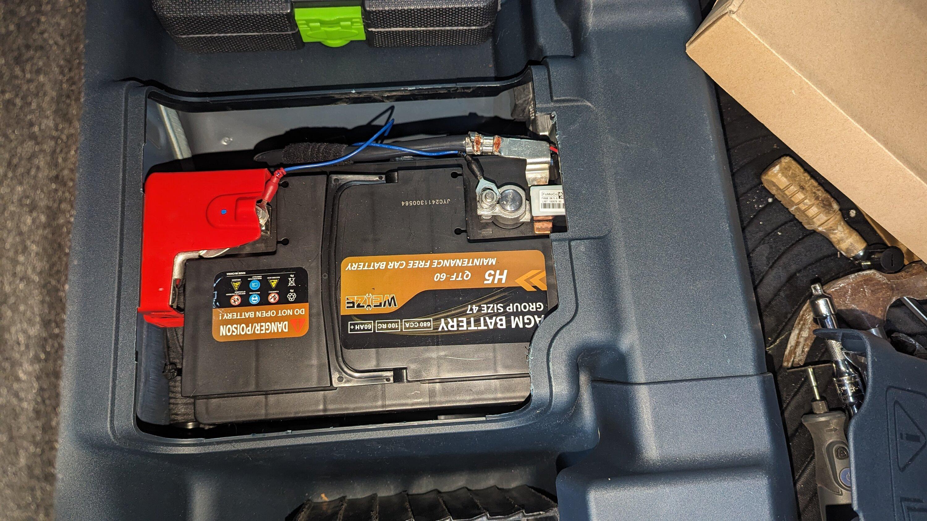

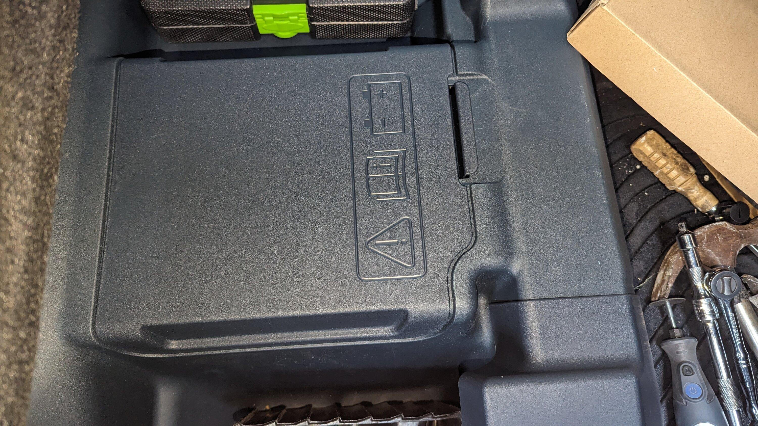

I did the same. Took about half an hour. It's tight but works. We'll see how it does with the deep sleep issue.
"My cordless Dremel had a tough time cutting the tabs, so I scored them and pounded them down with a small hammer. - Which lowers them to the height of the balance of the plate.
Popping out the plastic panel makes it a LOT easier to place the larger battery in the tray.
No other modification needed, and panels are easily pulled off, and snapped back into place.
Waiting the 8 hours after BMS reset, however the transmission period barely dropped the voltage or SoC."

The batteries at the dealership are the same as what comes in the truck, an 'Enhance Flooded Cell'. Oddly, the BCM is programmed from the factory for an AGM battery, not a flooded cell. - I actually wonder if that's the issue, since an AGM takes higher voltage typically to charge. They even sell AGM diodes to help when replacing a flooded cell with an AGM on vehicles not setup for an AGM.
BTW, I bought mine online directly from Weize Battery. So far, so good, and cheaper than my time to drive up and sit at the dealership waiting for them to get to servicing the truck. At some point I'll ask my brother to take the battery to work, test it, and replace it for a spare. - My OEM battery drops voltage/charge just sitting on a shelf. (Under 12 volts within just a couple of weeks off the charger).
