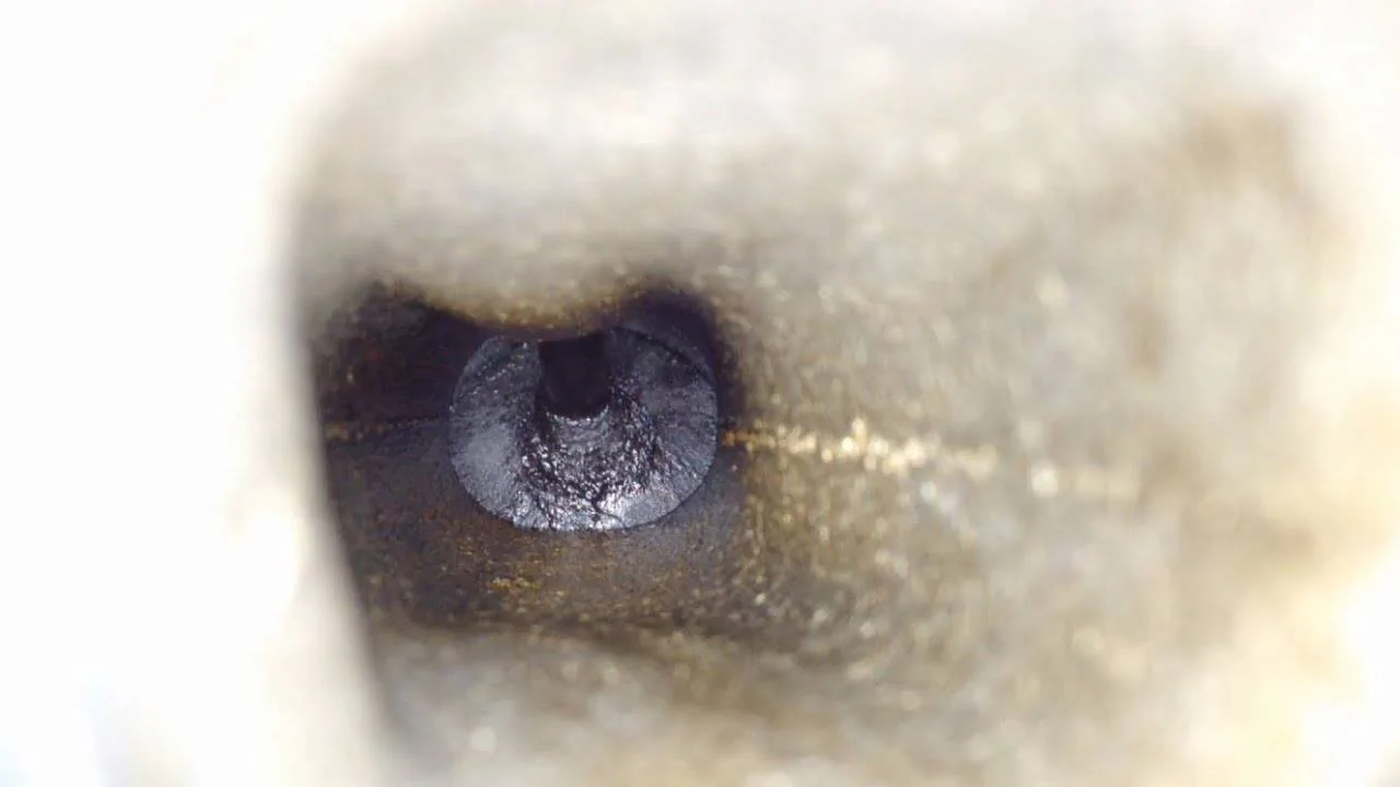

Which engine? What is the source of the photos? Here's more actual evidence:
https://www.autoguide.com/auto-news...a-problem-with-direct-injection-engines-.html
As far as I’m aware, those photos are of 3.5 V6 Ecoboosts. Here’s a photo of a 2.3 cylinder head caked. Same as the 2.0.
And that article is “is it a problem?” Not, “will it happen”. Objectively, it will happen, regardless of how fast or slow. Will it be a problem? Probably not for 90% of people.
Random photos with no provenance are not very good evidence. I've provided evidence from two sources as proof of my claims. Where is yours?
Yes, you keep saying this, but you have offered no proof.
Where did you get the 90% statistic? If valve contamination does not cause driveability problems for 90% of EcoBoost owners then why would Ford add port injection to prevent it?
Random photos?? My brother in Christ, they’re direct injection ecoboost engines. That IS the whole point. The caking is RIGHT THERE 🤣
Plus your sources are articles with one statement or no actual backing to your argument.
If you’ve never taken a manifold off your ecoboost and seen your valves from the outside I don’t even think you’re allowed to argue 🤔
At this point I’m convinced you’re ignoring it because you like to hear yourself be in opposition to something for fun.
I personally never stated they added the PI to solve the problem. The dual fuel injection is beneficial for plenty of other reasons. I even said in response earlier that it remains to be seen if the small amount of fuel that’s actually being used from the PI system will make a measurable difference.
All I was here to do was laugh at the statement that valve caking has “NEVER been a problem” on ford engines.
They are random to me. I have no idea where they came from, who took them, what engine it was, whether the engine was modified or stock, etc., etc., etc. Like I said, a few random photos is not evidence of widespread issue with valve contamination.
I linked to an article with a quote from a respected source that clearly says valve contamination is not a widespread issue with Ford's EcoBoost engines. I note you have offered NOTHING from any source other than yourself to back up your claim that it is.
This is a logical fallacy called appeal to authority. One of humanity's greatest advances toward modernity is our ability to learn from other peoples' experiences.
Please quote the post where I made that claim. I have said repeatedly that valve contamination is not a widespread issue with Ford's EcoBoost engines. Do some people experience valve contamination. Yes. I was a member of the Ford Mustang EcoBoost forum for several years, and more than one person reported such problems. But after you did a bit deeper you find their engines were modified, usually with software meant to boost power.
