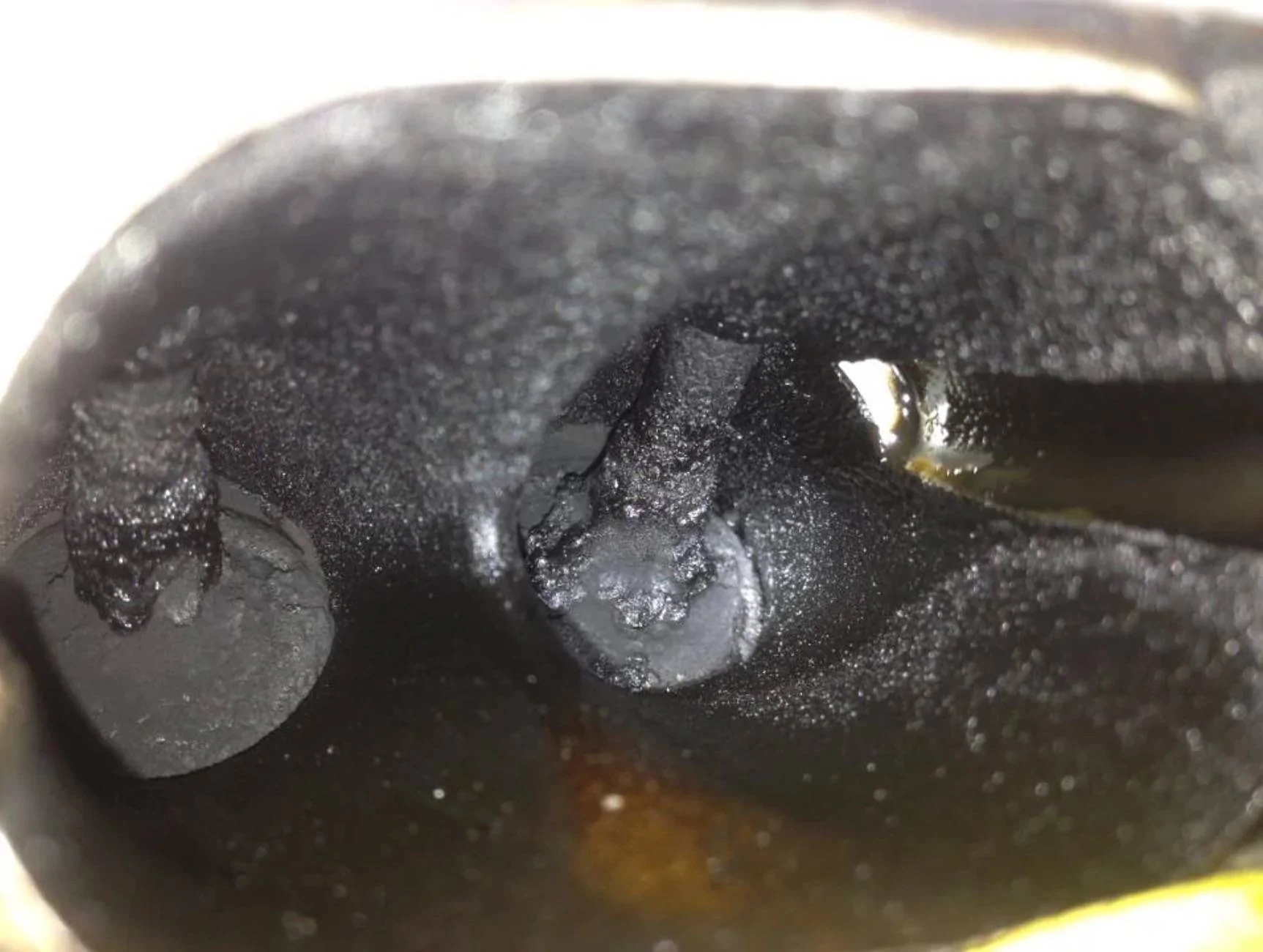

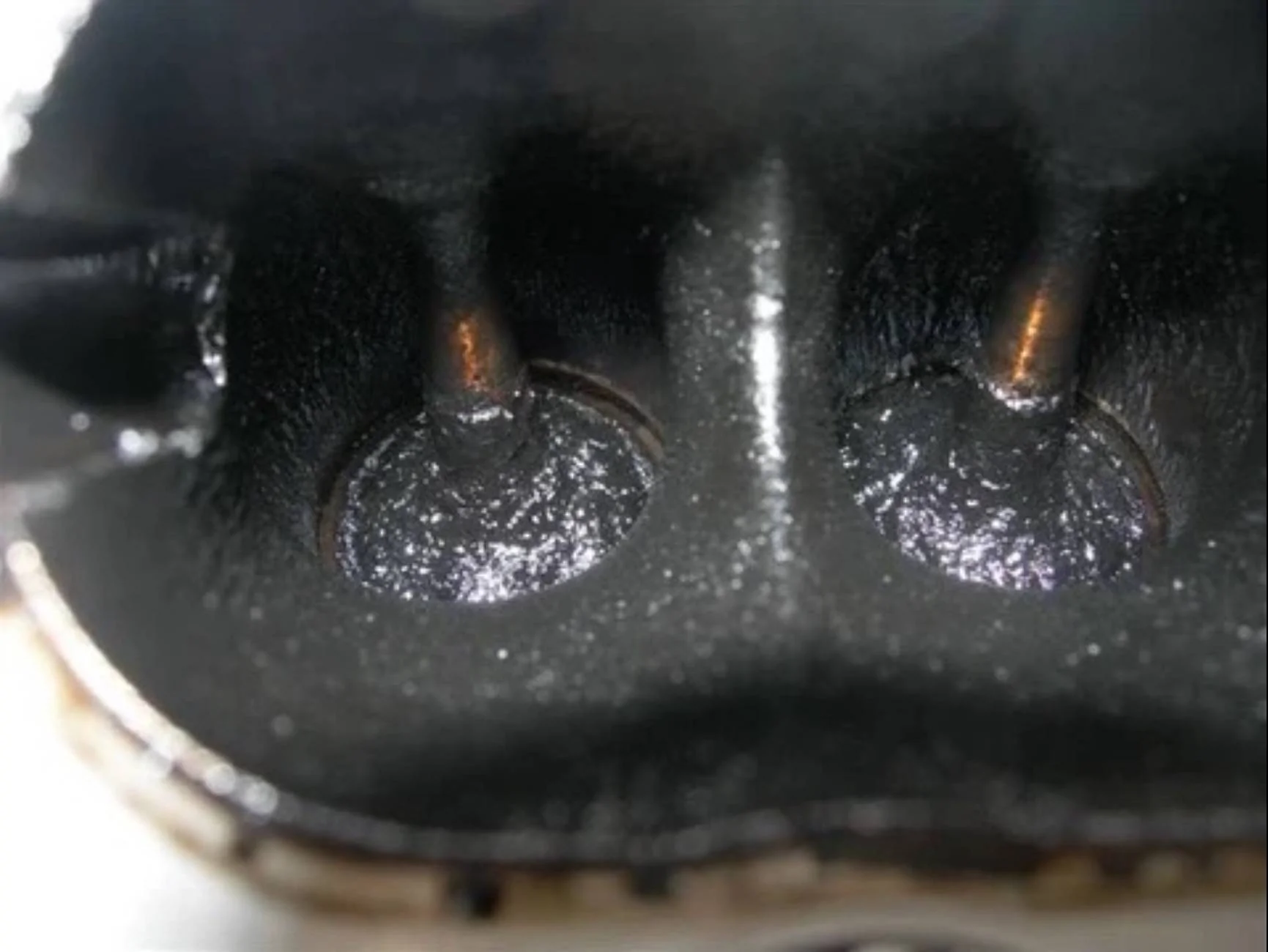

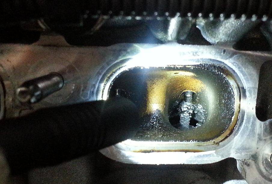

I had a mazdaspeed MZR DISI, predecessor to the ecoboost. It idled smoothly and got normal fuel mileage even modified. The valves were caked to shit. Did you even look at your valves? Because that would be actual evidence.
Ford's EcoBoost engines include an air/oil separator to prevent liquid oil getting to the valves. These engines have been in operation for over a decade. If widespread valve contamination were a problem we would know about it by now. Show me your data.
If you are calling the PCV plate an AOS, I have bad news for you…
A real AOS isn’t foolproof either. You will still get oil bypass. Your best bet would be an oil catch can with filtering material and completely removing the oil buildup that enters
also, here’s multiple pictures of caked ecoboost valves, I guess

You can have caked valves without issues. Granted, newer engines are way less likely to have a lot of oil blow-by, but there will still be minor amounts. There’s a high likelihood you have some oil buildup on your valves and just don’t know. If it’s not causing you any serious issues, don’t worry about it too much. But it certainly wouldn’t hurt to check and have it cleaned if necessary.
