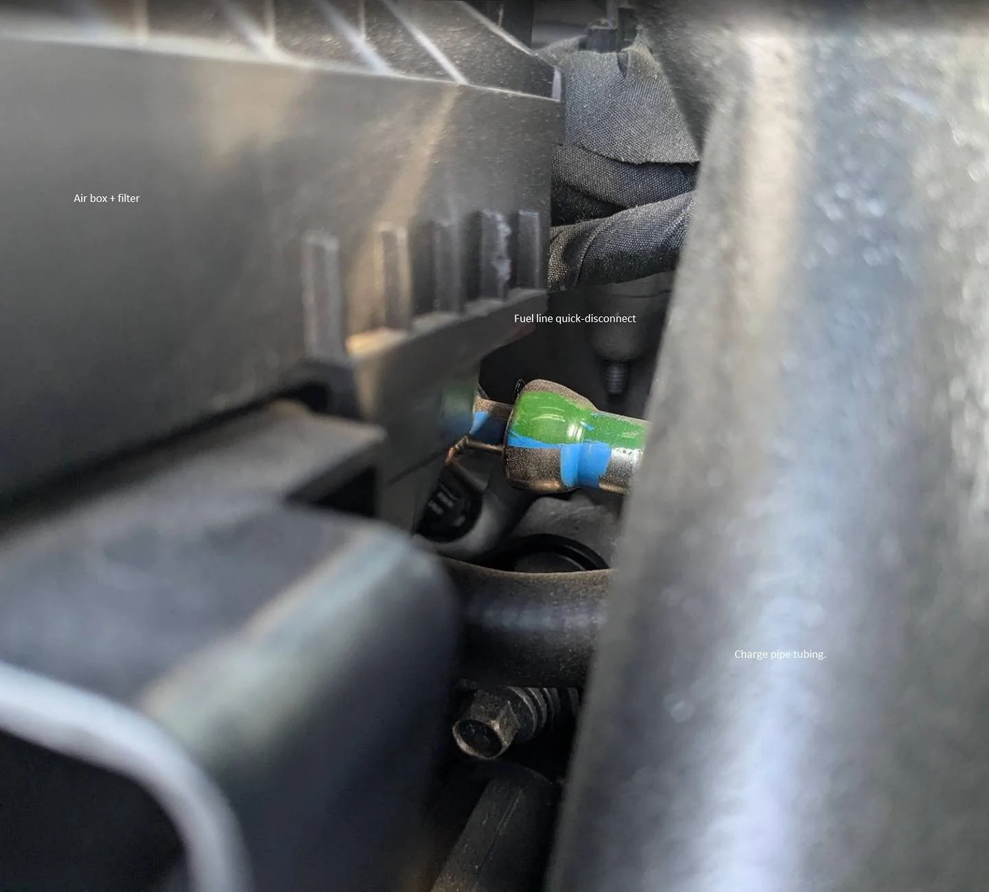

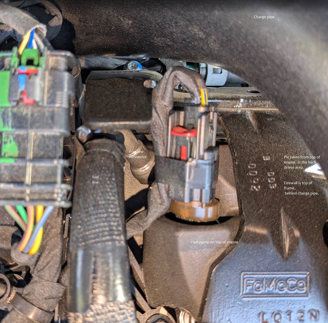

Fuel line Q.D. into upper fuel rail (above intake)
Ford Maverick Why new intake/manifold design for 2025 Maverick? 01 '25 Mav 2.0L EB

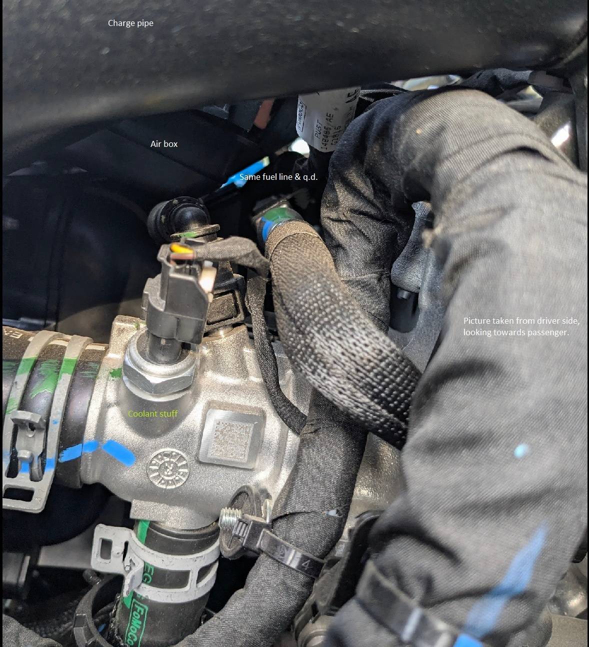

Upper fuel rail fuel line and q.d.
Ford Maverick Why new intake/manifold design for 2025 Maverick? 02

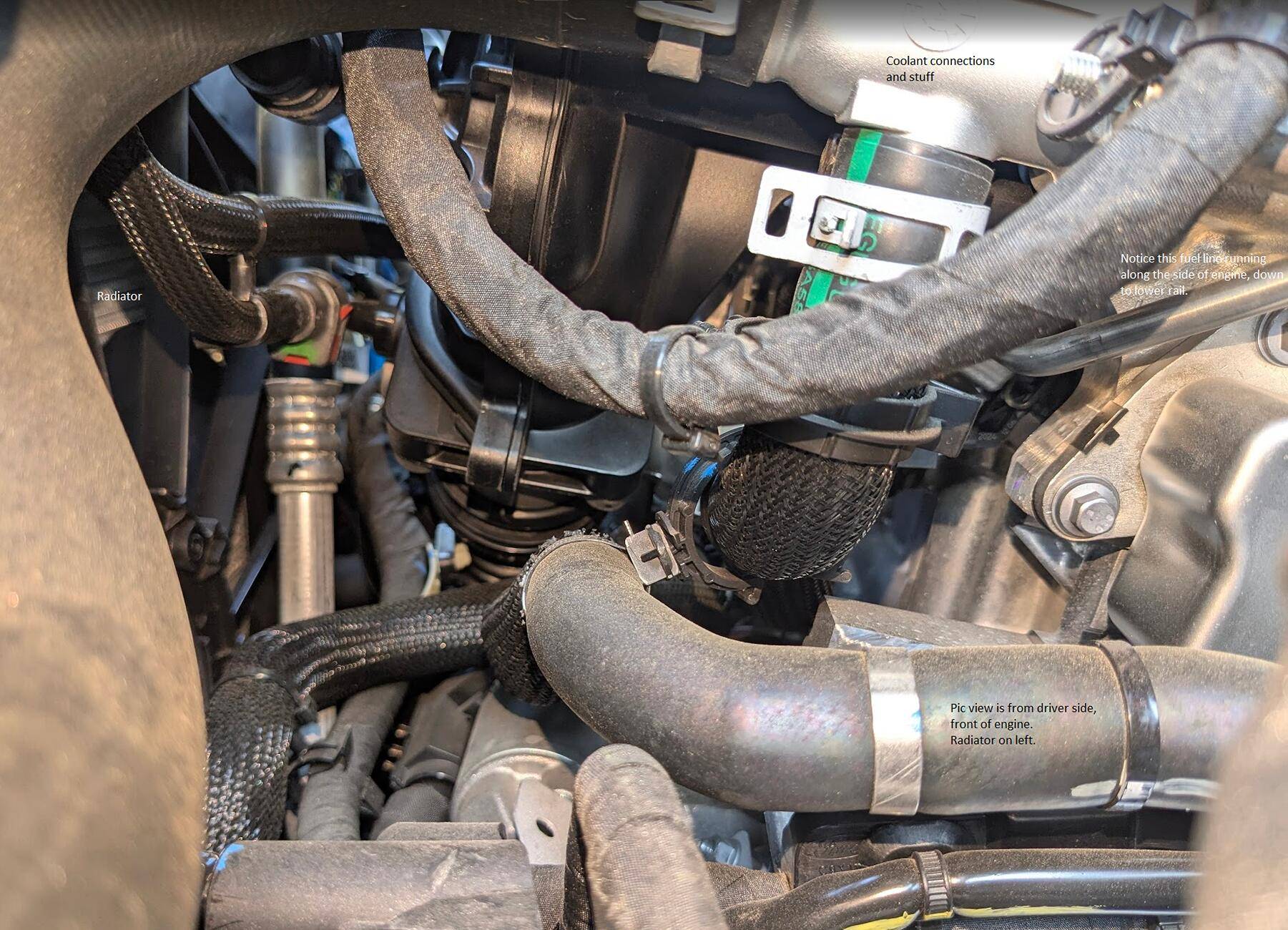

Directly below previous image.
Noting the metal fuel line running down the side of the engine to the lower fuel rail.
Ford Maverick Why new intake/manifold design for 2025 Maverick? 03a fuel pipe along side of engine to lower rail

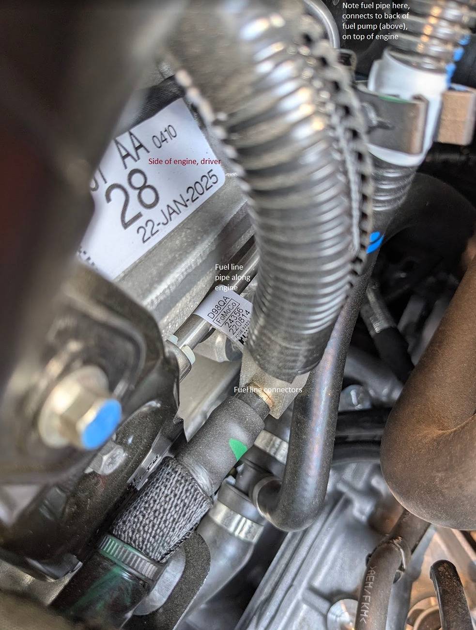

Side of engine, driver side.
Tracing the route of the metal fuel line along the engine, and up the back side to connect to the upper fuel pump.
Ford Maverick Why new intake/manifold design for 2025 Maverick? 03b fuel pipe side engine
Same side of engine, with upper fuel pump location in view.
T-junction for fuel lines, left routes to the upper fuel rail.
Up to the upper fuel pump.
Right goes out to a fuel line connection near firewall, presumably to the tank?
Ford Maverick Why new intake/manifold design for 2025 Maverick? 04
Upper fuel pump on top of engine.
Ford Maverick Why new intake/manifold design for 2025 Maverick? 05a upper fuel pum

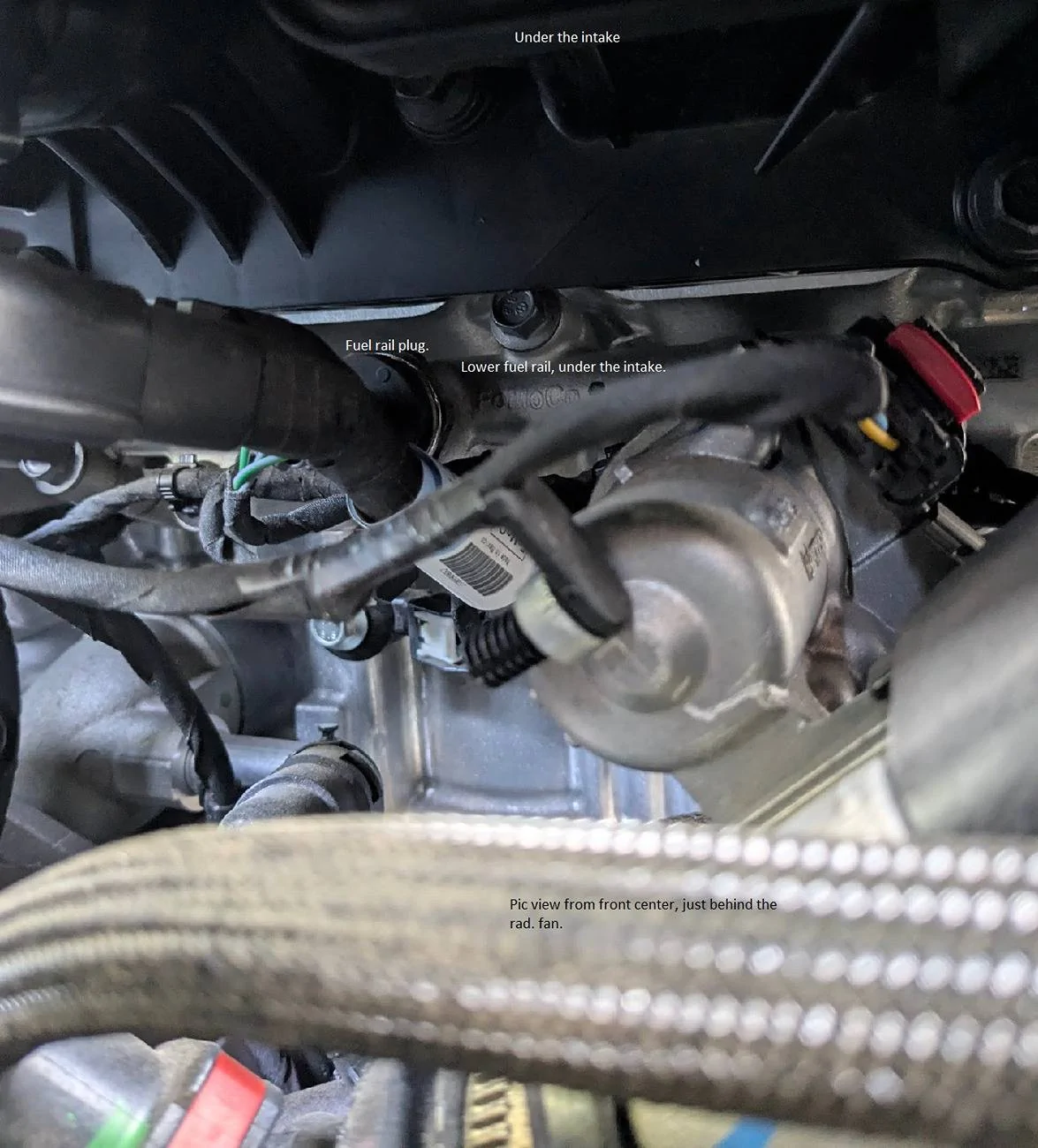

Now under the airbox and, under the intake.
Lower fuel rail.
Ford Maverick Why new intake/manifold design for 2025 Maverick? 05b lower fuel rail

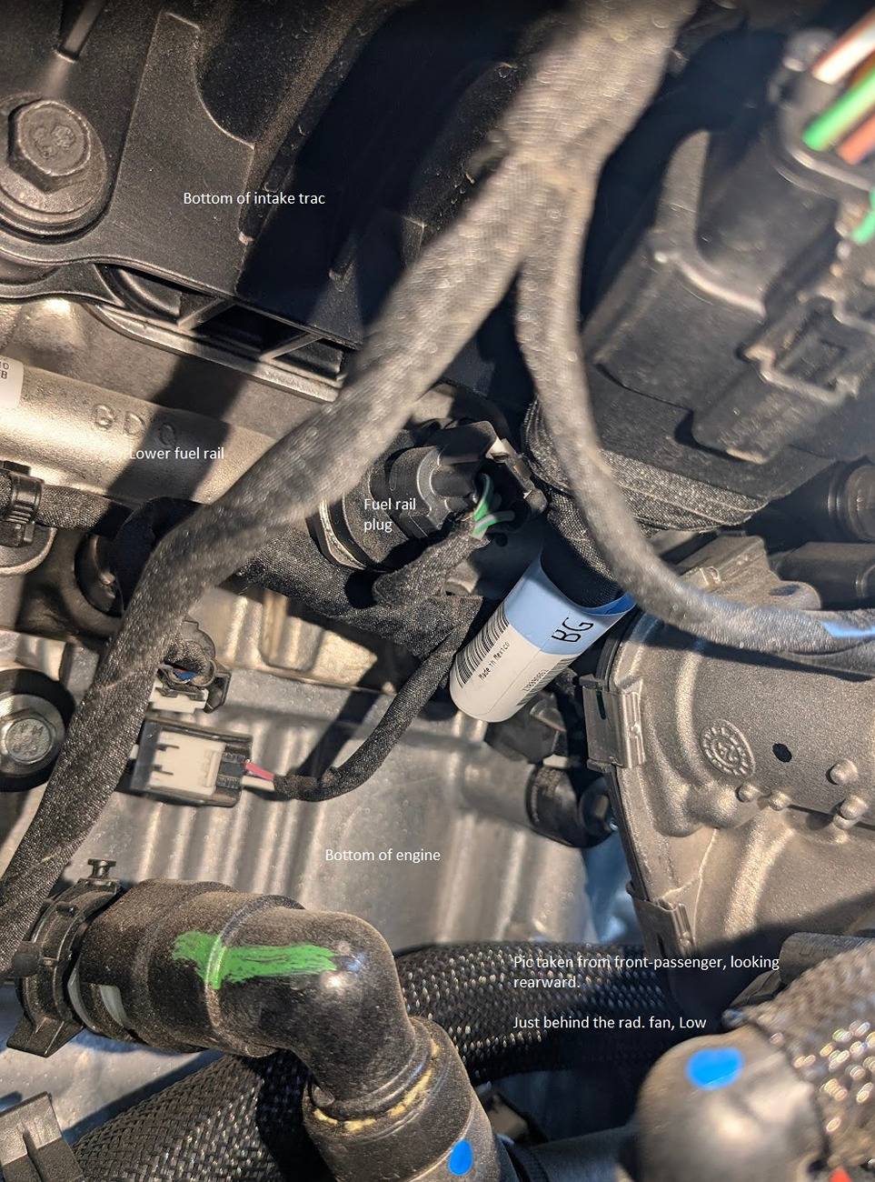

Lower fuel rail, another angle, better shot of the fuel rail plug and connector.
Ford Maverick Why new intake/manifold design for 2025 Maverick? 06 lower rail

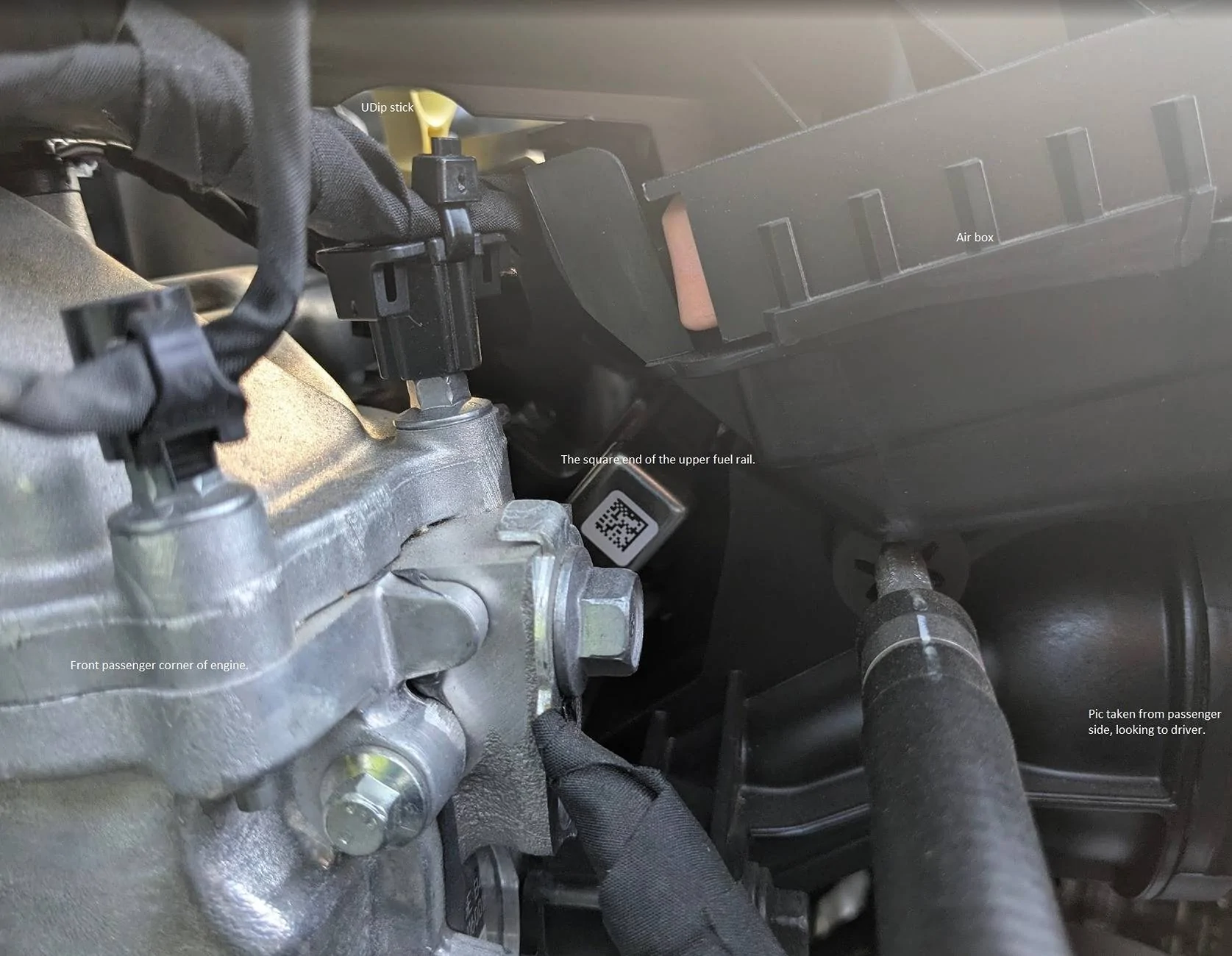

Passenger side now, upper fuel rail 'end tank'. (With a QR code on it?)
Ford Maverick Why new intake/manifold design for 2025 Maverick? 07 upper fuel rail
