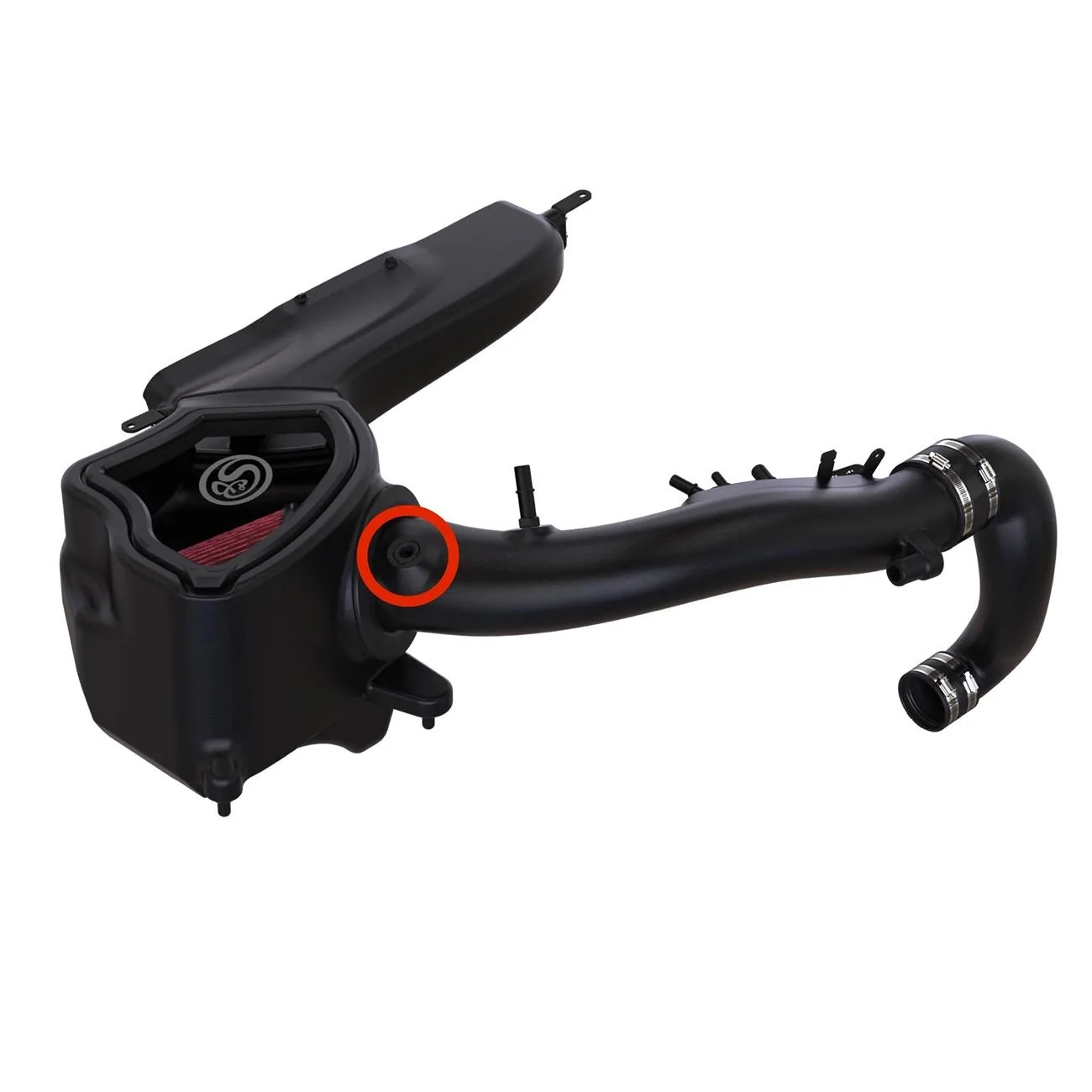

I never noticed this thread until the reply yesterday, and I see the OP hasn't been here in a while but I'll ask anyway -
what specific sensor value was giving high temp readings? on my AP I look at charge air temp, which is after the intercooler and more relevant as it's going into the throttle body. Intake air temp (IAT) is what's in the pic and I've logged it before, but I don't look at it on a gauge. I'd be curious if the OP -or anyone else with a tune and this type of intake- sees high values from charge air temp, or this much variation whether the top is open or shut. (I say 'this type' intentionally because I think afe is a similar design.)

With my ap charge air temp is consistent 20° +/- ambient temp with any kind of movement ( obviously idling it rises pretty quickly) that's With afe intake and cvf intercooler. It was pretty similar pre intercooler maybe 25 - 30 ° before

I noticed when removing the stock intake, the tube just above the turbo had some heat shield adhesive. The SB unit does not have this. Was thinking about trying to gorilla glue it to the underside of the SB -

I actually pulled the factory heat shielding off the intake tube and used hvac foil tape to attach it to my afe intake in the same spot. I suppose that would have been relevant in my previous post lol
Yep I should have done mine before installing the whole intake.

I have the S/B and think its great- Fit n finish is top notch- Gives the Mav some more growl and zip while being really quiet- The OEM airbox sucks in regards to getting the filter out and then back in using its dumb tabs- With that being said yes it flows more "air" than stock and with that might lower the intake charge by a couple of degrees but if folks are really advertising Intakes as CAI why not do something to heat proof them from intake to turbo inlet ? That engine bay gets hot AF -

Cold Air Intake--It's just a term coined by who knows who to differentiate intakes that draw air from outside as opposed to drawing air from under the hood.
S&B with twin Velossa inlets, Cobb tune:
Ambient temp - 99 degrees
Intake air temp - 103 degrees
Charge air temp - 114 degrees (factory intercooler)
When turbo rolls above 15# the CAI will come down a few degrees.
Not noisey but you can hear it (stereo off) when accelerating hard, and you can hear it dump when you let off. Cover off it is louder.
80,000 miles, zero problems, all recalls still open, little truck is still fun.
