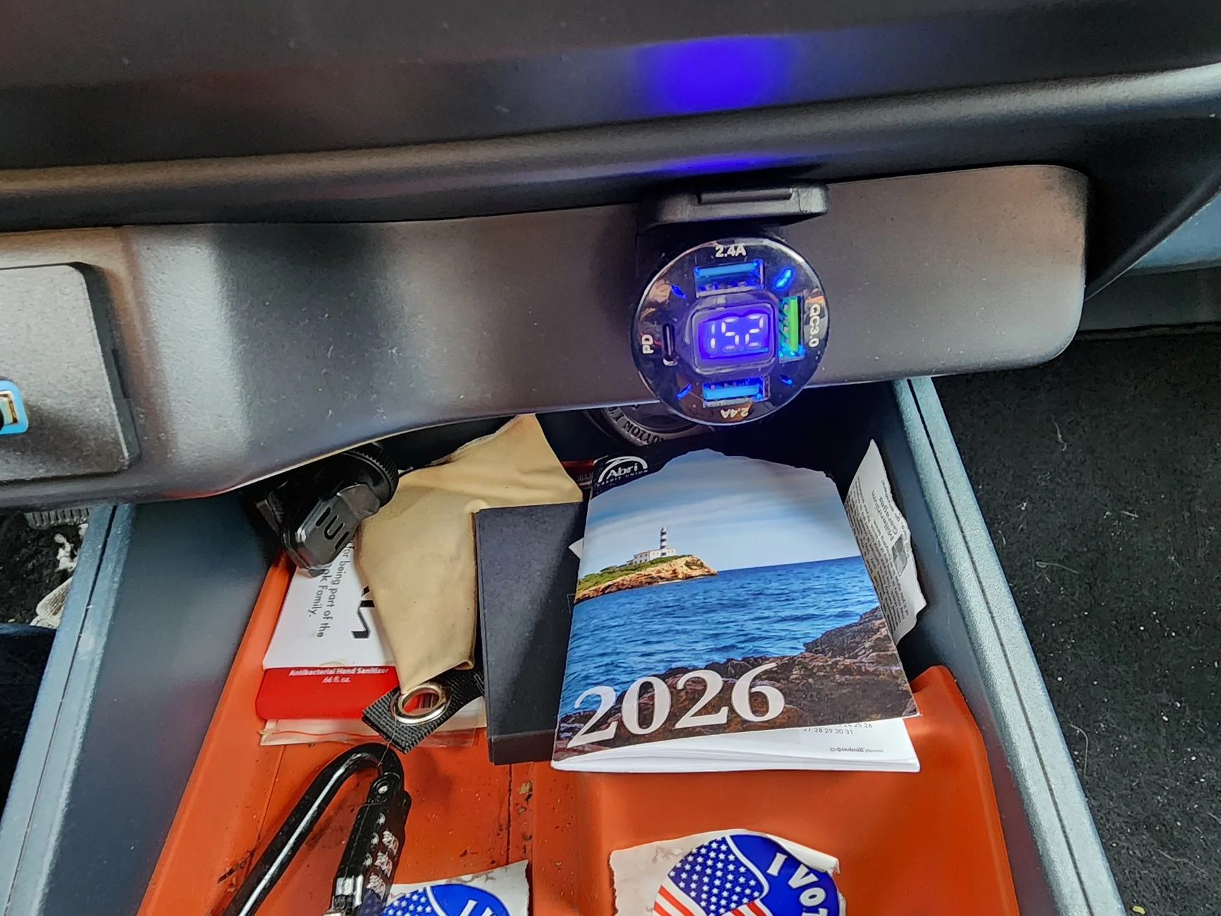

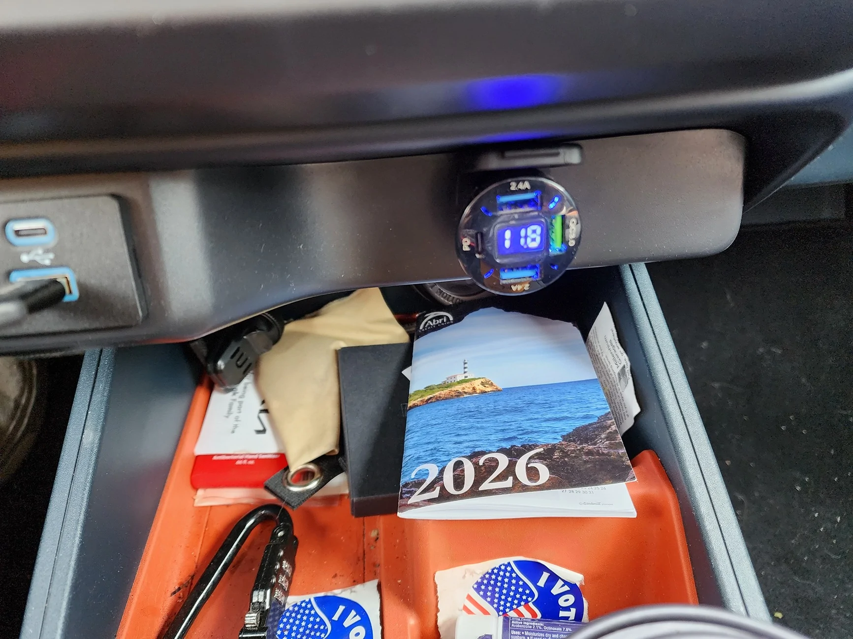

Here's my voltages from the cigarette lighter ignition on and engine on. Thai hasn't changed for two years. :
Looks exactly like mine.

The owner's manual does not specify voltage or SOC that triggers warnings. I got tired of searching. The best I found is:
"Ford's Battery Management System (BMS) triggers warnings based on low State of Charge (SOC) or voltage, often around 20% SOC or lower..."
20% SOC is about 11.7V -- which corresponds with some posts here.
Anything less than 12.4 volts (close to 70% SOC) risks sulfation, lower capacity, and shortened service life.
