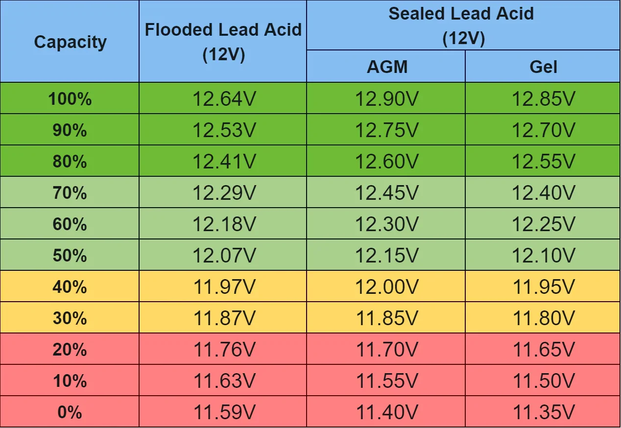

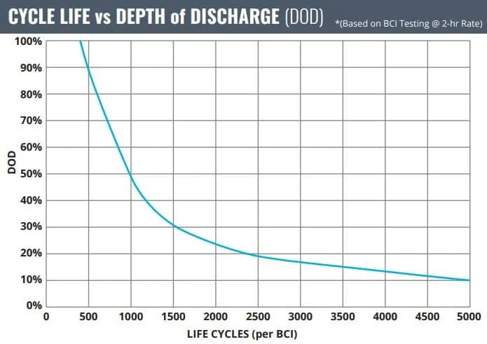

The rule of thumb with FLA and AGM batteries is to not discharge them below 50% SOC.
It's not as if 48% SOC will kill a battery, but the greater the depth of discharge, the fewer cycles the battery will provide. This is just an example:

11.7V is 80% DoD.
11.7V is 80% DoD.
