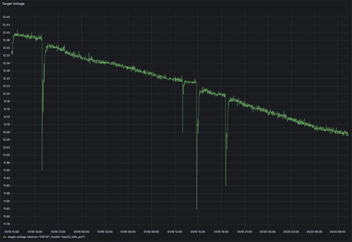

I"ve been monitoring my maverick the past couple of weeks, I don't drive every day, and it's cold out right now so it goes into battery save mode quickly (max 2 days). Most times it doesn't even tell me now. I come out the cabin lights don't come on. It's always started so I haven't really worried too much about it. But i've seen 12.1v being the cut off voltage, but not always, seems the truck has additional parameters it uses.
I did notice a couple of side effects of the battery going too low:
1) Brake Coach gets turned back on
2) My Oil Life reset on it's own, to 98% after 5812KM
Ford Maverick Why Does 11.7V seem to be magic number? 2026-01-20 10_19_45-Greenshot
Thats quite troubling if you are relying in ito be accurate. I'm not.
Ford Maverick Why Does 11.7V seem to be magic number? 2026-01-20 10_21_38-Greenshot
Here's my current battery stat since my last drive (3pm on the 18th), the drops are when I have unlocked the car and opened a door. It takes a while to recover, so some high current systems must activate and stay active for some time after opening. (the logging is from a customer built sensor, it is calibrated within 1.5% between 16v and 7v). And to the Fluke crowd, high-five, my best meter is a fluke 87 from 1988 (still going!).

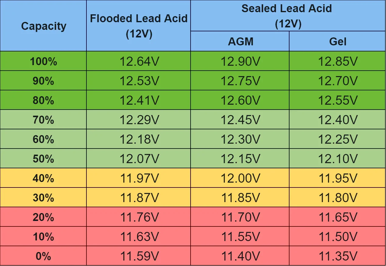

Ideally, FLA and AGM batteries should be kept at 100% SOC. Obviously that's not always possible, but Ford allows the voltage to drop as low as 9.5V in some cases!:
https://www.ford.com/support/how-to...y-does-my-ford-vehicle-enter-deep-sleep-mode/
'Battery saver' is activated at a much higher voltage, but still way too low.
The owner's manual does not specify voltage or SOC that triggers warnings. I got tired of searching. The best I found is:
"Ford's Battery Management System (BMS) triggers warnings based on low State of Charge (SOC) or voltage, often around 20% SOC or lower..."
20% SOC is about 11.7V -- which corresponds with some posts here.
Anything less than 12.4 volts (close to 70% SOC) risks sulfation, lower capacity, and shortened service life.
That can happen even when everything is functioning normally, which is why it is worthwhile to use a BT.
They can be wired so that the hood does not even have to be opened -- it can be connected using a 12V SAE connector. Quick and easy.
Ford has funny ideas about what 100% SOC is. They call 100% what real battery specialists would call 80%, so you're starting from a deficit situation at all times.

Great graph!
What is the 'brake coach'?
The OLM being reset is potentially a very serious problem for those who rely on it (as you said). We drive so little that I change the oil annually, but many owners *do* count on the OLM. That's something Ford should be made aware of.
That's all the more reason to use a BT (or Battery Minder). The closer a battery is kept to 100% SOC, the longer its life.
PS: I also have a Fluke 87! I worked as a train control tech for Metro (in D.C.) and we were issued the 87. I'm not sure of the year, but it would have been around 1988. That thing is all but indestructible! I only bought the 179 because the display on the 87 was getting dim.

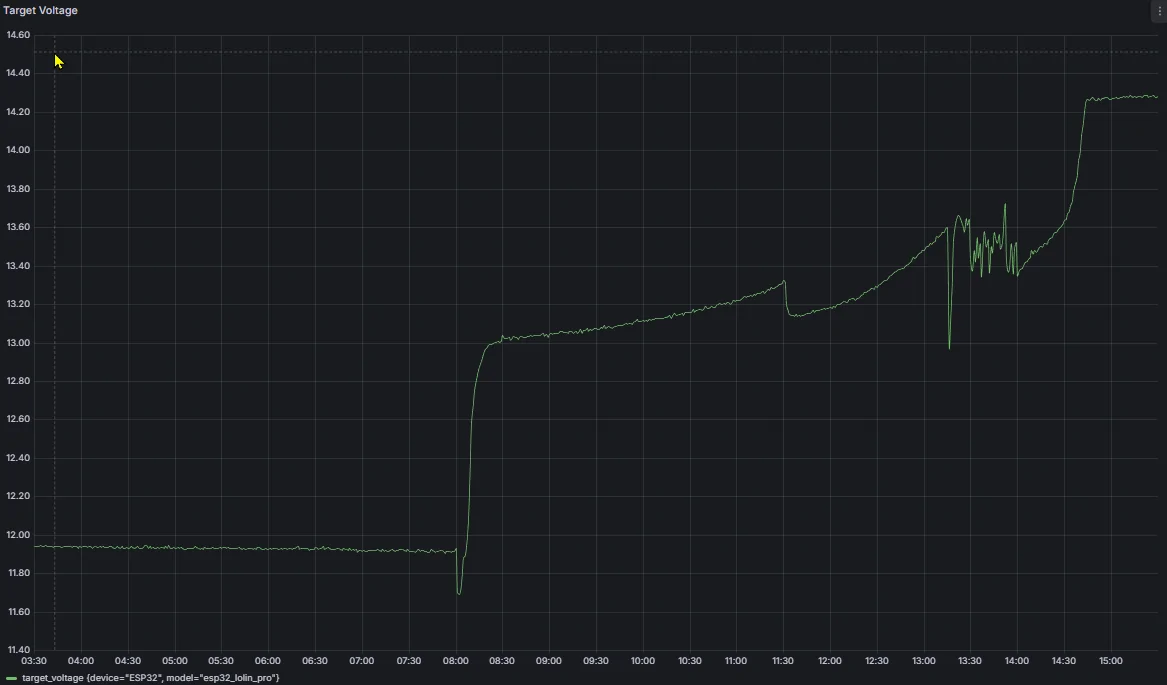

Well if you love a discharge graph, then you're going to love a 2amp battery charger graph lol.
Ford Maverick Why Does 11.7V seem to be magic number? 2026-01-21 15_29_53-yt-dlg
The dip before the rise was me opening the door. I haven't touched it since so the drop out at 11:30 and 13:15 are, interesting. Maybe the voltage go high enough for the truck to start turning systems back on, the 13:15 one seems to indicate quite a bit of activity. Either that or the charger is having fun, but it's a 2amp energizer charger, which will drop to a trickle when done so I don't expect anything odd from it.

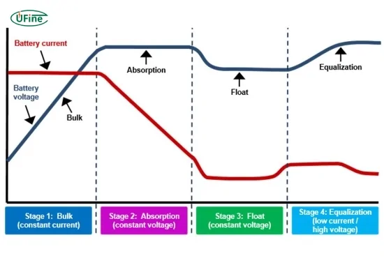

There's a lot going on with that graph, esp between ~13:30 and 14:00. I'm used to graphs like this:
Ford Maverick Why Does 11.7V seem to be magic number? 1769036615737-bx
Of course that's on a bench as opposed to a battery in a vehicle.
(I've seen better charts, I just grabbed that off of Google Images).

I'm wondering if you caught a BMS Relearn in there. Was it locked after the door opened?
Been 5 hrs since the door if it was locked, enough time for it to think surface charge since last use is gone. Maybe doing it's little measurements on a known draw.
