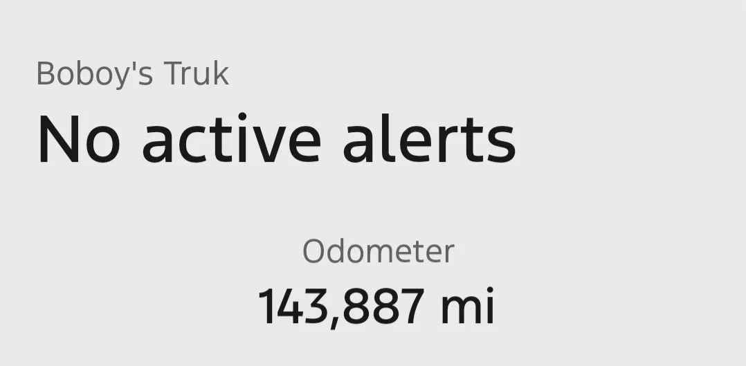

Details is in my signature below. I have an ongoing, intermittent DEAD HYBRID problem so I have a jump box ready when it happens. It's the battery cable connector.

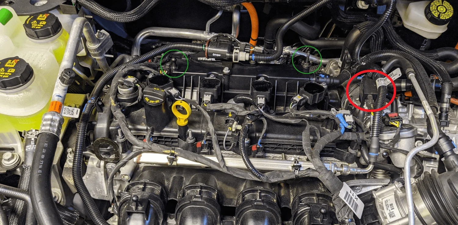

I was just wondering if it was a P0402. I had that one come and go for about the last 3 months.
Sure enough, same code.
CEL went on today, ran the scanner and resulted in P0402 code.
Internet search results in likely EGR Sensor issue.
Ordered replacement part through Tasca. JX7A-5L200-AD is the OEM part number, but part # RX6Z-5L200-A shows as the replacement. Specifically lists the Maverick Hybrid.
Will install myself since my local Ford of Boerne Service Center actually seems to hate customers.
Here's a photo I found online of someone who replaced it on their Maverick Hybrid with success.
Source:
Picture circled in red is the plug and play spot to replace the EGR Sensor.
Ford Maverick Who still has their Maverick purchased  new? 1778474371233-p1
Ordered part here:
https://www.tascaparts.com/oem-parts/ford-sensor-assembly-rx6z5l200a
Amazon has several too, but were not OEM (FoMoCo). Want to try the FoMoCo OEM branded parts first.
If this OEM part doesn't work, I will try the Amazon part. One positive Amazon review supposedly is for a 2024 Ford Maverick Hybrid with a faulty EGR Sensor; despite part number not listing Maverick specific.
I will post followup of how it turns out.
UPDATE:
I see several posts through MTC, especially @JoaquinF , that match this info and newer part number. Thanks!
I feel more confident in this upcoming repair attempt.
Also, updated post to specifically say EGR Sensor, not the valve. Thanks @rclee.

Just to be clear, @XL Hybrid Cactus Gray is replacing the EGR SENSOR and not the EGR valve. The sensor is the part pictured above. @Joaquin F has a link on one of his posts for an original FoMoCo part that is about $13.00 for the part and $14.00 shipping. That is a great deal!
