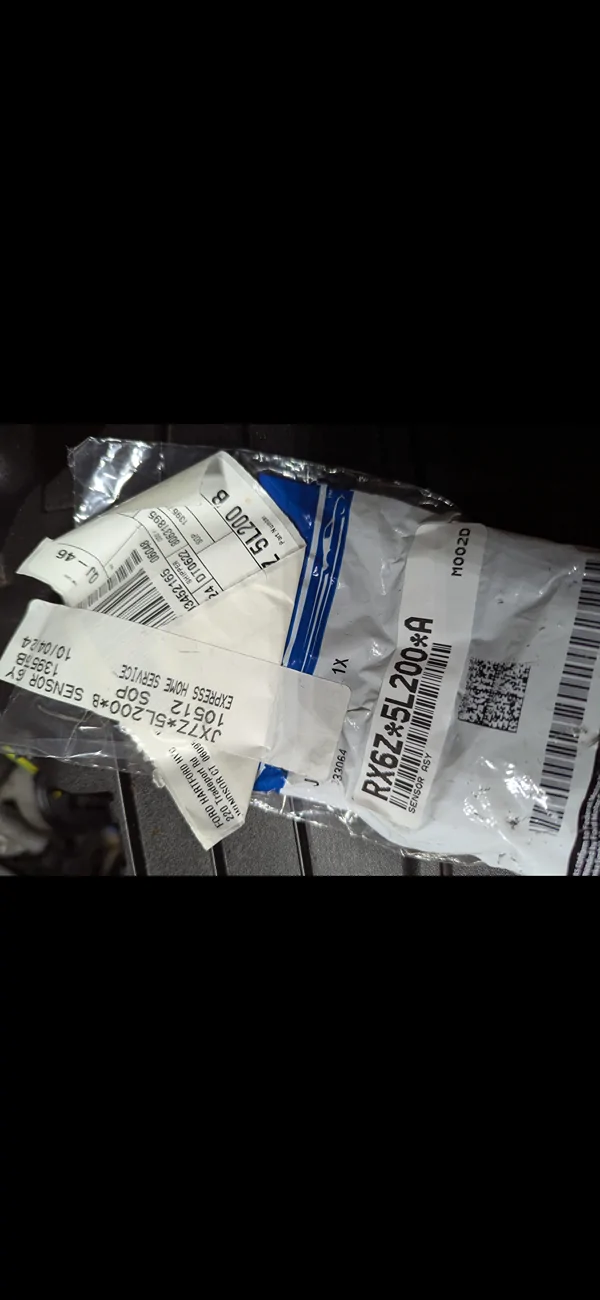

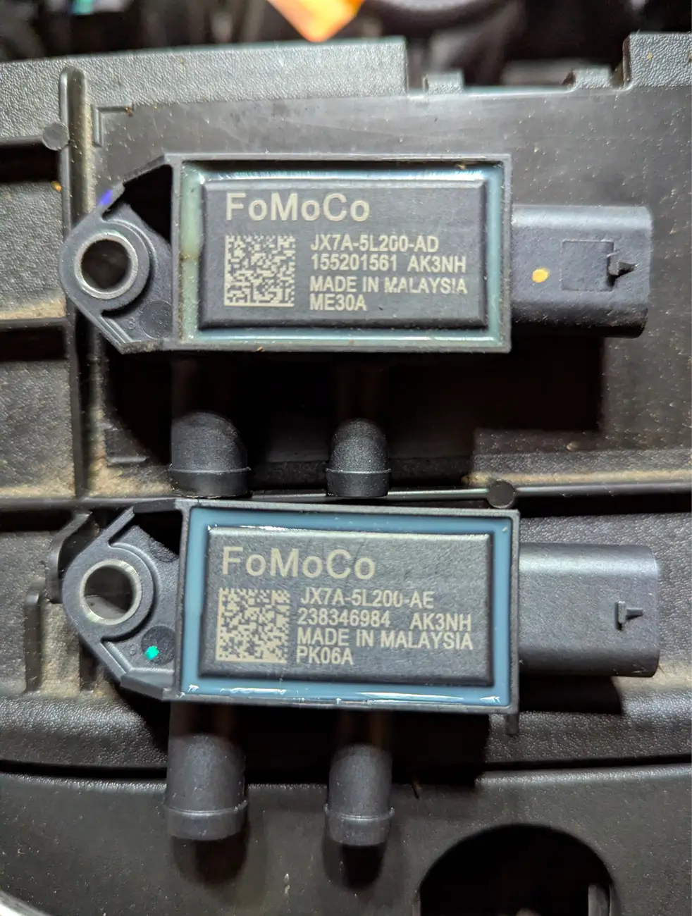

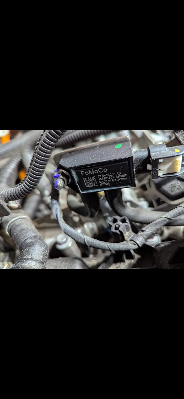

Just to be clear, @XL Hybrid Cactus Gray is replacing the EGR SENSOR and not the EGR valve. The sensor is the part pictured above. @Joaquin F has a link on one of his posts for an original FoMoCo part that is about $13.00 for the part and $14.00 shipping. That is a great deal!
UPDATE:
Replaced the EGR Sensor today, 5/18/2026.
Got the replacement OEM sensor from Tasco Parts.
Total $36.56 ($12.82 part, $21.43 shipping).
Notice, the part number has changed, but the part bag has both numbers on it.
That was reassuring.
Check engine light with code P0402 was just on again yesterday.
Took about 5 minutes to replace the old sensor with new sensor.
Needs a 10mm socket for 1 nut holding the sensor in place.
Unplug the wire harness and slip off 2 rubber hoses connected to its bottom.
The rubber hoses were very tight.
I used a small flathead screwdriver to carefully help pry the rubber hoses off.
Reverse process for new sensor.
The rubber hoses slid like butter onto the new sensor, easy.
Check Engine light is now gone.
Will follow up again if it comes back or has the same code.
Thanks all.

UPDATE:
Thanks all.
Awesome news, mine has a few weeks on it and P0402 free. I hope other Maverick owners see this post and save themselves time and money by fixing it DIY style.
Thanks again @Joaquin F
