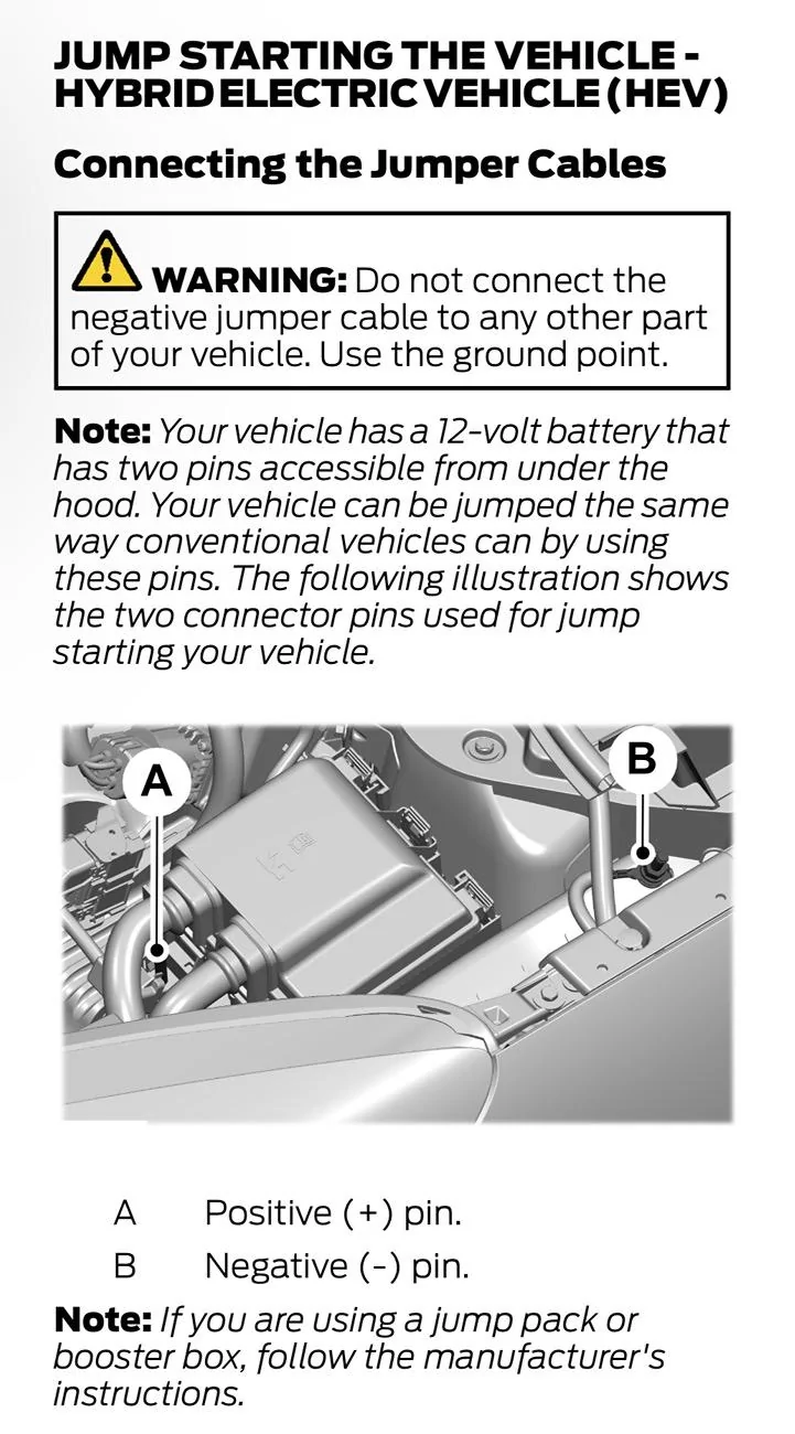

the easiest is to use the red jump post under the hood and find any unpainted bolt for the negative. don't directly connect it to the battery.
There is a “dedicated” bolt at the extreme right of the engine compartment closer to the firewall at the inside edge of the fender.

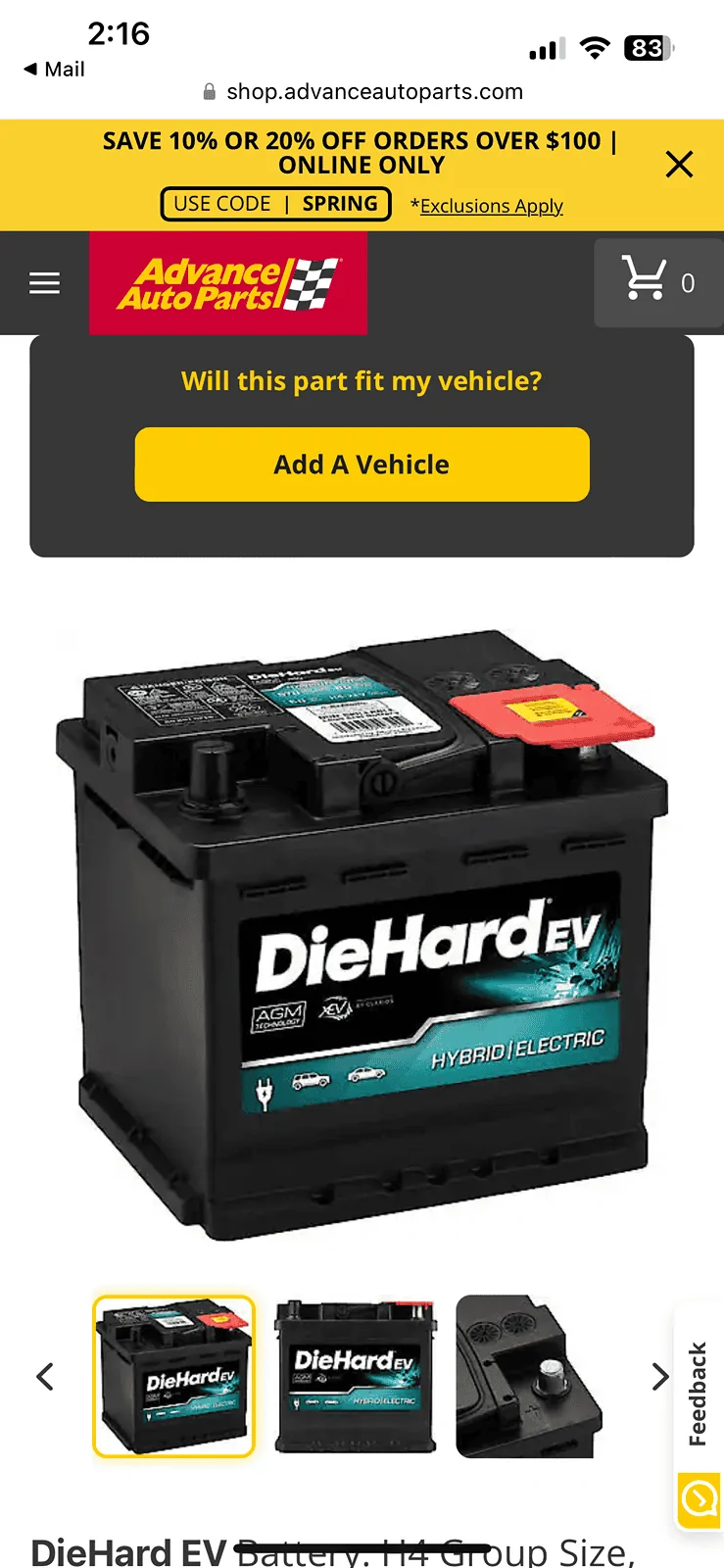

I'm familiar with the Die Hard brand battery replacement for the hybrids, but what's the AGM equivalent? Anybody got a brand and part number?

This seems to be a popular AGM option that fits

May I suggest that you just buy the battery. If you try the "select my vehicle" option, the Maverick doesn't show up as one of the vehicles it will fit. But it does, thanks to a lot folks in here who have installed it.
Thanks Curtis, will do. What group number was it? Older eyes having trouble lol.

It's crossed out, so your eyes are fine. This is what others have done. Measure the dimensions of your battery. Take note of where your vent holes are. Find an AGM battery (any brand) of the same dimensions and vent holes and your a winner.
Makes sense. And remember to reset the BMS, of course upon installation of the new battery. Thank you!

Sorry for the crappy pic. It's an h4 .... about a half inch taller than the OEM spec other dimensions are fine. The height is probably why it does not show up as a fitment for the Mav as already noted but, it fits fine. Many MTC folks have installed this without issue. I plan to do the same just as soon as my OEM piece of sh?t completely dies on me. Right now, I have to put it on my Noco Genius5 to get my dome/courtesy lights to work for a day!!!
QUESTION re: trickle charge a 2024 hybrid: I've looked in the owners manual, I've looked under the hood and I cannot find a red terminal cover under the hood or anything that looks like a post to attach the + terminal to a trickle charger. Could you guide me to it, it is probably hidden in plain sight but I give up.
TIA.
