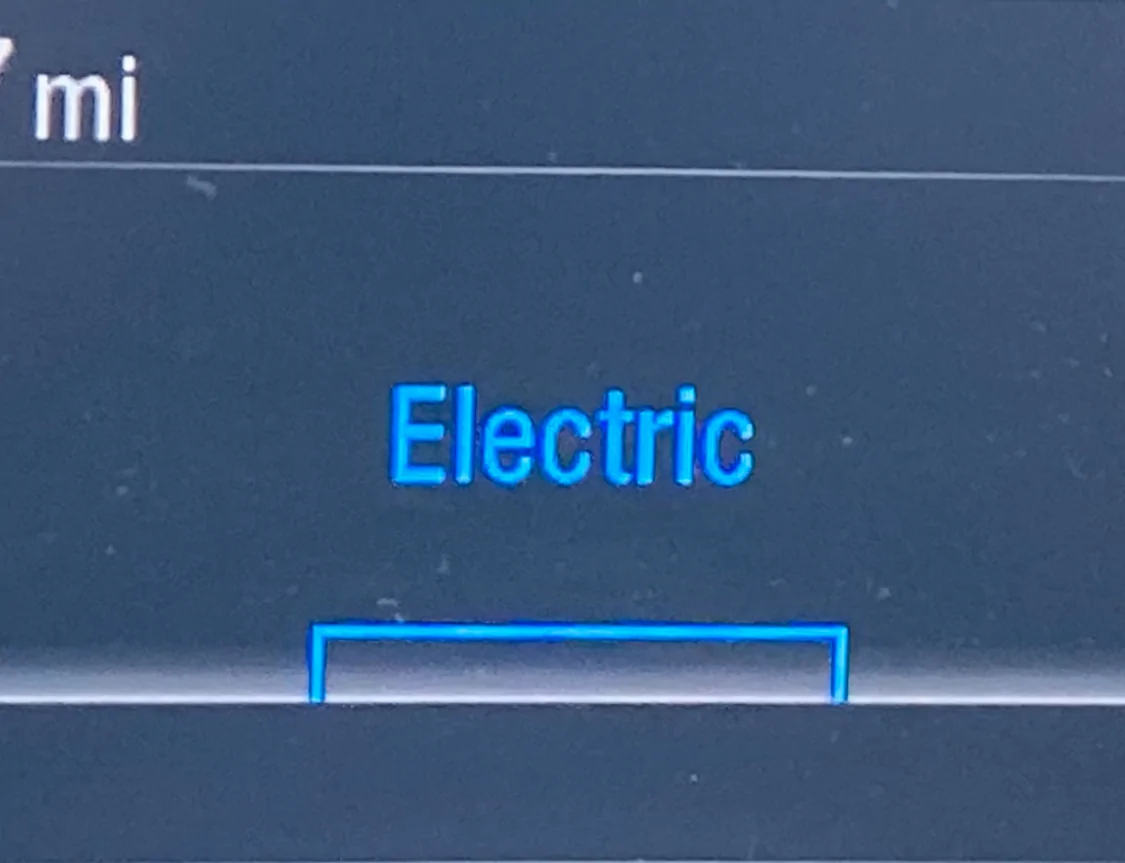

It is based on really high charge which usually happens only after a long episode of regen charging. Then you have to turn the truck off and back on. Then it only persists for several seconds. Easy to overlook.
But we do get double the EV power for a short time indicating they really don't want the battery to stay highly charged for very long.
IDK if I just wasn't looking for it before or didn't hit the right situation. Saw it yesterday, though situation was not something that had happened. Had to do a few errands, temps were few degrees below freezing, drives were short between stops, wind was enough to chill everything down again while I was at the stops for 15 mins. So it was running the IC for heat all the damn time, thus no bleeding down charge, and I was seeing big bar, but only for seconds as I set off and then it decided it needed heat again, gah.
I was hoping I put it to bed with a massive charge in and with temps just above freezing today, I'd get a bit of a drive out of it on a big bar, but nope. I muffed it. Had to go out and get something and turned accessory mode on, then didn't realise it didn't turn off when I fob locked it. Also seemed to go more than the 30mins ppl say it lasts because nearly an hour later when I got back in truck it was still on. Anyway, don't know if I wasted it all on accessory mode for long time.
That bar was for the HVB.
The screen in Accessory mode is the 12V battery.
You drained your 12VB for the time it was on, not the HVB.
Unless this was on your Lariat with push-button start - in which case there is no Acc mode, only Off, On, and Started. (see manual)
In which case it timed out from being On when fob left (should have), and merely brought up the last screen to be shown.
And it's up to 75 min on pre-25MY that systems may stay active, appears to be 60 min 25MY.

Well it calls it accessory mode if you button it with no pedal.
