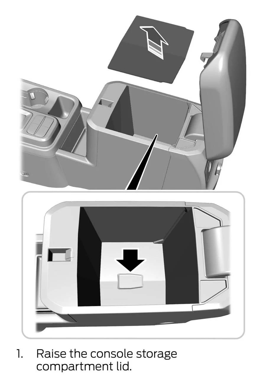

Open the center console and take everything out of it including the pad covering it's floor. There is an outline or recess to place the fob. When fob is placed there the truck can communicate without internal power at that location. The key in lariat is for emergency door access.
You may also have to use the jump postst under the hood if 12v battery is dead.
How / where is emergency key placed/used to manually START 2024 Mav Lariat FWD Hybrid when FOB portion is not working or is lost?
Is there a hidden mechanical/emergency key slot somewhere?

If you lose your key fob it's just like losing your key. It's gone you're SOL you're not starting your truck without a fob.
Joe,
What I'm going to try and help you with is if your key fobs battery is dead.
Go to your truck open your center console clean everything out if there's a liner that has to come out to and please take a picture of what you see.
To start a Ford Maverick Lariat with the emergency key, you need to access the dedicated key slot usually located inside the center console, insert the emergency key blade from your key fob, put your foot on the brake pedal, and then press the start/stop button to start the vehicle; essentially bypassing the keyless entry functionality when your primary key fob battery is dead or not detected.
It should look like this when the felt liner is picked up. 👇👇👇👇👇
