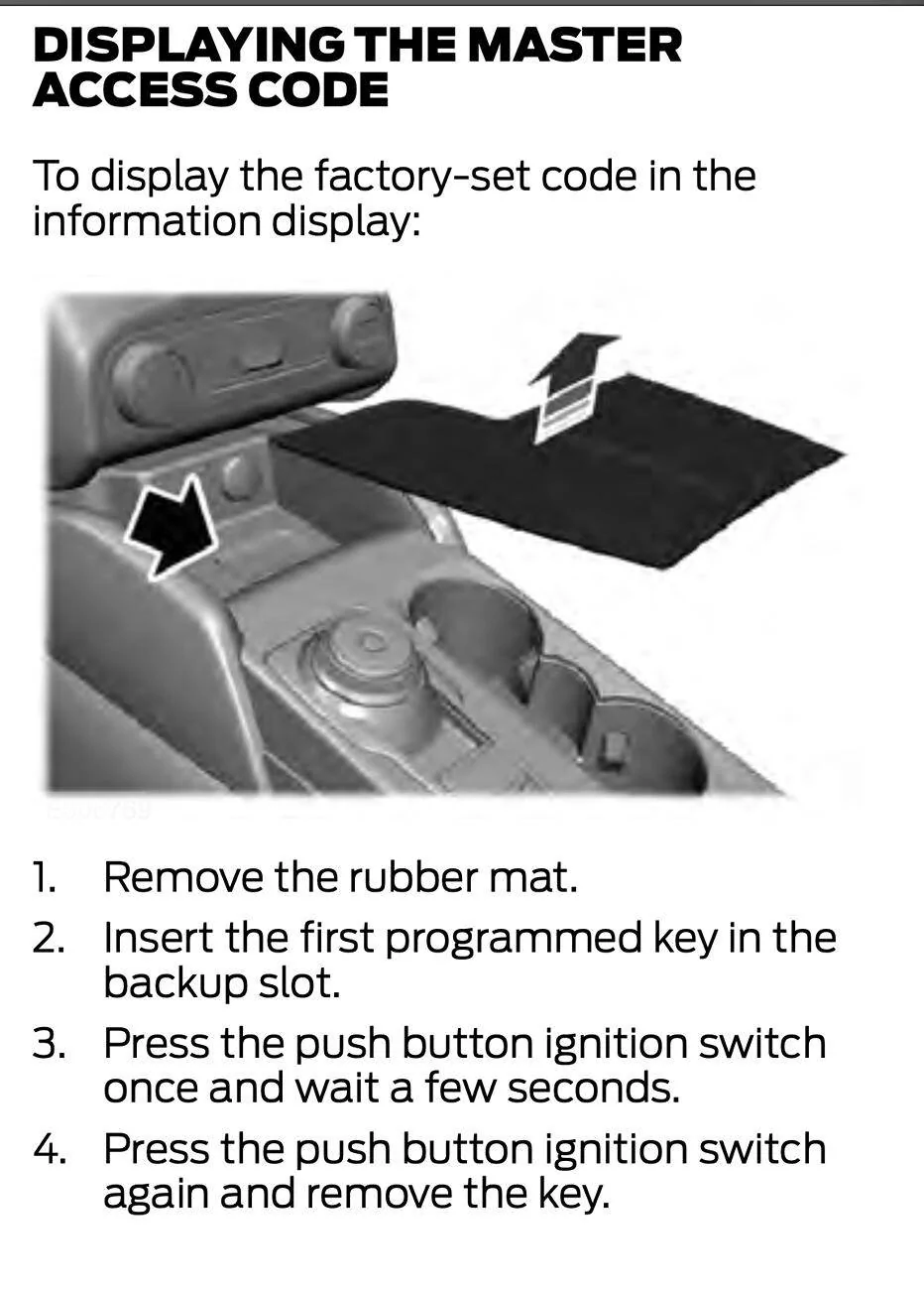

Then what is the one under the front next to the phone charger under the rubber mat?
That part is shared with other vehicles e.g. 2020-2022(+?) Escape that do have their backup slot there. For Maverick, they relocated the backup slot to the console bin but didn't spend the $$ to mold/produce a separate tray.
As seen from the 2022 Escape manual section on retrieving the SecuriCode master key but the procedure is similar for programming a third fob or to start the vehicle if the fob battery dies:
