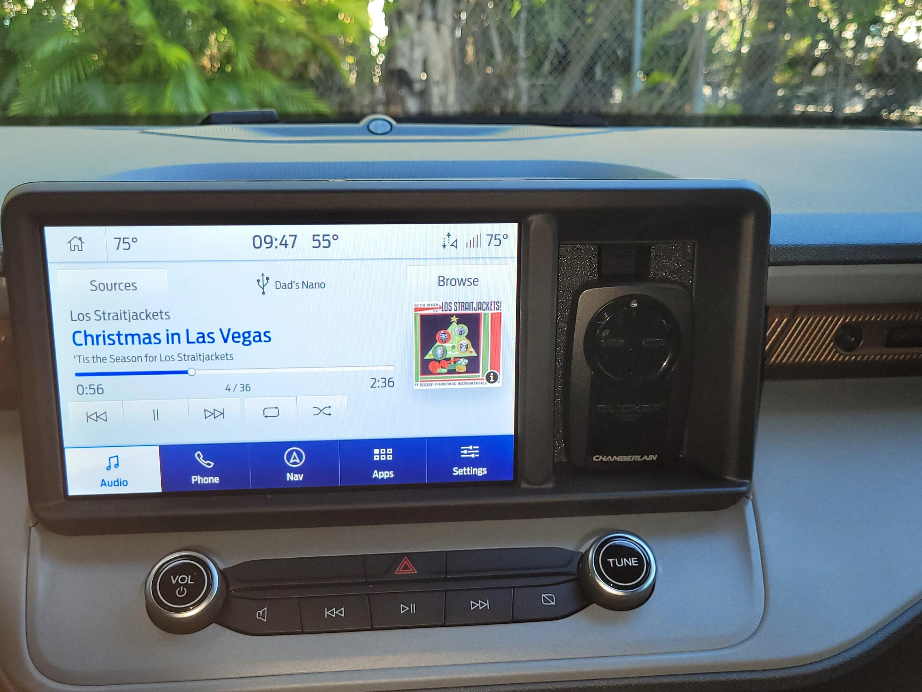

I bought a cubby drawer (etsy) and hang the opener from it. It's recessed just the right amount and gives something i can push against to push the buttons. Thankfully, my opener is kind of small.
very nice, looks like it came from the factory like that.

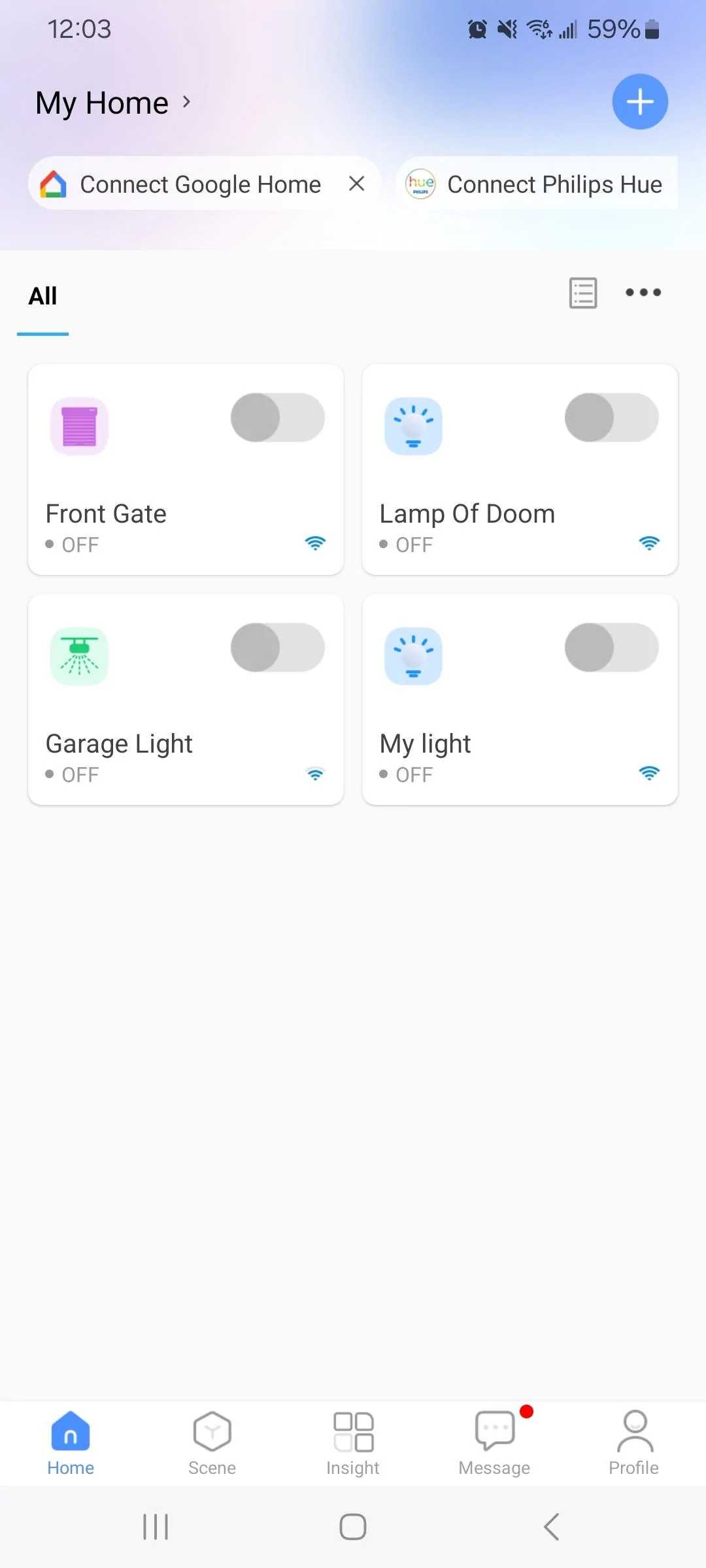

Not a garage door, but the entry gate is only in my Maverick when I have my phone... but it is always with me in any vehicle.
I use eWeLink.

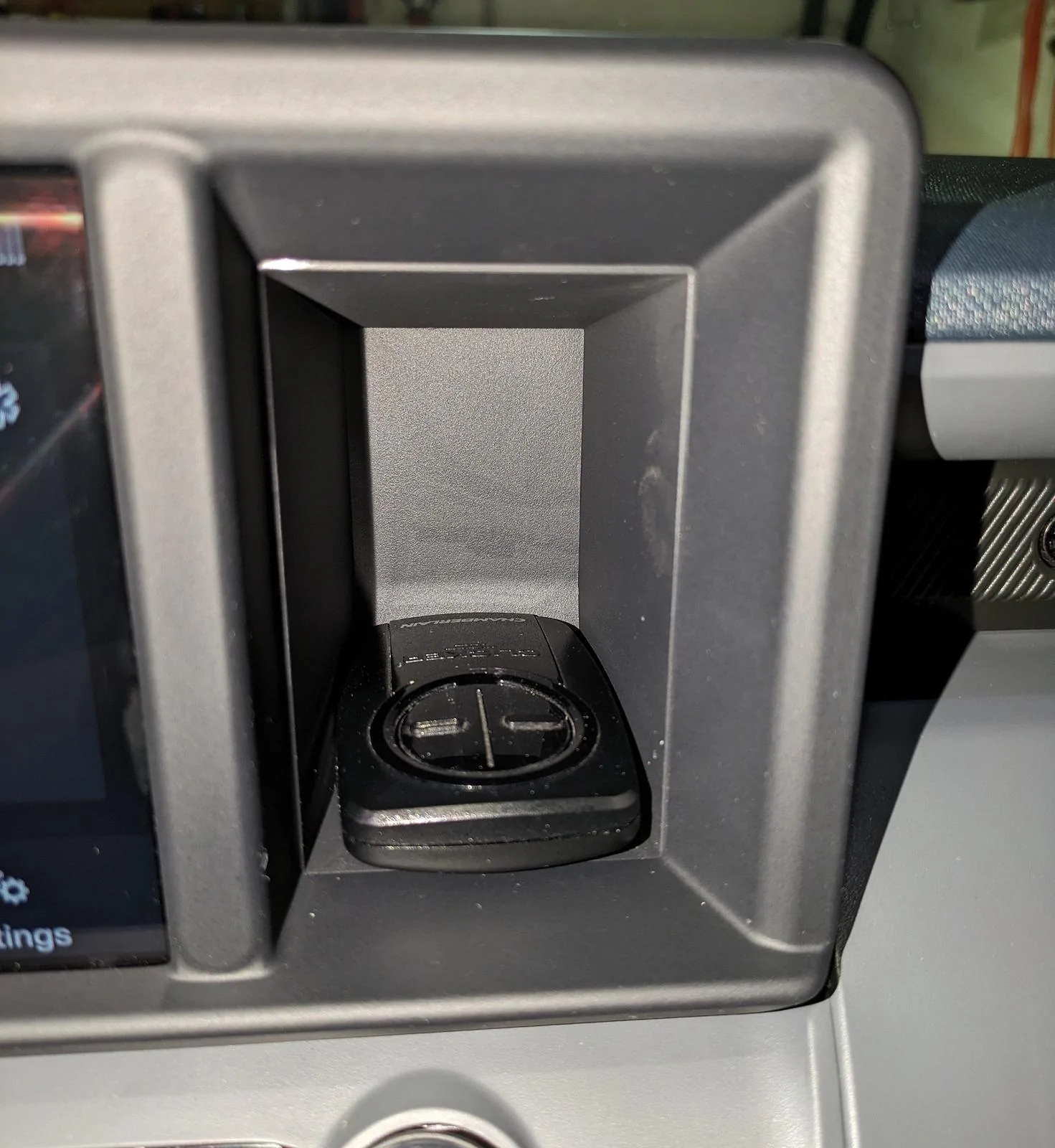

I bought this style of Liftmaster remote and put it in the cubby.
I've had that remote for years. First thing put in the truck when I brought it home early this week. Perfect fit, it's like the dash cubby was designed for it.

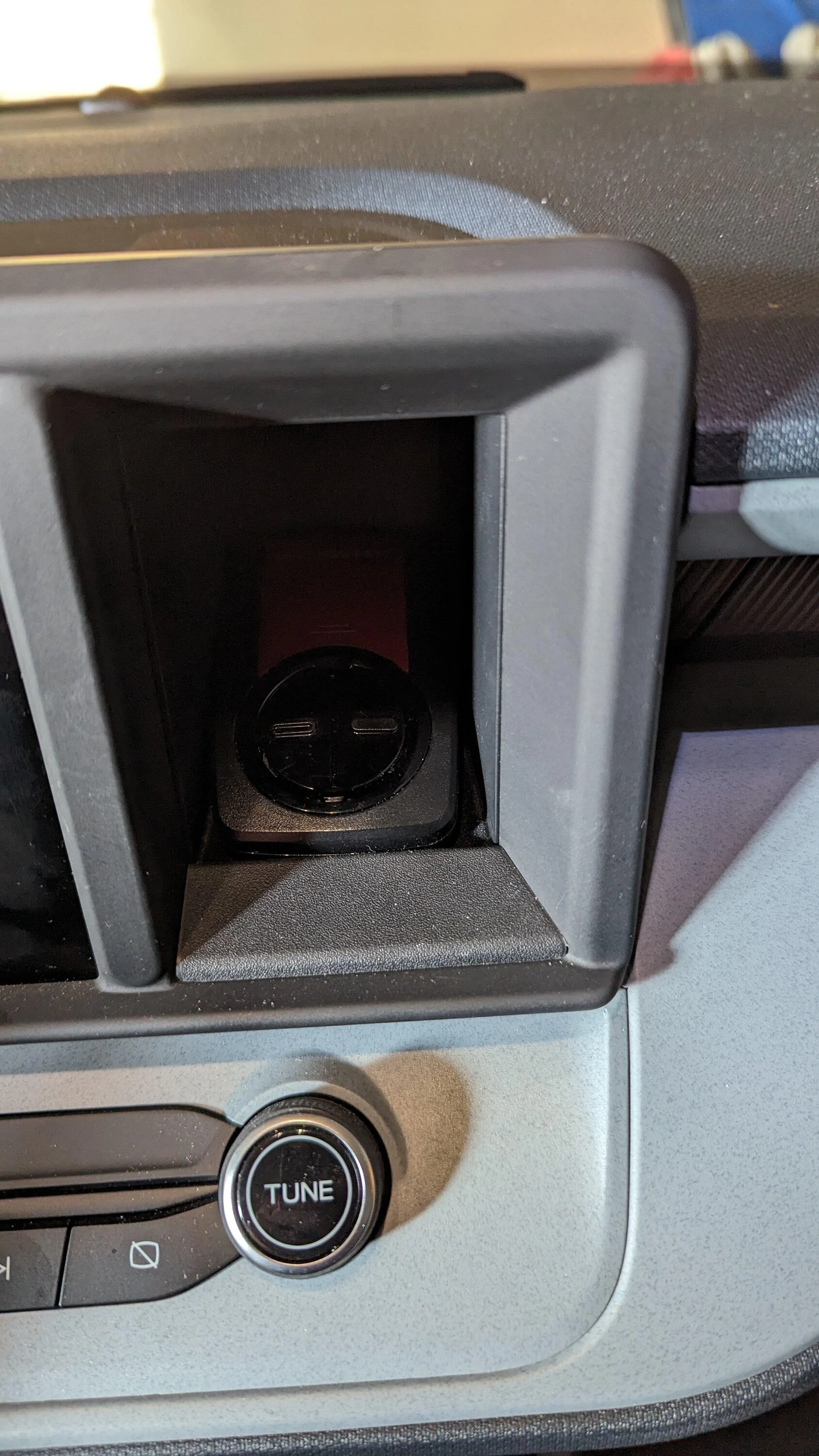

I had been keeping my garage door opener where it seems most of you keep yours, the little square hole near the cup holder. But, at night, it was hard to find and with no light at that time, it was hard to use. So, I moved mine up to the 2.5"X4" hole to the right of the GPS screen. I used one of my wife's unused pot holders, and just clipped the opener on it and stuffed it into the hole. It is a perfect location, out of the way, and easy to find and reach. The problem is, it's temporary. I need something more permanent. Something that fits the decor a little better. Maybe a 3d printer can print a soft plastic hinged device that not only will fit, but looks good. Maybe utilize the space behind the opener for a coin holder or plackers or something small. I'll be the first customer for a permanent solution. I would like to send a pic of what mine looks like, but I am not good at posting a pic except on certain chat groups.
I took someone on this site's advice and bought a little box from Etsy ($25) that was made for the cubby hole, and mounted my opener on it. I consider it a temporary fix, but it works fine, The box is unusable for anything else with the opener on it. I know that down the road Ford will come out with something for that cubby hole. Then I will have to find a more permanent solution. I like to keep my cars and trucks as factory as possible, so I am reluctant to change the rear-view mirror.
Um how did you get your infotainment screen so bright??

I don't think I did anything - that is the way it has always been.
That is probably the same one I have too. A little difficult to remove with the opener there, but not impossible. Might be a good place to store some seldom used smaller things.

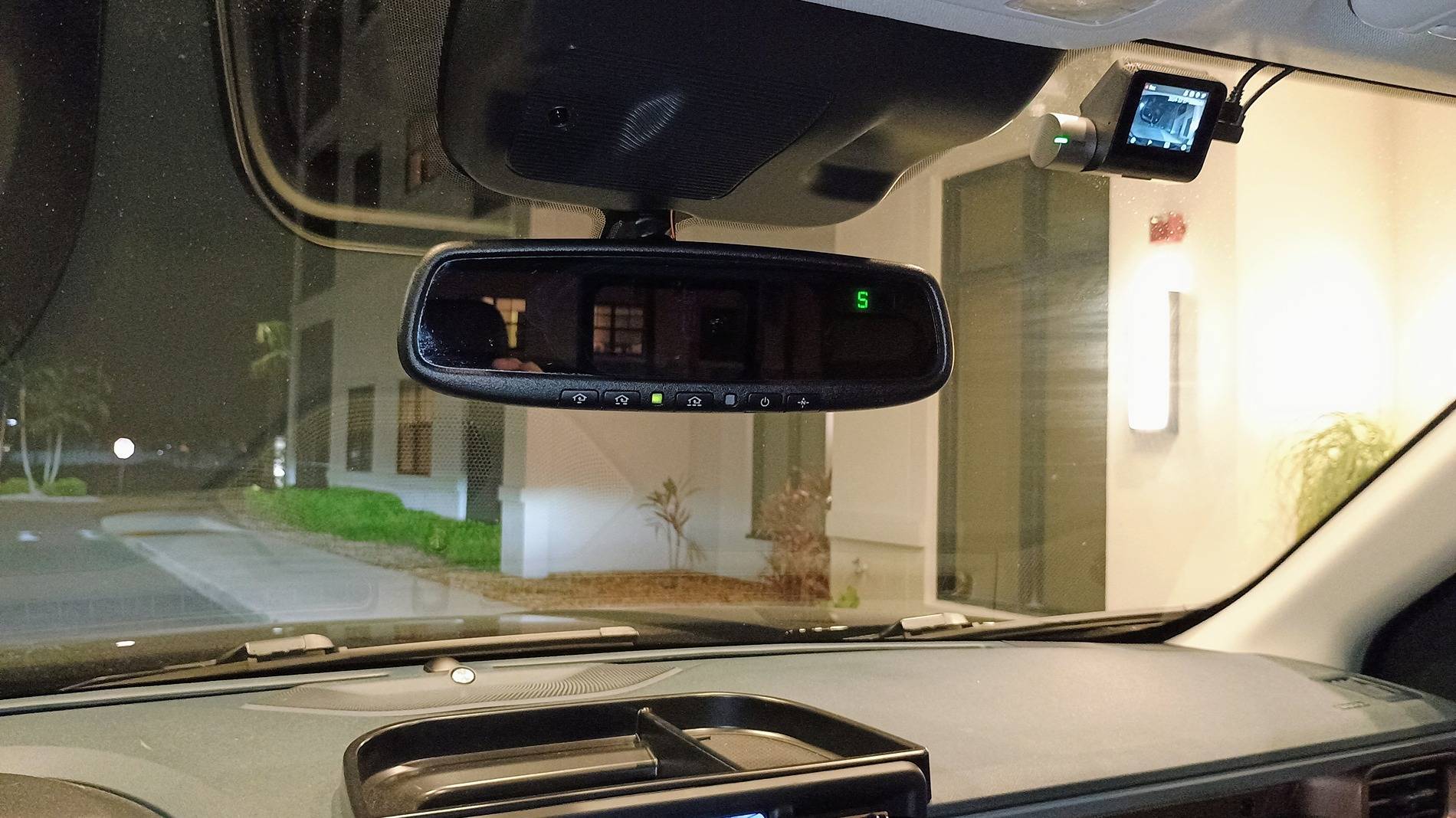

I installed a Gentex mirror from Bob's Mirrors. They usually have specials that are discounted and will work in your Maverick. I emailed them about the particular special that was $39 and they confirmed it would work in my Maverick. I ordered the long cable to connect under the dash. They give you instructions. I tapped into the connection for my dash cam. Bob's provides the quick-connectors, so it was easy and took only a couple of hours total, including programming the Homelink. You have to pop off that housing behind the mirror. I used the plastic trim tool that came with my dash cam to pry along the edges and pop it off after confirming that works by watching a Youtube. I only have one garage door to open, so I programmed all three buttons to the same opener as it is difficult to see the actual buttons on my mirror in dim lighting.

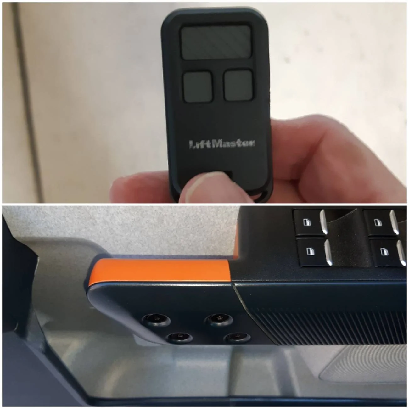

I mounted / concealed my mini remote within Reach on my driver's door.
