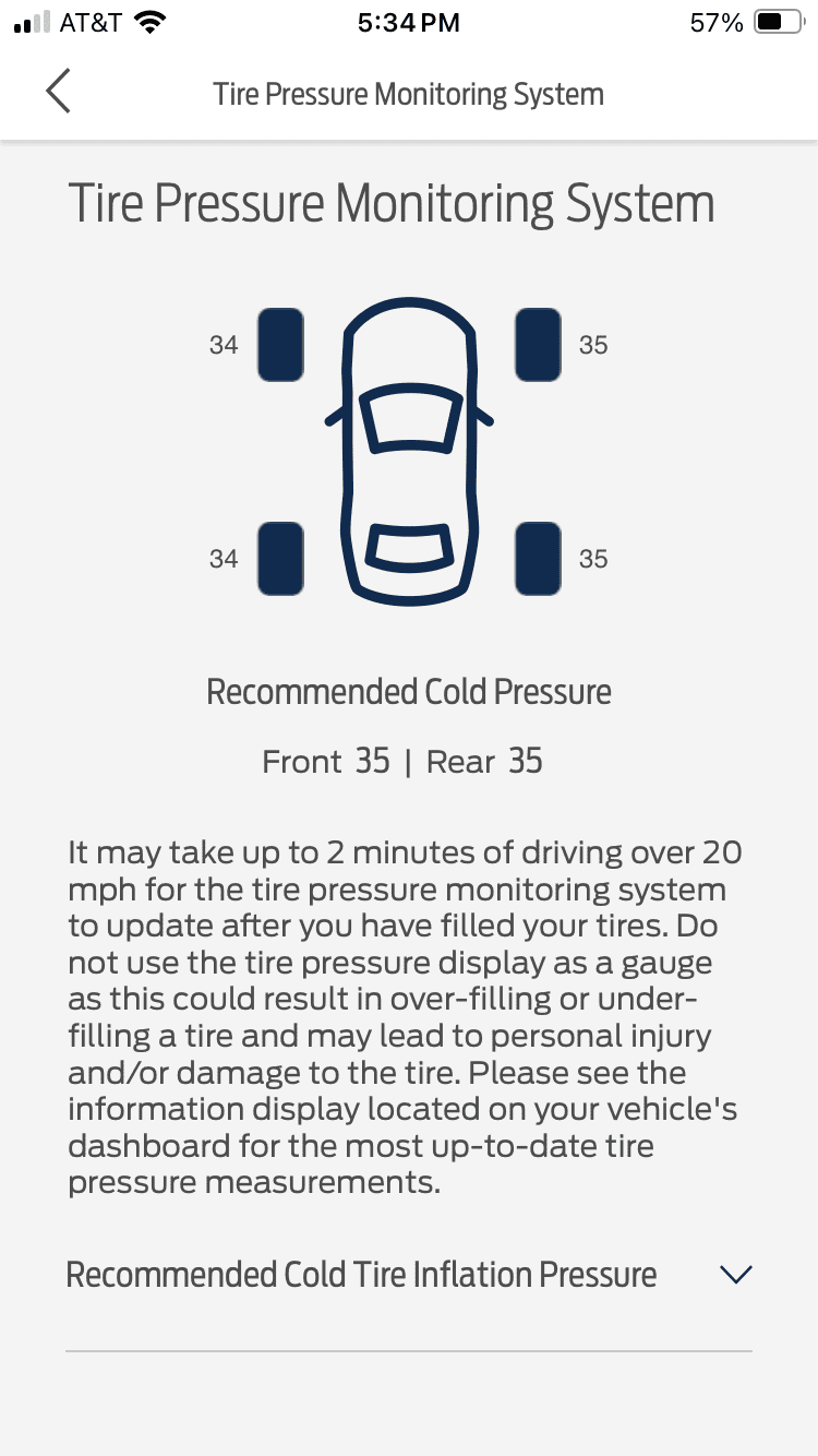

the tire with the nail was fixed, and it and my other XLT rims/tires are in the shed behind the house, I swapped them for steelies with tires on 12/1. All 4 tires now on the truck have 35# of air in them, but the truck and Ford pass still shows the right front being at 31#, and the others at 33-34-34, these numbers haven't changed since doing the wheel swap. Plan is today after work to stop back at the tire shop, have him come up with his TPMS tool, but I'm going to put the truck in training mode again and see if I can get the truck to recognize the new wheels/TPMS. Have a TPMS tool of my own on the way also........$20 from Amazon

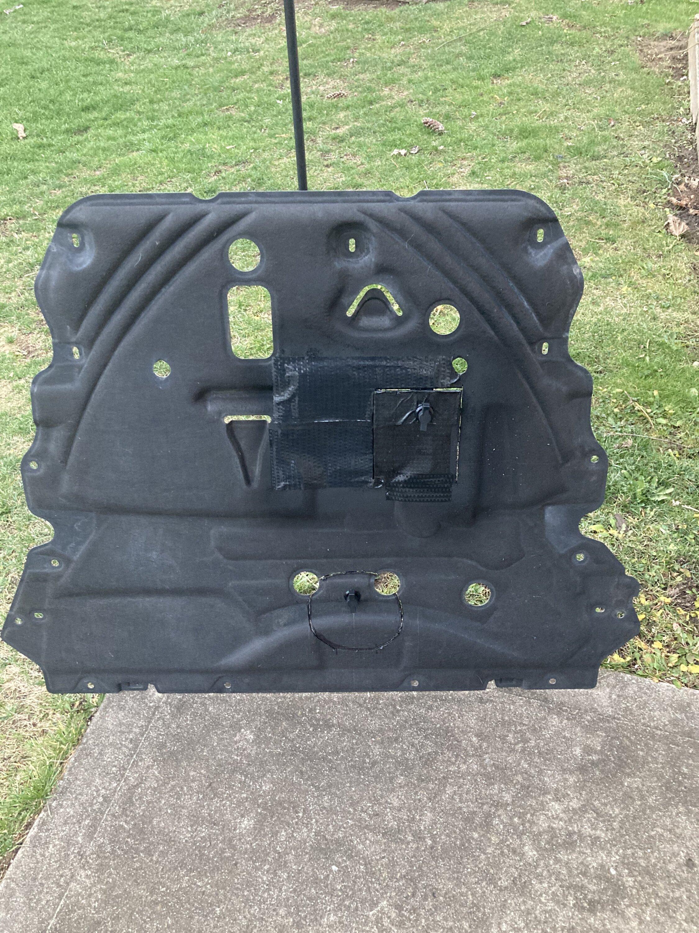

The steel wheels have been reprogrammed to the truck using the method for a tpms tool to get the truck into learning mode. Wasnt sure if the 5 min drive from the shop to the house would be enough time for FordPass app to pick them up but checked after parking and all shows good. Also put the engine shield back in the truck with oil change access doors cut into it. Phone was in truck so didn’t get pic of the shield installed
