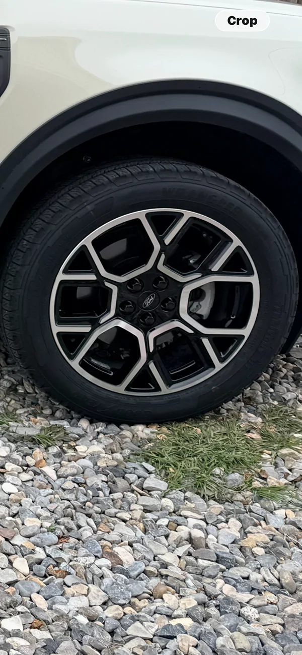

I have a set of the same 19s with the machined/silver face if you care to swap?

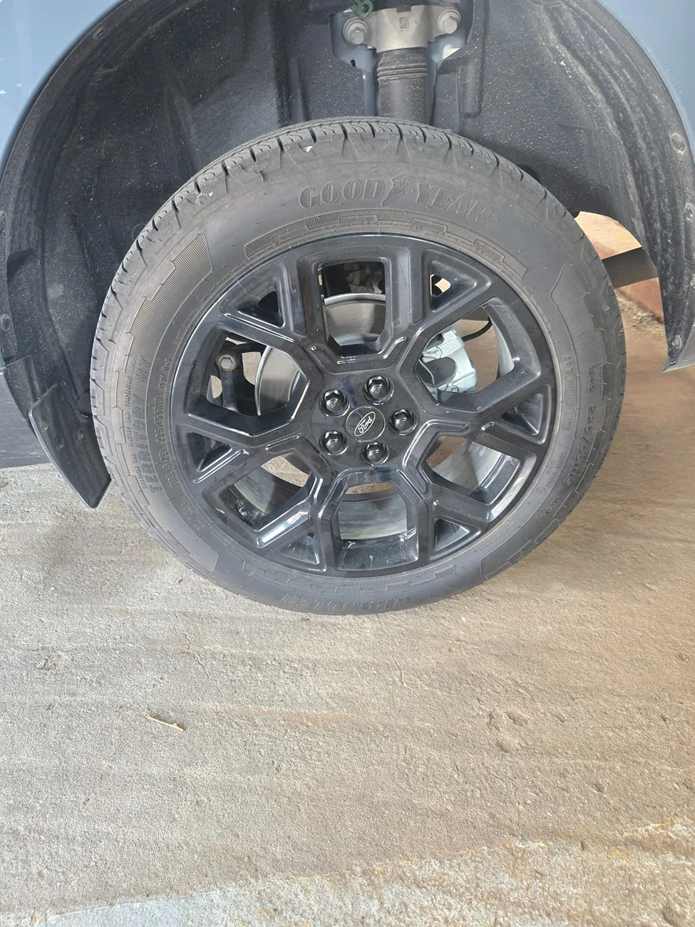

Can i see a photo of them. Here is mine.
Ford Maverick Wheel question. 20260529_151019

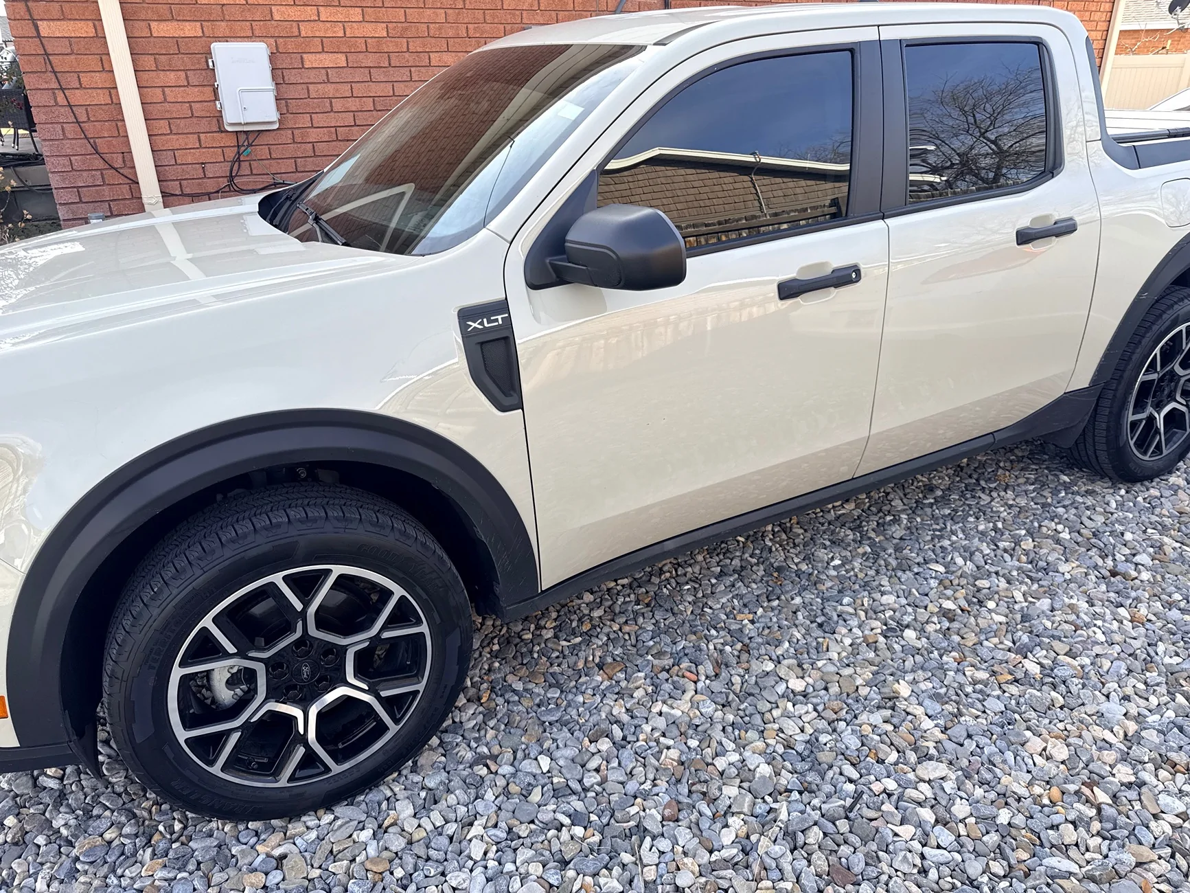

Absolutely. You can keep your tires as well. I have a new set in storage. These have 4977 miles on them, good wear nothing uneven or cupped.
Ford Maverick Wheel question. IMG_3332
Ford Maverick Wheel question. IMG_3072

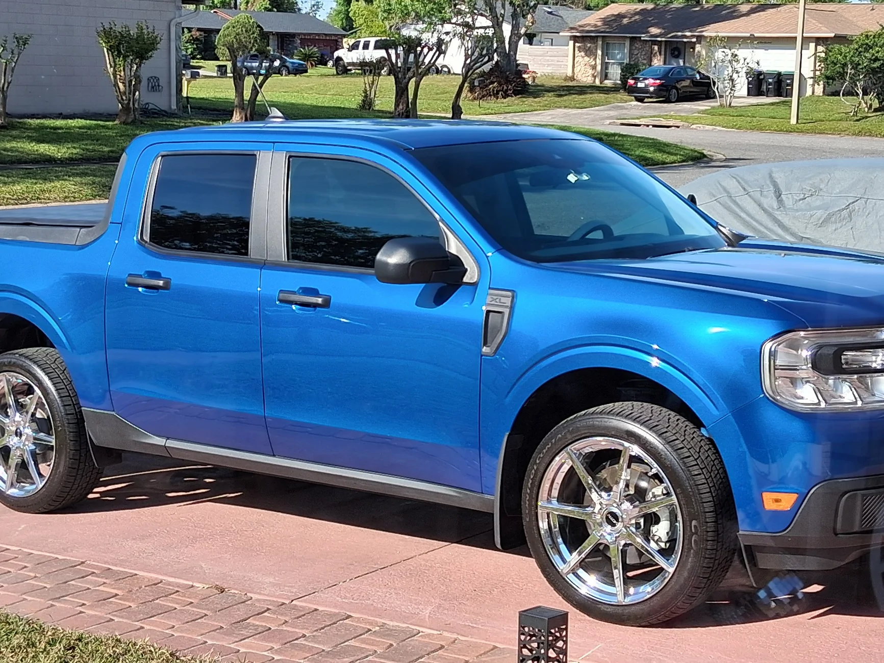

I Got these from discount tire on my 23xl ,40mm offset. No problems. Discount can order any wheel you find
https://www.walmart.com/ip/Motiv-20...MIvbOY2oXigQMVTmhMCh1oyA5XEAQYByABEgKECfD_BwE
Ford Maverick Wheel question. 20250326_094923
