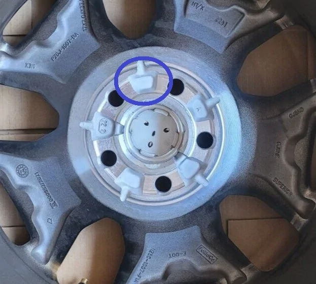

Careful with 25mm (1“) spacers on the rear. They ..may.. be too short and allow the stock wheel studs to contact the back of the wheels and prevent the wheel from fully seating, though the factory wheels do have pockets on the back of their hubs that accommodate some of the stud poke.
You need to remove the wheel in question and measure the stock stud length and do the math.
good luck.
Here are the pockets discussed above. Measure the length of the studs, and if longer than the thickness of the spacer, the extra length would go into these pockets, if deep enough.
Also, when looking at spacers that use a 2nd set of studs, make sure they use the same size stud, which is 14mm x 1.5mm pitch.
