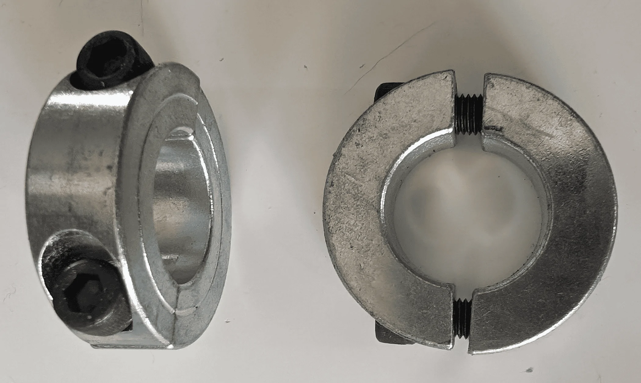

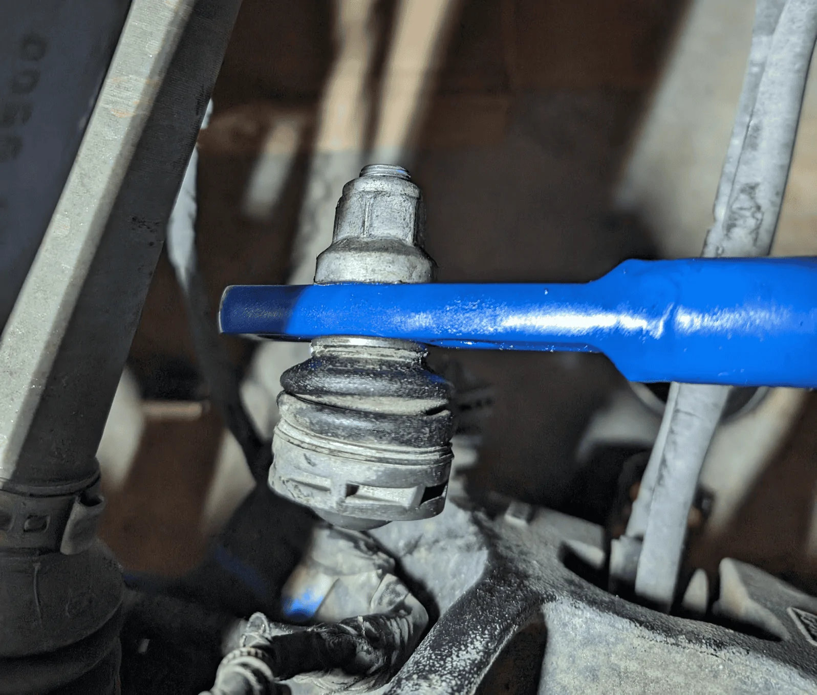

I just installed the Steeda rear anti-sway bar (link to product) on my 22 AWD Maverick. The installation went well, but they included 2 metal rings in the box and I can't find information on them anywhere. From the Steeda and YouTuber install videos, there doesn't seem to be anything mentioned. They look like they are spaces for the control links, but I'm not sure if I could even put them in if I wanted.
Pictures of the rings are below, as well as the mounted bar. Please let me know if you know what they are for and/or if I should try to get them installed.
Also, if you're looking at installing a rear sway bar, it's been great! You'll defs need a T50 & T40 socket to remove the bolts on the control arms, and I highly recommend lowering the exhaust to help with removing the old 1.
Rings/Spaces:
They are about the width of the bar and have 2 set screws.

Installed Bar:
I don't think there is enough thread for the spacer here, but it might go on the bar itself???

My guess is that they go on the bar, either inboard between the two bushings/brackets, or outboard on the outside of them to keep the bar from moving laterally (left or right) and contacting parts of the vehicle it shouldn't. I know that's a concern with aftermarket sway bars in general on other cars. A quick Google search reveals this thread from an Explorer forum which looks like it supports that thought.

The bar I have doesn't have nubs to prevent it from moving left to right. These "shaft collars" likely go on the bar, next to the anchor points to prevent it from shifting left/right and hitting the suspension/springs

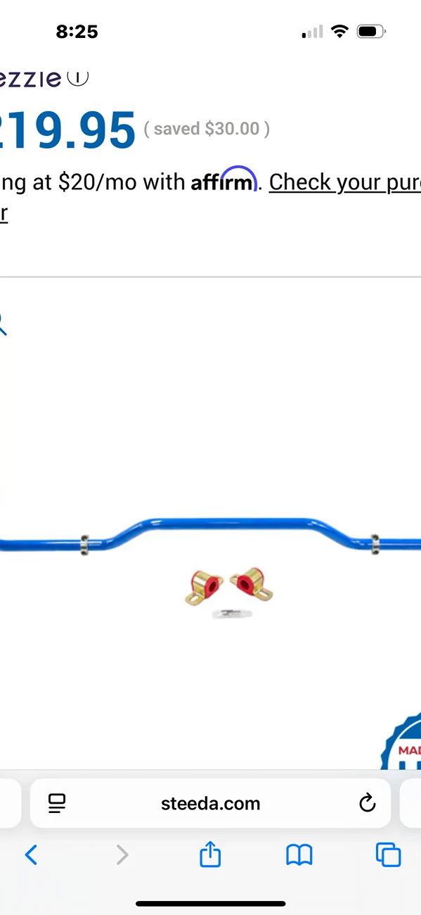

funny enough I recently installed this and had the same problem- saw this post. The spacers act as a weld stop. I don’t think they are necessary. In fact I installed mine where they are supposed to go and they were getting caught on the corner of the bushing. I could have moved them over but just took them off. No issues. have been checking the set up. Attached is a photo I found from Steeda.
Ford Maverick Steeda Rear Sway Bar- Spacers??? IMG_7396

Following up here. I did a bunch of research and it looks like Steeda changed from weld stoppers to clamped collars. This was intended to remove week spots and pressure points that cracked some of their other bars.

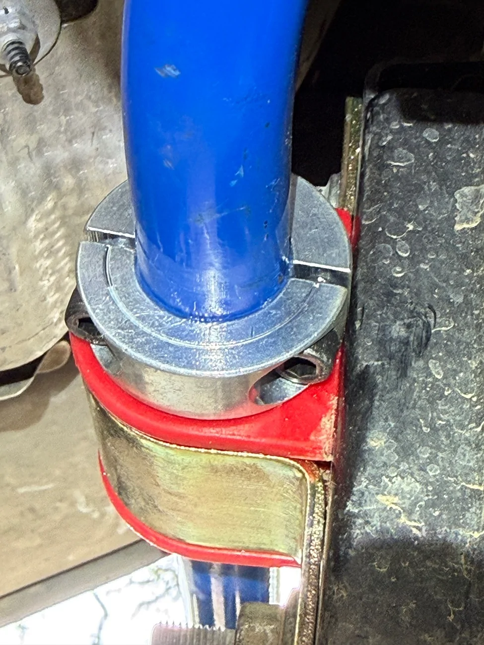

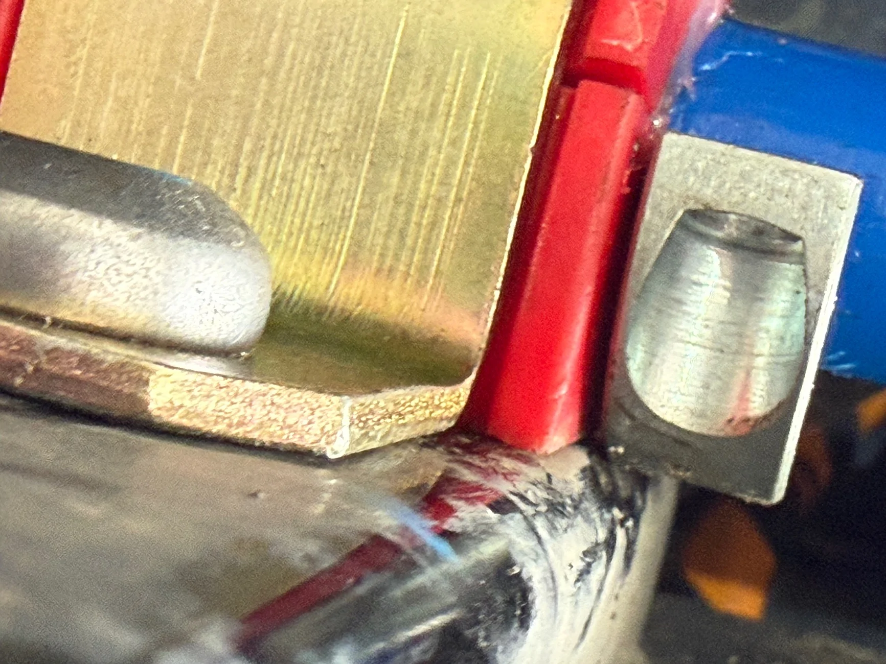

On my install, when putting them on either side of the bushing they make contact with the subframe. They seem to be slightly too large of diameter. Disappointed, seems like a poorly executed work around to the other issue.
Ford Maverick Steeda Rear Sway Bar- Spacers??? IMG_4750
Ford Maverick Steeda Rear Sway Bar- Spacers??? IMG_4751
