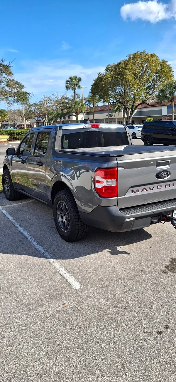

With the 8 inch rims, offset, and bigger tires, it pushed it out enough were i dont need spacers. At least to my likings anyway
Ford Maverick Wheel spacers for rear 20260228_153754
