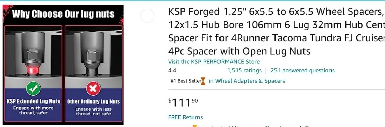

What are ya? A Bora employee?
BTW, my spacers cost $111.90, your price quote was off. I still have the invoice.
Ford Maverick Wheel spacers for rear Spacer bill 2026-05-16 223647

That is Car Talks opinion of KSP, not mine. I chose them for the shocking blue finish that matched my truck.
I logged in to the Bora site. No mention of counterbore depth.
Motorsport-Tech Custom Configurator
page ID = config_GetAftWheelSpecs.html
Vehicle: TOYOTA Tacoma_4x4_(1995-2023)
VRN (for internal use): 5296
Stock/OEM Bolt Pattern: 6x139.7mm
Stock/OEM Centerbore: 106mm
Parts Material: Alum
Vehicle Type: truck
No mention of counter-bore or cone depth. That is why others have warned to check fitment, with examples, before installing. There wouldn't be a need for this if the dimensions I mentioned before hand.
You said "Point to just one single failure of a U.S. manufactured Bora spacer, just one.."
I rejected a set of Bora spacers in 2022 for a reason not yet mentioned here. The cone seat for the nut had scratches on the spacers. I wiped a thin layer of grease on two of the cone seats and installed and installed the spacers using the other studs. I hand tightened nuts on the two greased cones, then tweaked them with a socket. I removed all nuts and spacers. Upon inspection of the of the two seats, I found no grease on the smaller diameter of the cone with thicker grease at the large diameter of the cone. The nut had a scratch around the bevel at the contact point of the small diameter. I'm pretty sure that the spacer did not have the proper angle on the cone. The scratches on the cone were due to a dull cutter or high-speed machining. It was overlooked by QC if they have such a thing, probably do. I set them back.
Short story for those that want to install safely and correctly. Torque the nuts on the spacer, then remove 2 nuts at random per wheel to see if the nut is scratched at the top or bottom. They shouldn't be if the 2 beveled surfaces mate properly.
China parts are for the most part as good as or better than US made parts. US manufacturers made the foreigners what they are today by outsourcing overseas to save a buck. The Chinese filled the manufacturer's need. Vietnam is now getting in the game - good products cheaper price.
I'll buy parts where I darn well please, thank you.
IMO, this thread covers a lot of the nuances of spacer use.
I was watching TV with my wife in the middle of this. I apologize if I didn't see pertinent info that I should have considered.
Forgot to mention: I forgot to mention that when I use grease to do a fitment check, I thoroughly clean the nuts and threaded surfaces to use the recommended torque values. Lubricated threads used with the recommended torque values result in overtightening which could cause the stud to break or the threads to strip. There are calculations to obtain torque values for lubricated threads, but I won’t be bothered with it. It’s quicker to clean them with carburetor or brake cleaner.

"China parts are for the most part as good as or better than US made parts." Another ridiculous, blanket statement . :cwl::cwl:
And you purchased a set of (4) junk Chinese wheel spacers for $111 TO INCLUDE SHIPPING....
For anyone questioning the validity and merit of your posts on this topic, you just 1000% removed all doubt... Thanks for that.
