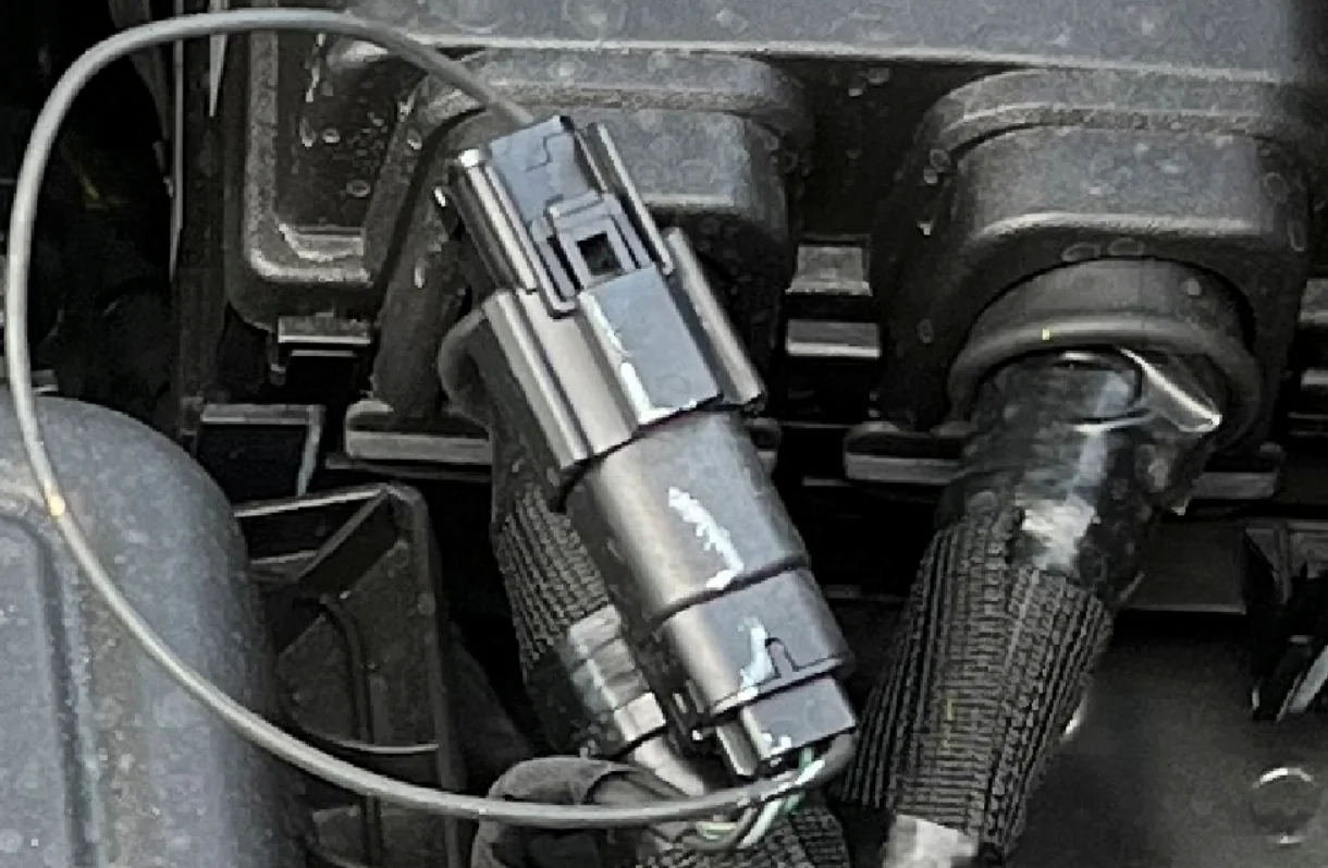

I was looking under the hood of my truck mostly to check fluids when I realized this plug. What is it for? Possibly something for the hybrid models?
Just curious thanks! 24 lariat eco

I have one just like it. It's likely for some option we don't have.

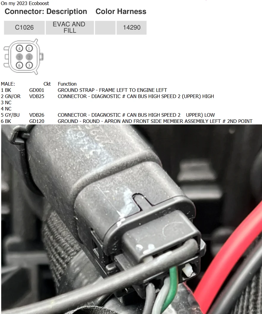

Heater core for Canada????
EDIT: Block Heater
TY @Meeka

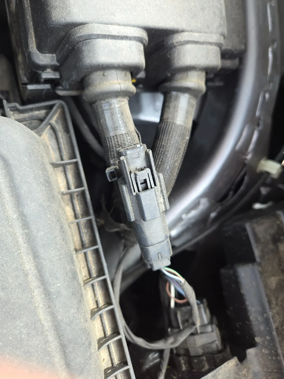

I don't believe you would find something for a hybrid under the hood of an EcoBoost. I don't think they share any mechanical components there other than the wipers and heater core?

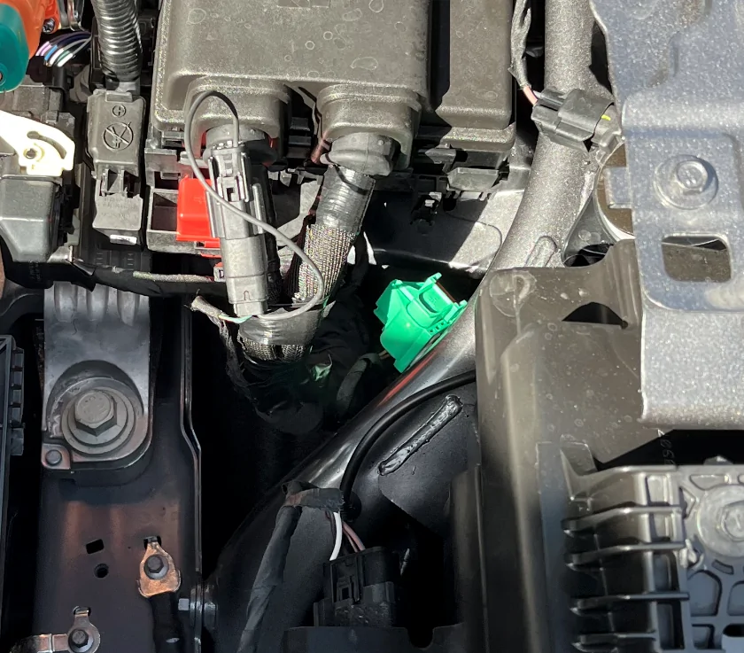

Do you mean block heater? šŸ˜‰ I’m in Canada and could have ordered mine with a block heater but didn’t, so close to the 49th don’t get that cold, Garage parked. Besides, looking at my ā€˜loaded’ 24 EcoBoost FX4, I still have a few of those ā€˜unplugged’ connectors. šŸ¤”
