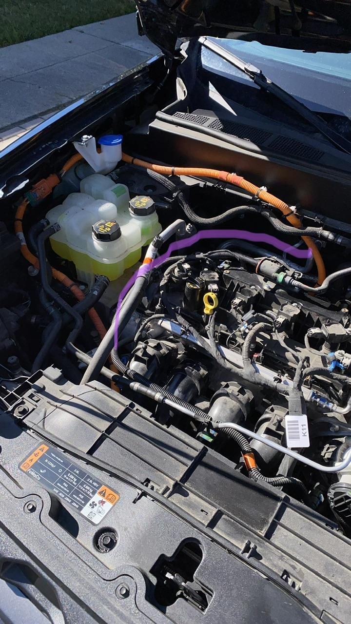

New theory:
Maybe it was SUPPOSED to be a tie down point for the HV Cable going to the electric air conditioner, but late into design, they found out it was unsafe to bend cables at that tight of a radius, or, the high voltage lines running too close parallel to the metallic air conditioner lines could induce a current into the lines. A sound potential problem. They left the bracket there because it was already made and it is multi purpose and holds other items lower down.
Ya gotta admit, the actual routing of the orange power cable for the air conditioner up and around the wiper fluid tank, around the coolant degas bottles, and up near the hood closer, and in an area much more prone to get hit with a tool by the home mechanic, seems a little "unrefined". Like a literal last minute design change. 🤷🏻‍♂️
Ford Maverick Another "What is this for?" IMG_8636
Like maybe early design, this:
Ford Maverick Another "What is this for?" IMG_8630

Ahh, so it has other uses. I was wondering why they would keep it, if it does absolutely nothing. I would think they wouldn’t bolt it on if it had absolutely no use.

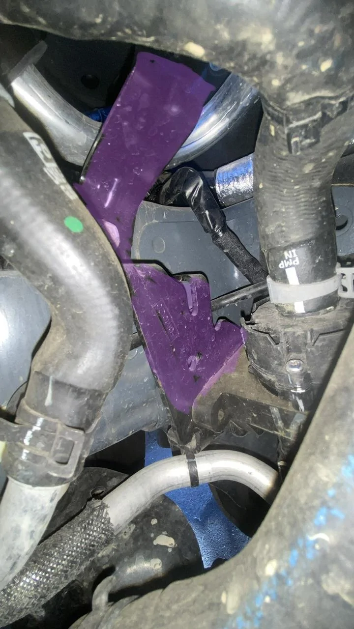

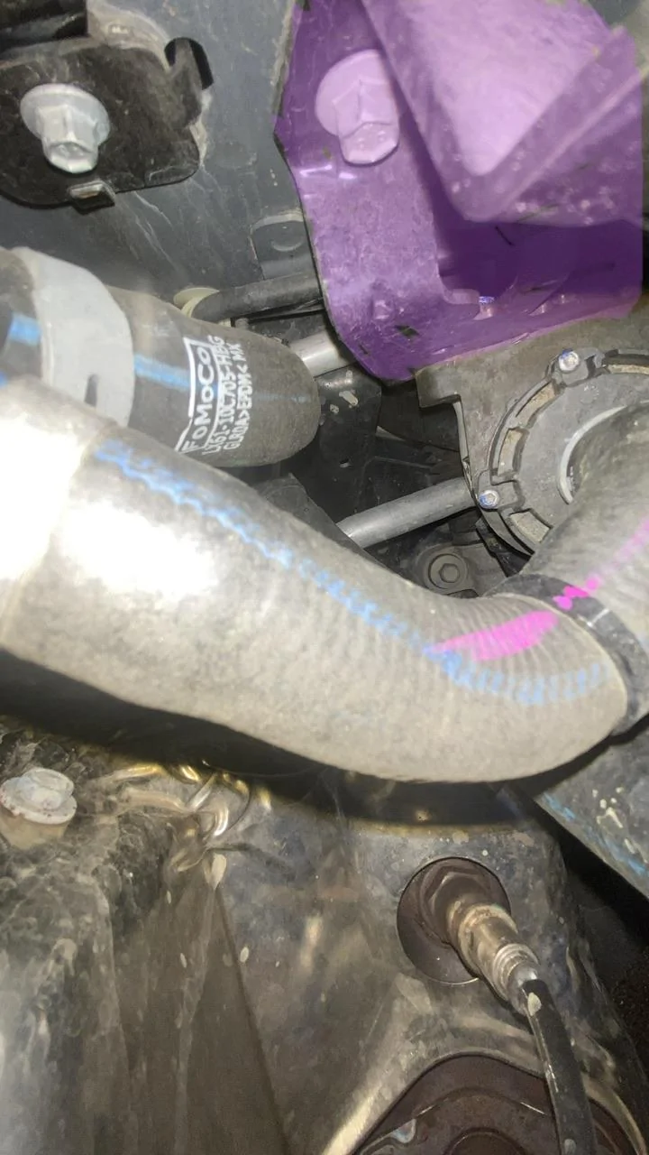

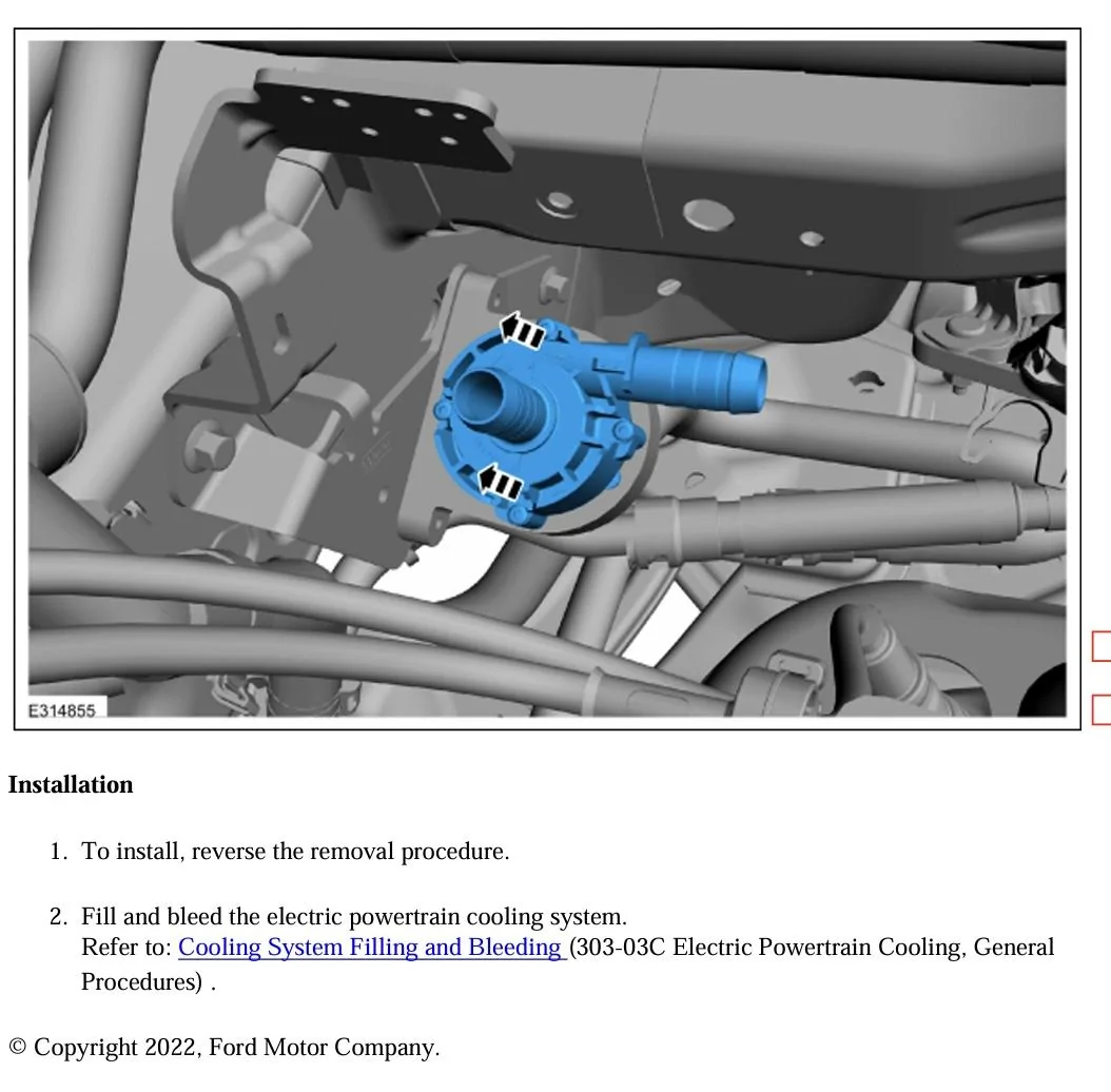

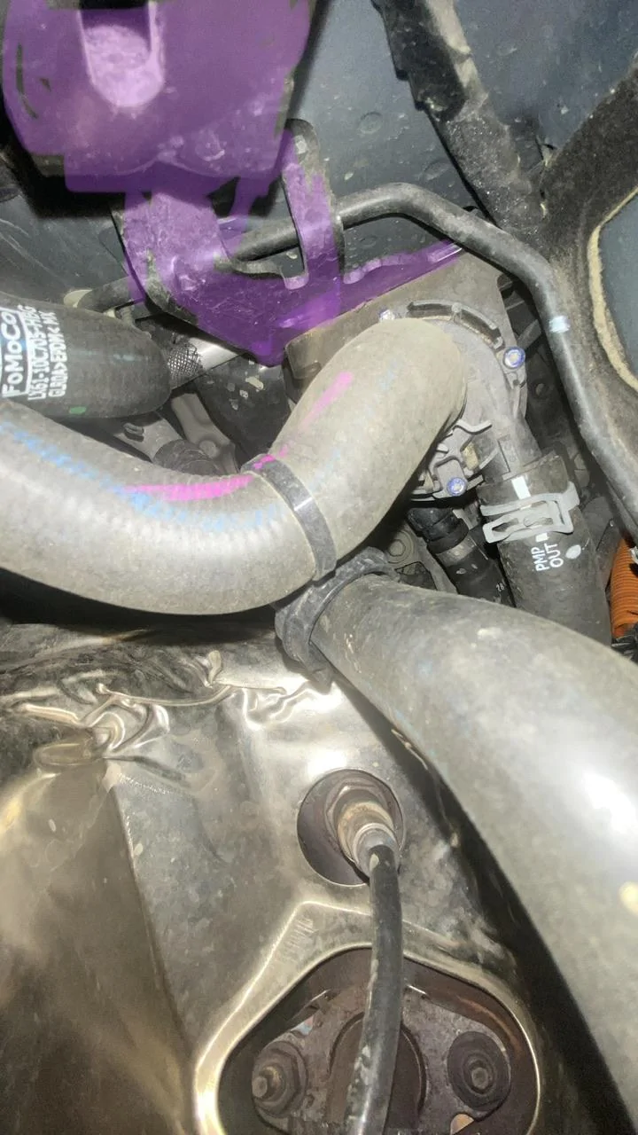

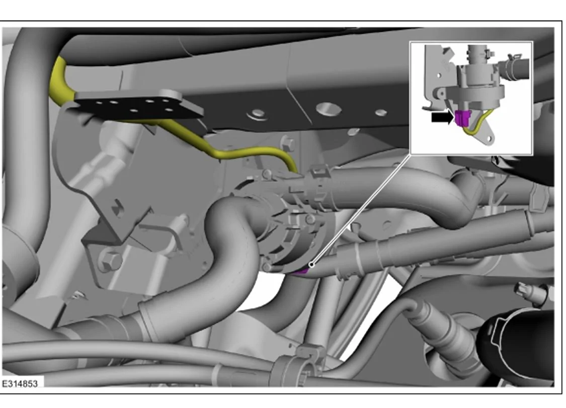

I found the bracket in the workshop manual and it is shown unused at the top.​
Down below, the same piece of metal is shown to mount the battery coolant pump.​
Quite a fancy piece of precision bent steel though only half-used.​

Aawww. You had to go and ruin all the fun of making things up!

Awww, you probably tell kids there ain't no Santa. :) Seriously, nice find.
