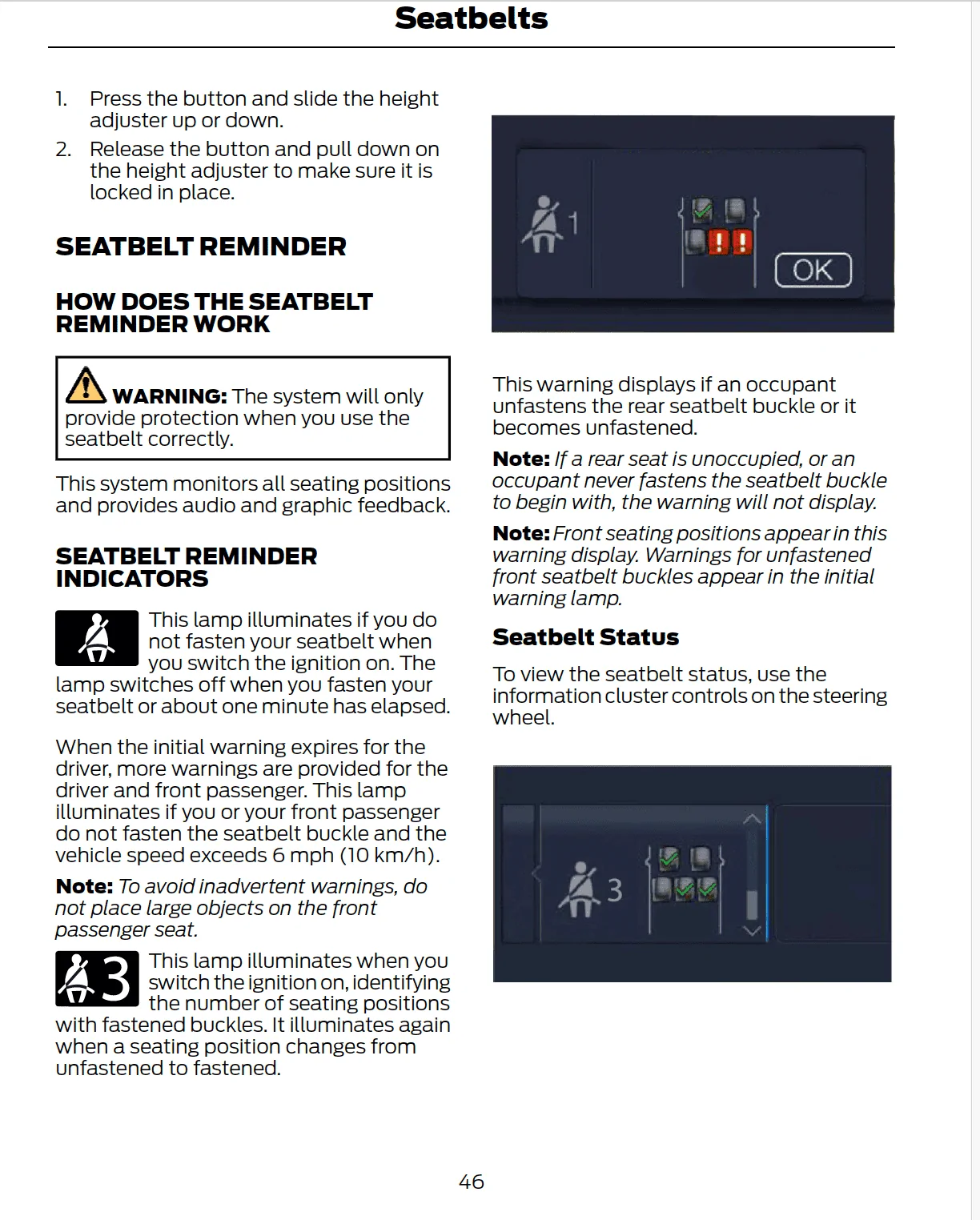

Press the menu button (right hand side of steering wheel). Use the arrows on your steering wheel to scroll down to Screen. Press ok. Scroll up and down and Press OK to decide which screens you want displayed. When you’re done press the back button and return to the displayed screen. Press up and down yo scroll between screens.
On my hybrid XL with the 4.2" screen, the number of screens in the list that you can choose from is very limited (4 choices) compared to the list shown in the manual for the 6.5" screen (13 choices). The seat belt screen does not appear to be among the 4.2" screen choices.

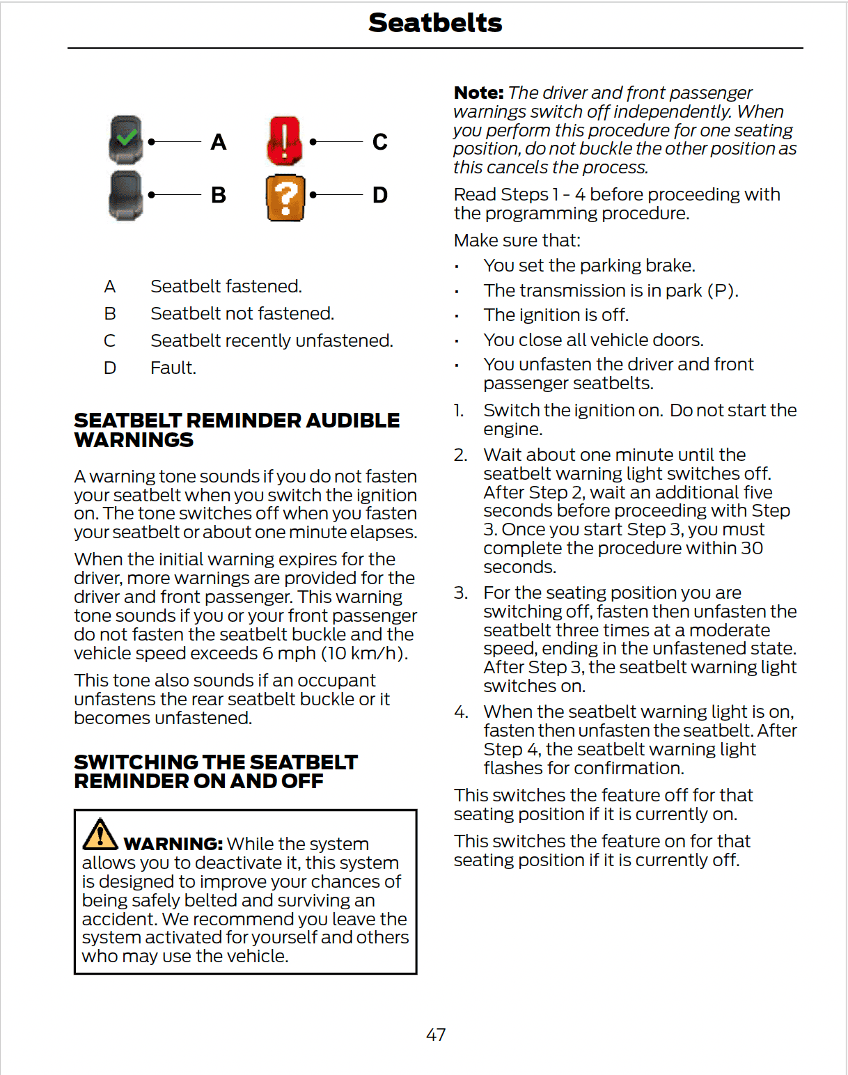

It's actually page 46-47 of the manual.
Great Post! I saw that in the owners manual when I got the truck a few months ago and I've been meaning to try it to see if it works. I'm going to to do that this week.

Yes it is a safety feature for the people that leave kids in back of vehicle. It basically tells which doors have been opened (unfortunately it shows when I put shopping in back seat too). I can't find way to get it turned off in dash options either. I think because they don't want people to turn it off. I just hit the OK button on steering wheel, not big deal. Now if they could put something in car that would stop people scrolling through their phones while driving, I would be all about that safety feature lol.
