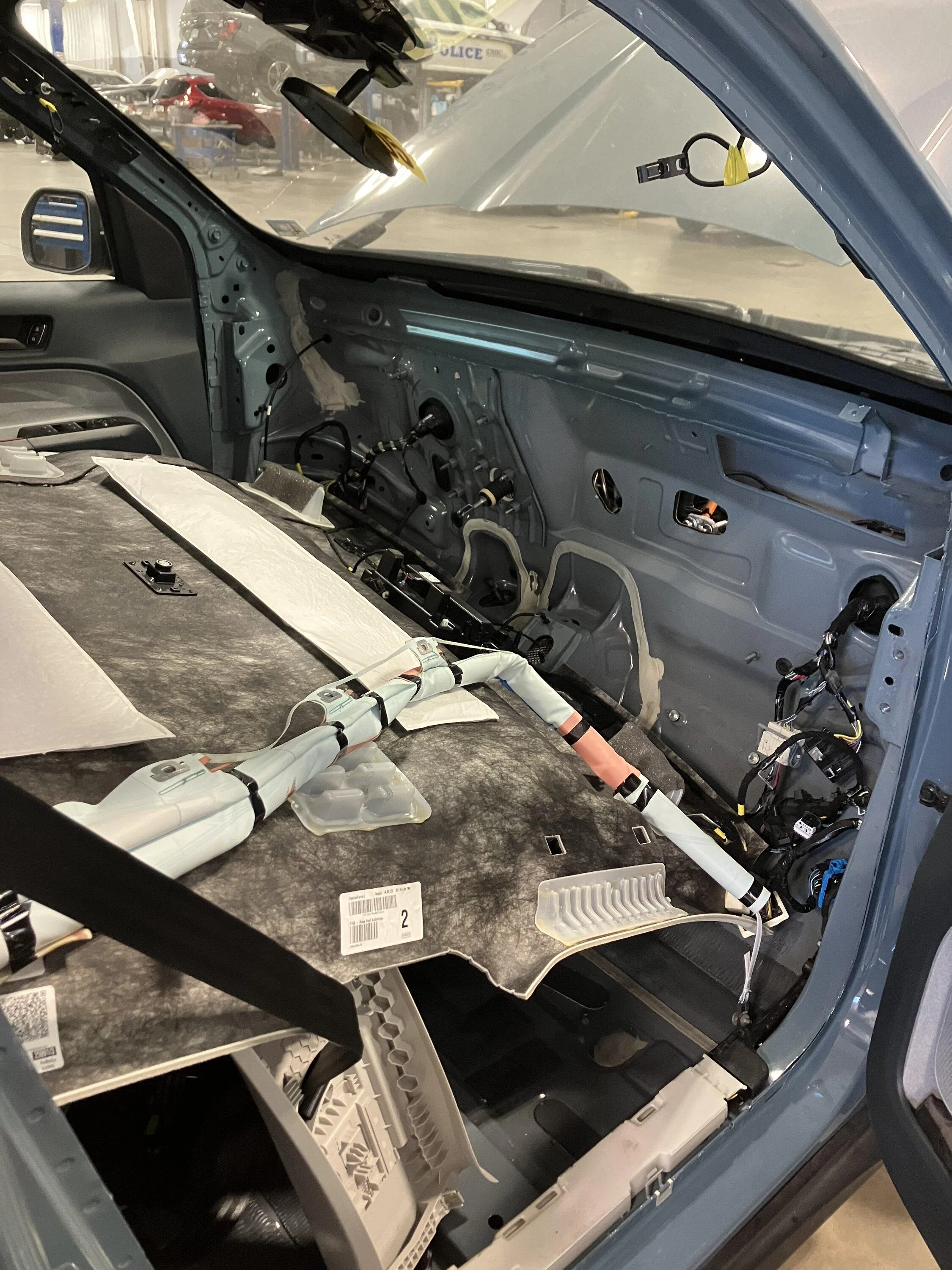

Update on my water leak issue. As I described previously, the dealer isolated the area of the leak after removing the outer and inner fenders, dash, front seats and numerous other misc parts. The leak was sealed and the wait began for the replacement carpet to correct the mold issue. After six weeks the carpet arrived but before putting things back together they noticed the dash had been scratched during removal and would need to be replaced. The dash is ordered and supposed to be the highest priority but there is no date from Ford as to when it will be available. Monday marks 8 weeks that my Mav has been at the dealer for the water issue and no end in sight. I have a loaner but I want my Mav. That’s what I’m making monthly payments on! Advice or sympathy is always
Ford Maverick Water leak in passenger side BC7E5F03-0496-4230-83E3-E46F2F3B659F
welcome šŸ¤—
I was able to visit my Mav today. This is a photo of it in its current state.

Wow, that is one major disassembly! Impressed they took on that job.
Can you point out where the leak they discovered and repaired was in the picture?

The said the leak was in the area circled in red. It was a seam that was not sealed during manufacturing. It wasn’t the door seal.
