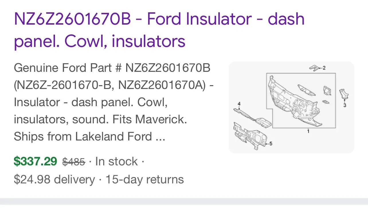

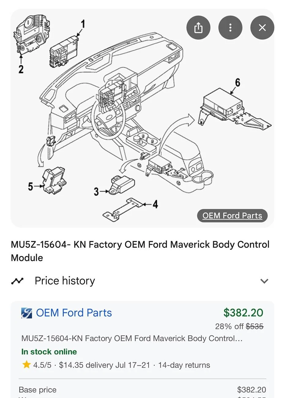

Service advisor said they pulled the cowl today and confirmed the leak was from the cowl into the AC fresh air intake and onto the cabin air filter. I previously verified that myself so they drew the same conclusion as me. Said they ordered a part to fix it... couldn't confirm if my truck was missing the part or if it was improperly installed/damaged. Will update again tomorrow.
Definitely improperly install from the factory. These two parts is what they told me has to replaced because of that leak and I am being quoted five grand because it’s out of warranty.
