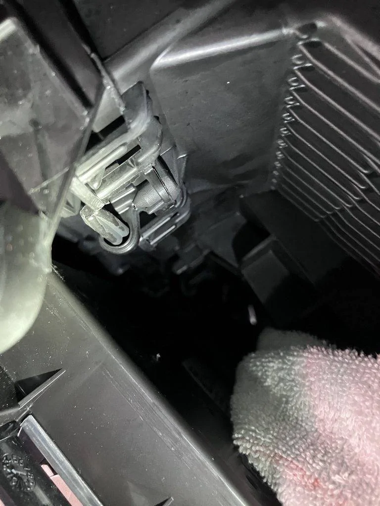

The past couple days, I've been seeing a drip coming from what appears to be a seam on what I'm guessing is the evaporator housing. I've included pictures to try and show what I'm talking about. I can also hear a "sloshing" sound coming from the passenger side when I make left turns. I don't see any water actually coming from the vents. I know that people have had issues with the windshield cowl, but mine appears to be fastened all the way across the windshield. Is it possible the piece under the cowl is the problem? Or is it possible I'm looking at a clogged evap drain? And the last possibility, could I have oversprayed water into the intake for the ac?
When dripping, the water seems to be coming from the seam visible in this picture. View from passenger side

Shot from driver side. Water seems to run into this guard then drip out.

Also possible that a drain is clogged; not too hard to investigate.

Well, when I checked the drain it was definitely clogged. Quite a bit of water came rushing out of it. I didn't really need anything to unclog the drain. I literally just touched it. Still, I slid a zip tie up there and spun it around in case there was something else trapped in there.
I ran the ac for a bit, and could definitely see the water dripping outside of the truck, but I still see an occasional drip from the same spots inside. It's nowhere near as bad as it was, but now I'm wondering if there's something going on with the drain line further up. Or maybe the rest of the water that was in places it wasn't supposed to be is just slowly working its way out.
